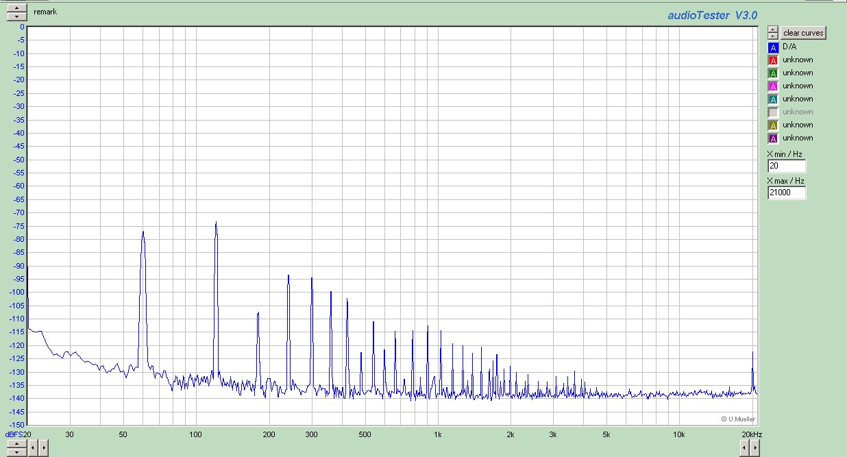

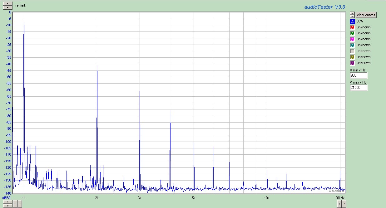

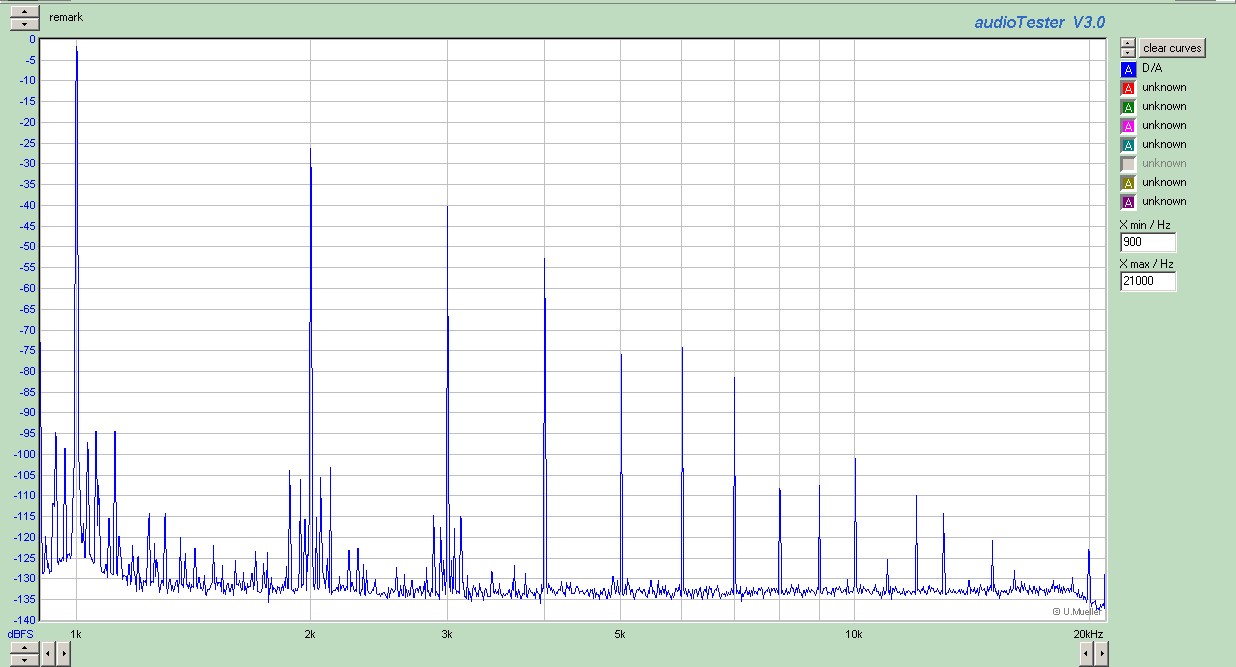

How about my 300B SE amp, at 1W, 5W, and noise floor. These are not perfect comparisons, it can be argued, but they are not totally subjective, either. Compare 300B SE to 300B PP. I have tried a few different output transformers, and the difference in FFT is minute at best, especially for the SE since it is quite full of harmonic distortion.
Depending on my mood, there are times when I prefer the SE over the PP, but by and large the PP wins the audible contest. For me, measured distortion generally confirms my audible preferences.
