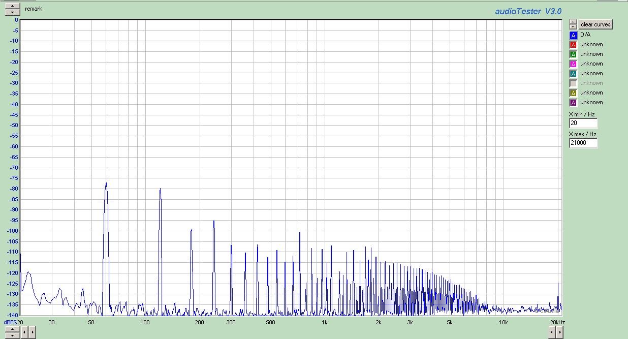

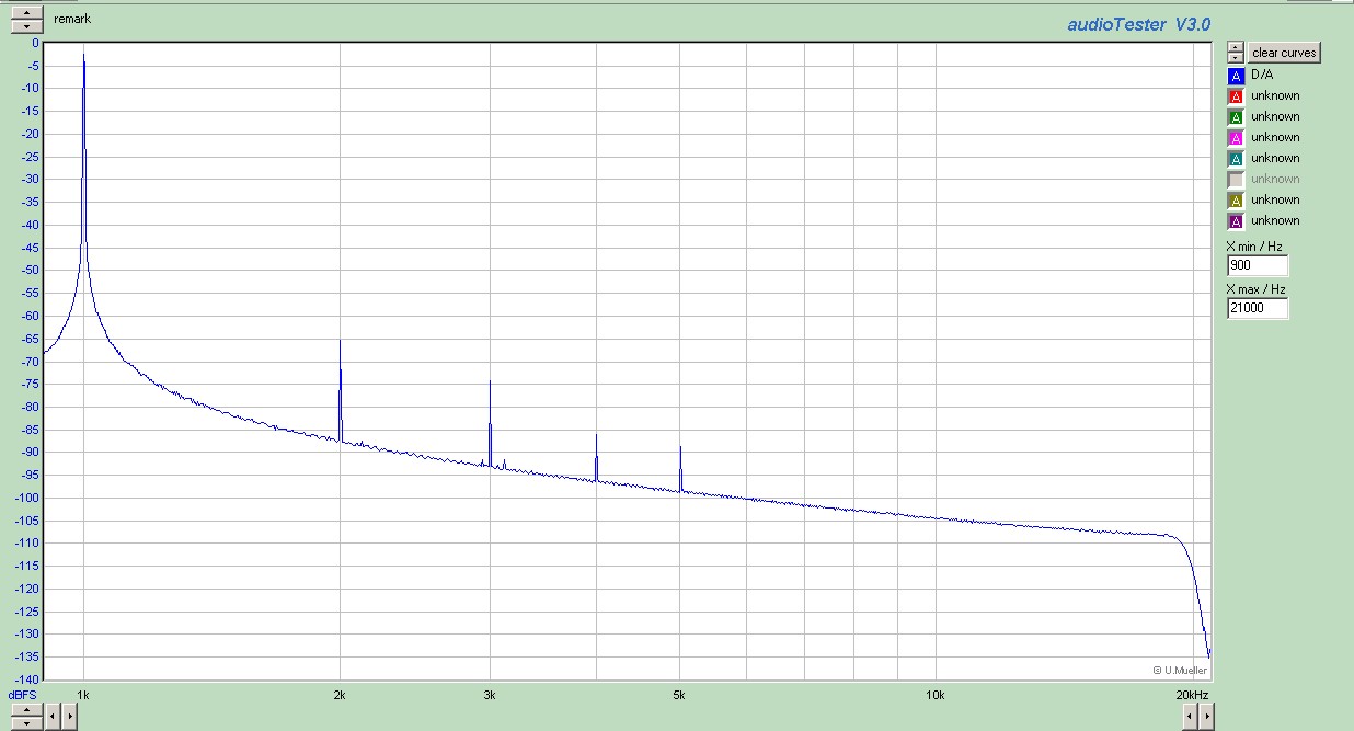

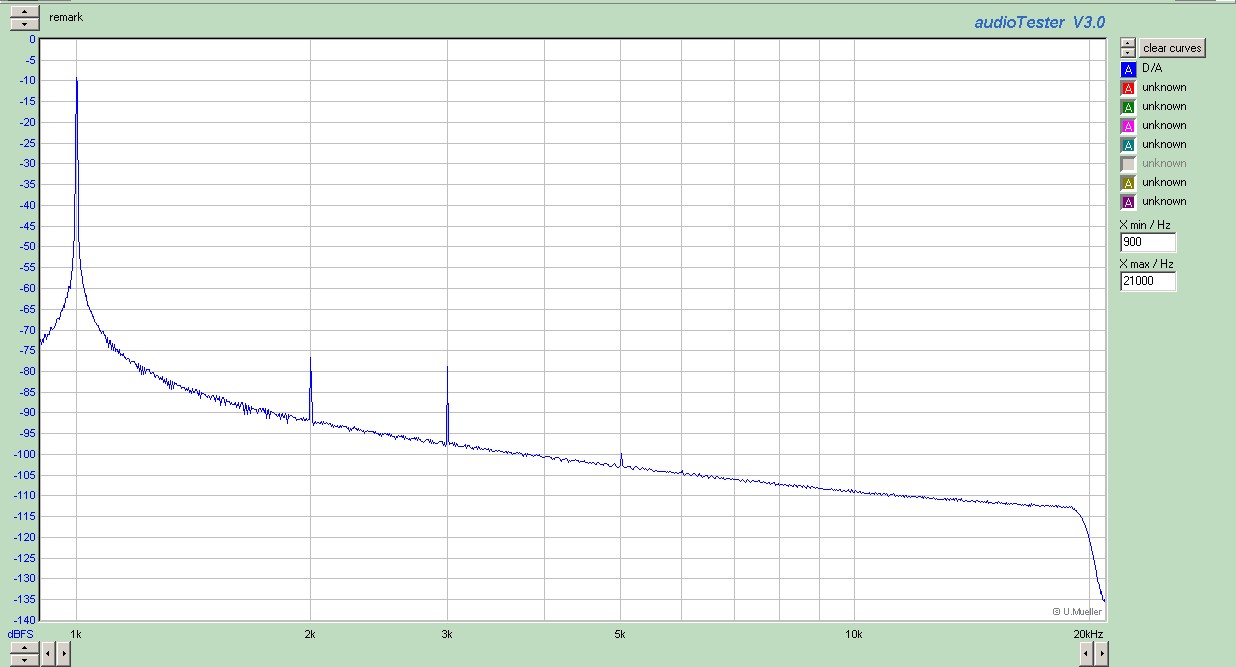

Or the 3 stage Karna, at 1W, 4W, and noise floor. Pretty impressive IMO. As noted, looks fairly similar to a SE, but with lower distortion.
