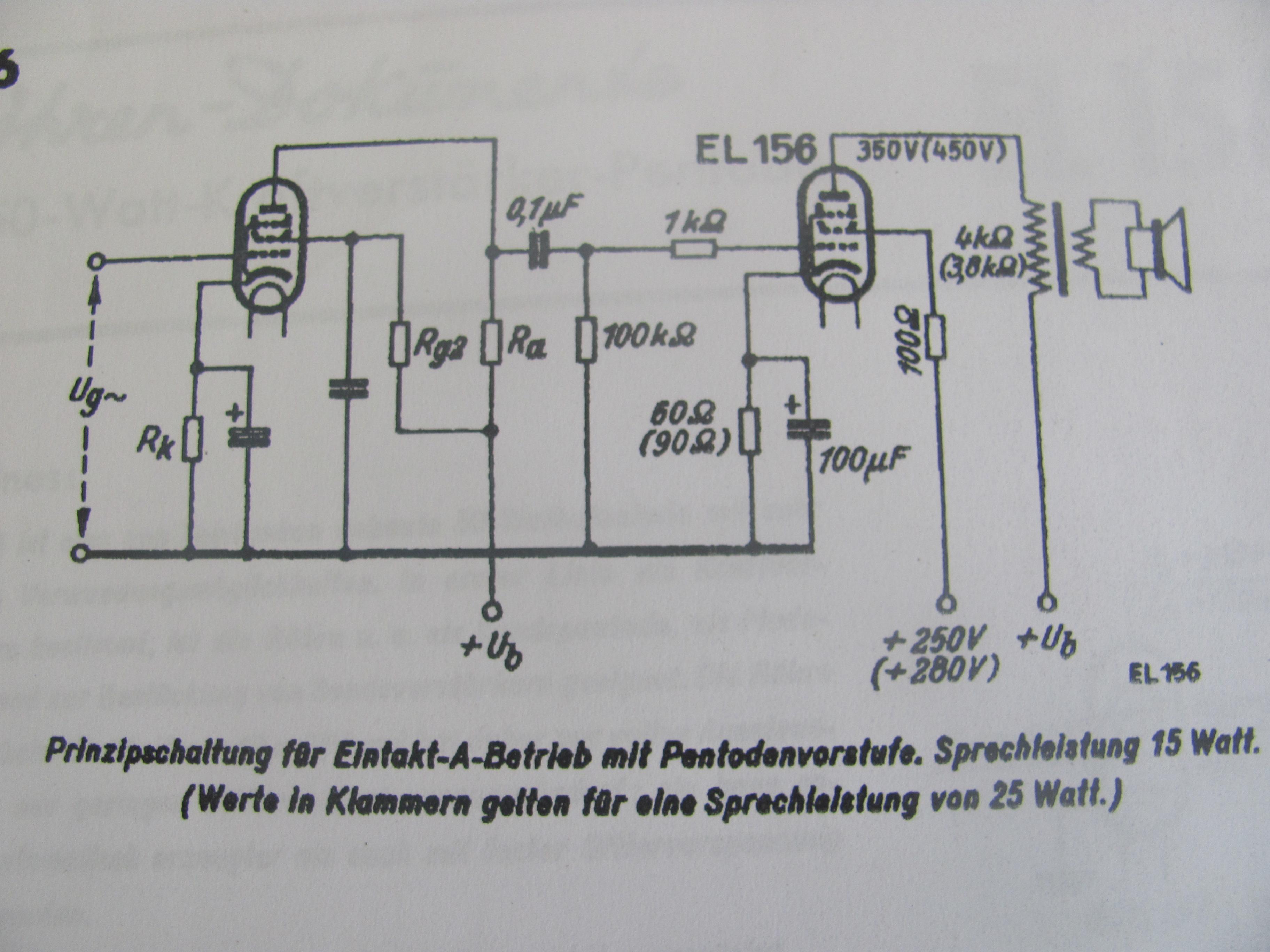

What do you think about this circuit ? i intend to build it as soon i have all the parts...can make it 15W with 350V supply or 25W with 450V supply, but telefunken says it has 9,5% distortion, i think at full power...the only thing i have is the tubes, i need all the other parts...

See this thread.
Hi EL156,
try this link: Volker Jeschkeit's Röhrenverstärker
One of the schemaics shows aEL156 SE-amp.
Its in german but the speach of the schematics is international🙂
Volkers circuits are allways fantastic.
Have Fun,
Hilmar
Have Fun,
Hilmar

Thanks for the link Hilmar53...it is very interesting

Thanks jazbo8...i wonder if Joshua_G has completed his Amp...anyway he said in the thread that he would publish the results...
