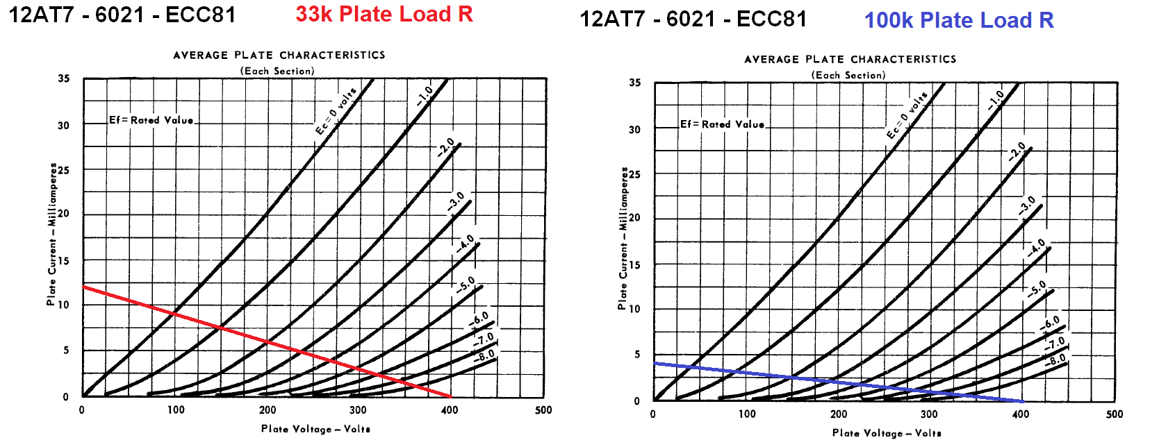

I've attached two load lines for a 12AT7 with a B+ of 400V.
The first one shows the 12AT7 with a 33k ohm plate load resistor.
The second one shows the 12AT7 with a 100k ohm plate load resistor.
Notice how the 33k load line is more vertical. That means the voltage swings less (horizontally) as the input signal is applied, which means lower gain.
Notice how the 100k load line is less vertical (more horizontal). That means the voltage swings more (horizontally) as the input signal is applied, which means higher gain.
The more vertical the load line, the lower the gain.
The less vertical (more horizontal) the load line, the higher the gain.
To get the very most voltage gain possible you can use a constant-current source as the plate load, which will make a completely horizontal load line (the same plate current at almost all plate voltages).

I think 47k for the 12AT7 plate load resistor is fine.
I think what you want to change is the NFB resistor, to reduce the gain of this amplifier (and lower its distortion, and increase its 'damping factor').
You may also want to put a DC blocking capacitor at the amp's input.

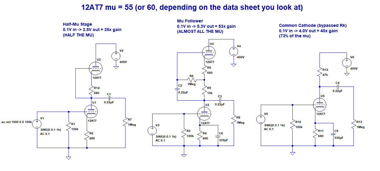

the plate load resistor determines your voltage gain...which will never exceed 1/2 of the triode mu...
That's not true.
I'd say you will never be able to exceed about 75% the data sheet rated mu.
There is a thing MerlinB calls the 'half-mu stage', which is basically a quasi-SRPP with the output signal taken off the plate of the bottom triode (instead of from the cathode of the top triode). That gives you... half the mu.
The first stage of Broskie's Aikido line stage is a half-mu stage.
That's not true.
he is using a plate load resistor, you are talking about mu followers, i merely posted the consequence of the plate load resistor based on what the OP said...
sheeit, I'm just a tube noob who tried to copy a DIY design to make my own. Building the same amp with 80v more on the b+ made an amp with a very temperamental input, and I wanna know why. but y'all are giving me loads of good info.
Half-Mu Stage gives you half the mu.
Common Cathode (bypassed Rk) can give you 75% of the mu.
Mu-Follower gives you almost all the mu.
(Ayumi model used)
