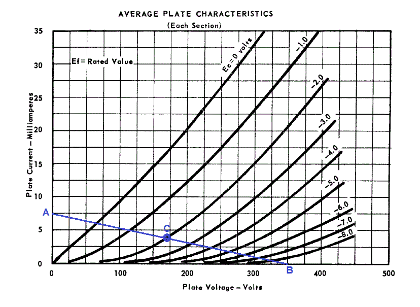

You have to calculate how much current will go through any decoupling resistor (in series with the voltage), which will tell you how many volts will be burned off by that resistor.
If I understand you correctly, you're asking if you should add another RC decoupling stage in the 12AT7 plate supply? If so, no, because Ohm's Law tells us that current through a resistor will decrease both the current and voltage to the plate supply of the 12AT7.
The plate current (Ip) the 12AT7 draws will pull current through the additional 22k ohm resistor, so voltage will be dropped across that resistor.
The reduction of voltage to the 12AT7 plate will reduce Ip in the 12AT7.
You have 570 ohms in the 12AT7 cathode, for the cathode bias. With let's say 2mA Ip, you'll be back to only 1.14V at the cathode, and the 12AT7 may be back in grid current territory.
You want more plate voltage to the 12AT7, not less.

I've just installed a 47u cap and 2.7Kohm, let's throw the switch....looks like I'm just kissing 189v at the plates, 354v at the supply cap, 2.05v at the bias. Gonna try that 2.2Kohm.
B+ = 354V
Vp = 189V
Vk = 2.05V
Rp = 47k
So...
354V - 189V = 165V
165V/47000R = 0.00351A (3.5mA)
2.05V/570R = 0.0036A (3.6mA -- probably due to another 100uA from the NFB)
Looks OK to me. You should be able to swing 50V peak reasonably cleanly. That gives you some headroom for the NFB, but not gobs of it.
