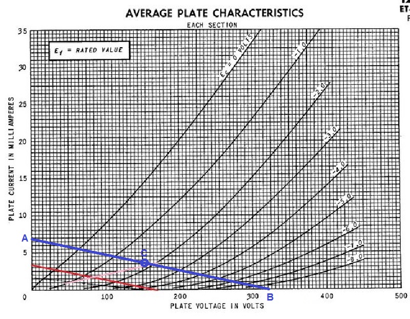

Yes, the goal is to stop the crunch from the 834, but as I haven't been able to recreate that crunch when getting audio signal from any other source, I'm realizing the problem may lie with the 834, not the amp.
I'm also eager to learn more about tube amp design, wondering if I have this driver tube set at the ideal operating point, trying to figure out how to get that information from the tube charts, etc etc.
Again, what is the goal here? What are you defining as "the ideal operating point"? What does "ideal" mean to you? Is there even an ideal operating point at all? (Actually, there is only the best compromise between this and that. There is no true 'ideal'. My opinion, of course.)
Step 1) Define your goals. (Low distortion? Quiet operation? Full power from the amp at volume control set at 75% up? ???)
Step 2) Figure out what you need to do in order to attain those goals.
Step 3) Do it.
