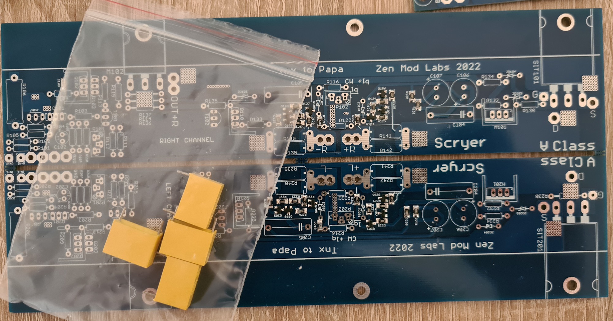

Cool. With a second 300VAC donut and some good PSUs, I think this might be the one for the artisanal Italian monoblock chasses sitting unopened in my garage. Not sure how to mount the PCBs to a UMS heatsink though, it looks like they have only the one mounting hole separate from where the MOSFET and SIT would mount.yes

OmniMightySantaZenMod sent me my Scryer 😍
What a day
What a day
