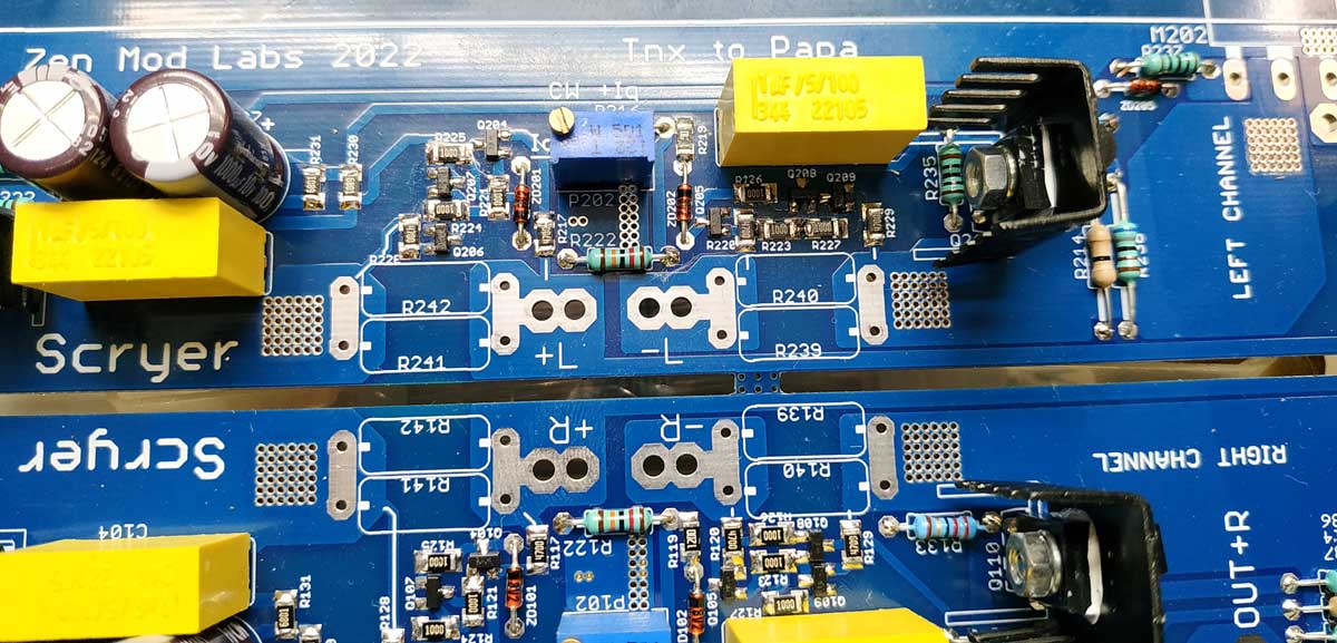

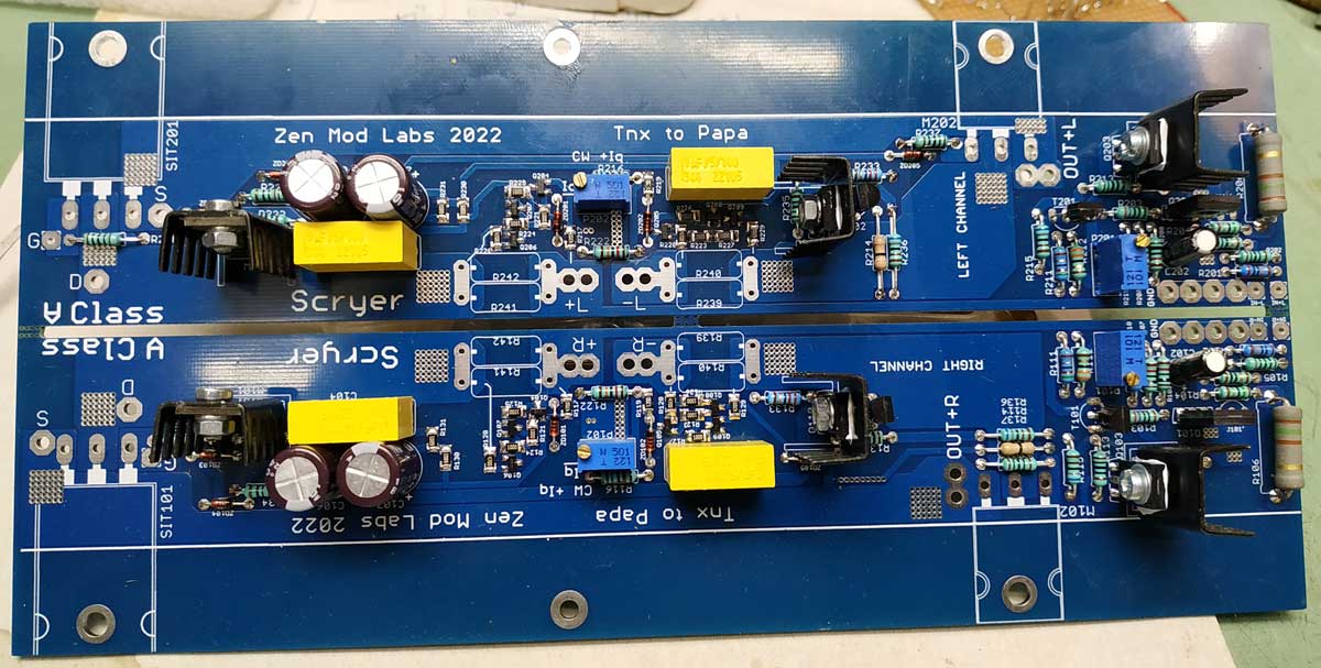

damnit, ANOTHER!! I barely have time to enjoy the one(s) I just built, before the urge to build the latest kicks in
That THD![]()
Those distortion spectrums look so pretty...
BTW, any idea what may be causing that spike at 6.5K for the 1W measurements?
some glitch in my cables, leading from EMU1212 to interface box, same as nasty looking peak at 20KHz

Any particular reason for the +/-23VDC power supply? Intentionally backed off a bit from 24-25? Also, would ACP+ have enough cojones to drive this one (2087C variety)?
@von Ah
rail - anything you read between 22Vdc and 25Vdc is nominally 24Vdc
simple - Pa is always showing 24Vdc as result of having 18Vac secondaries
in realm of small A Class amps, with common used diode bridges and filtering, in most case that's ending as 22V5 to 23Vdc rail, sorta 1.25 multiplication factor, when going to compute AC to DC
Donut on my T-Bed is having slightly more than 18Vac per secondary, thus the difference ...... irrelevant in entire story

I like this kind of distribution of harmonics too. What about the output impedance? Is it lower than 0R2 like F8?
can be done with sony vfet?
not so practical reworking it for Sony; highish Ugs is complicating things, and Sony is Weakling comparing to Tokins - think effective part resistance and xconductance
I didn't bother to measure that
FOMO is real, especially when in the process of building a SissySIT lol.
But, I spose these are two very different sounding amps based on the THD. Sissy still being the sweetest sand amp? Scryer looks to be much more tidy. 🙂

This is looking great. I will likely be waving my hands emphatically whenever Scryer boards are available.
