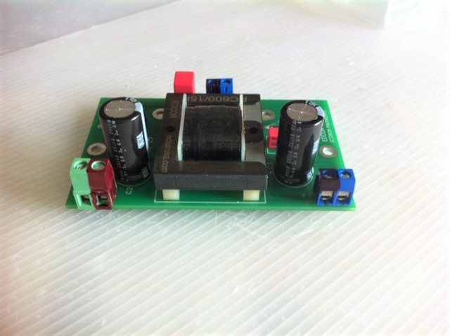

Presto, you can now roll your own VFET front end cards a lot more easily. Based on his early and enthusiastic campaigning for a vacuum tube Front End card, I imagine that member mbrennwa might be one candidate to head such an effort.
And might I suggest a dual footprint for Edcor PC series and Jensen JT-123-FLPCH?

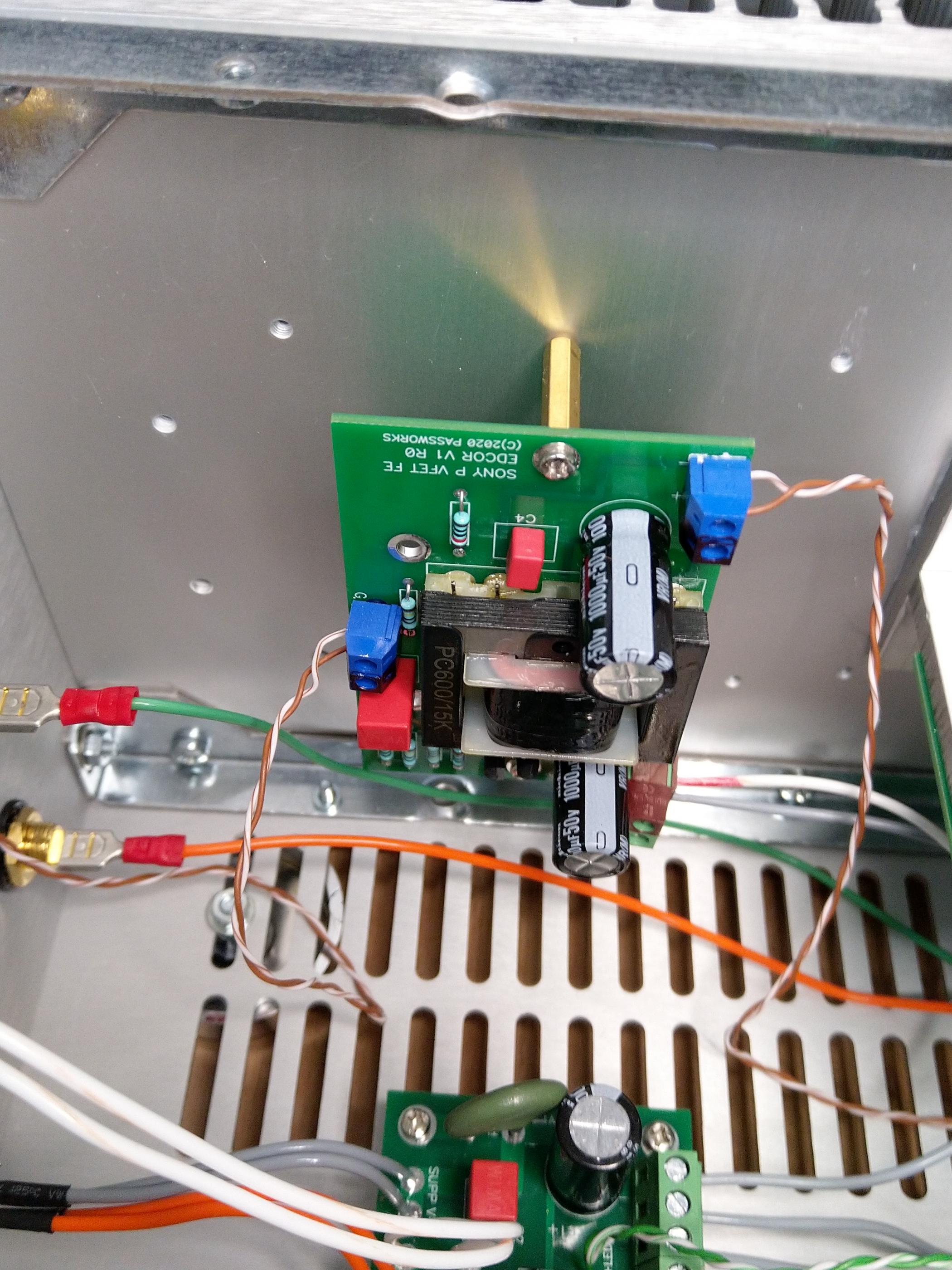

Well... attached is what I posted 4 months ago re FE installation, and of course what I did. I was worried about the negative sonic impact of connectors in the signal path, but that proved exagerated.
As one can see, I can easily install any FE board within a few minutes without having even to remove the VFET amp. I just need a small screw driver for this (and an allen key for the top plate screws). The very detailled process is:
1- Switch off the VFET amp (obviously!)
2- Unscrew the 4 screws holding the top plate to remove the latter
3- Unscrew at the 3 FE connectors the screws to release the signal and PS wires
4- Unscrew the 2 screws holding the FE board on its mounts to remove it
5- Reverse operation to install a FE board
6 - Do the same for the other channel
7- Switch on the VFET amp (obviously!)
This is done in matter of minutes from the top of the amp and enables quick comparisons. To do it quickly and foolproof even in suboptimal evening form, I used blue connectors for the signal wires and big green ones for the PS wires. On top, I marked the "+" of each connector RED.

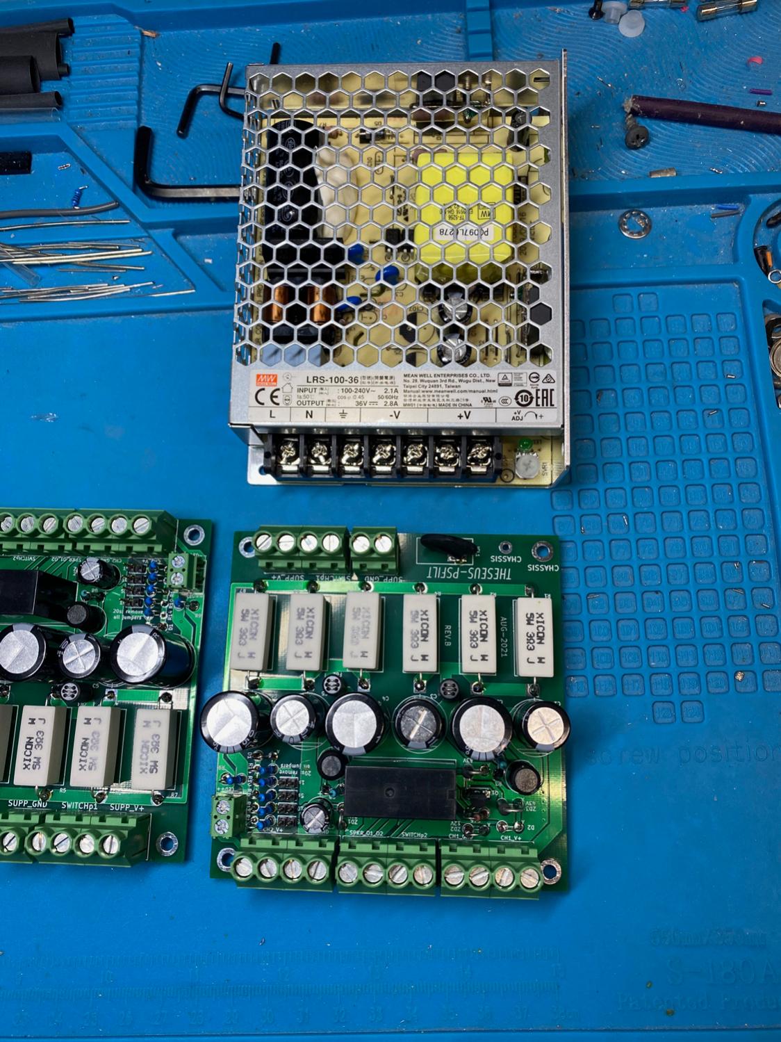

My box showed up last night. Very very well packaged thank you very much I do appreciate it. Hope to begin working on them before the end of the month.
I am declaring my Scourge builds a success. With some very modest tweaks to capacitors and sufficient run-in time over a few days, they are a pleasure to listen to. As I mention in my review over in the VFET builders thread, the cards have reached a state where I really don't want to tweak them any further. In some ways they sound similar to my Aleph J, another build which I love, and has remained untouched since it was completed.
This leaves me with a small quandary; I originally had plans to try a more extensive modification inspired by the Moffet Field version of the M2x FE cards. This needs to remain on hold, as I would rather not disturb the state of the Scourge boards as they are. Perhaps another intrepid amp builder might pick this up and run with it. The seeds for this idea may be found at The diyAudio First Watt M2x

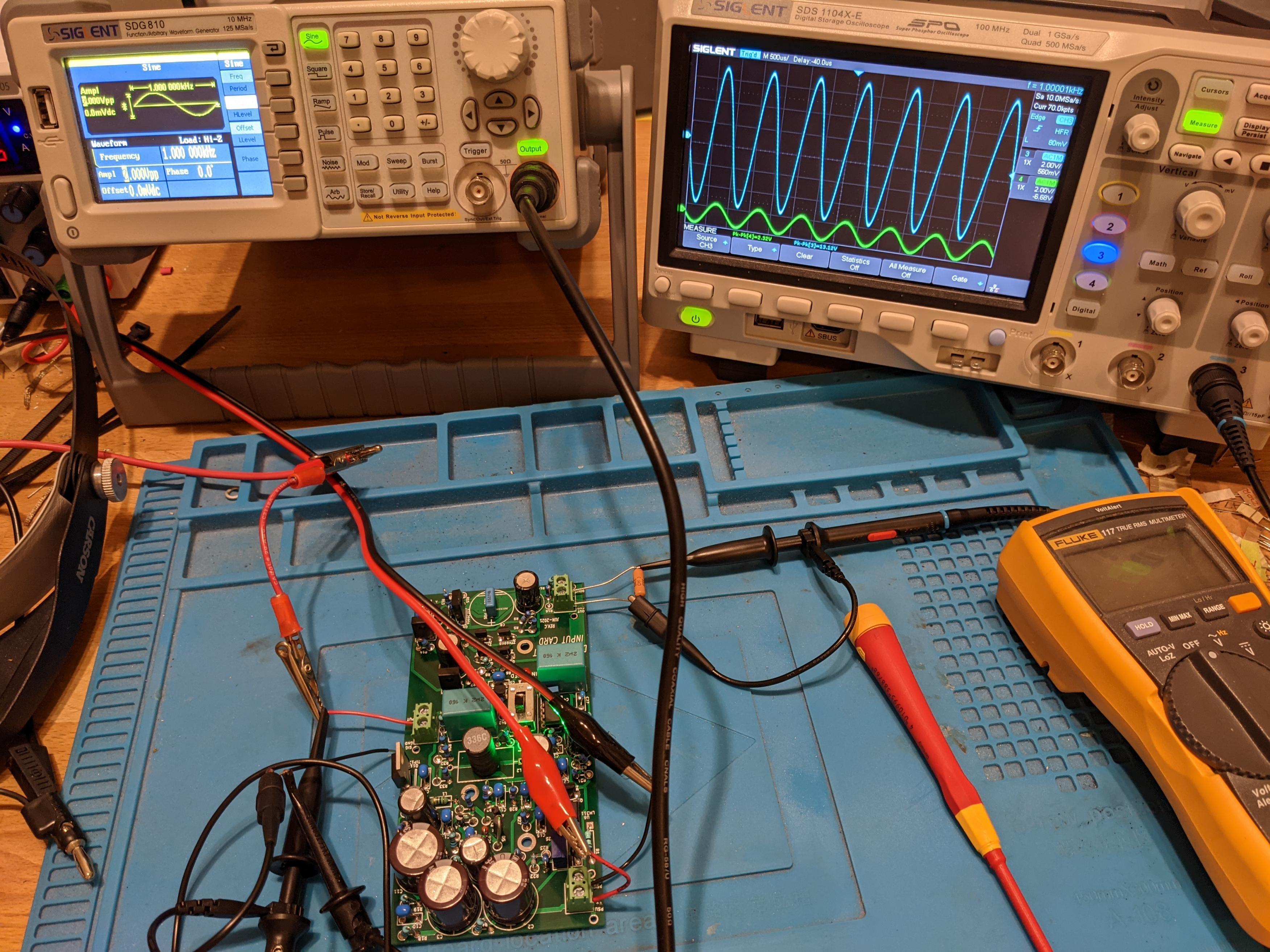

They're WORKING!
Finished stuffing all 4 pairs of boards this week and today mustered the bravery to fire them up. And all four pairs worked - Scourge, Bulwark, Marauder and Dreadnought.
Here's pic of a Dreadnought board under test. Green trace at bottom shows input of 1K sinewave at 2Vp-p. Top blue trace shows output of 13+ Vp-p into a 120K load resistor. And the phase inverter switches work too! Awesomeness.
Haven't listened to them yet. Still need to build the PSUs and figure out how I'll configure them as a preamp for use with yet to be built BIG MOFOs.
