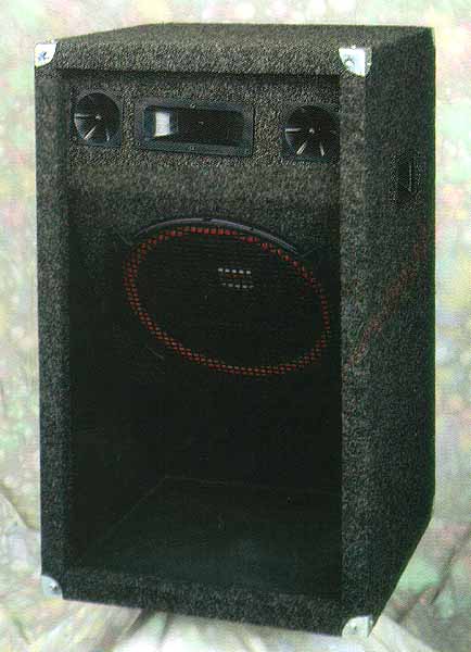

I saw in disco that they have some type of woofer's that are small ... and .. it shake you like hell ..
They are some type of horn's i guess .. they have the driver in the front and it's not pointing straight , a little to the ground .
I don't know what type of cab's are those but ... i know that it shake all the disco to death .. there are only 2 bass cab's .. so ..
I attach a photo with a design that i think it match the one in Twice Disco ( Romania ) . The one in twice do not have the HF driver's and i think it's a 15 inch or 18 inch one .
Have any idee where to find the plan of those cab's ??
THANKS !
- Scoops ? Horns ? Sub's ? WHAT!!?!?!
