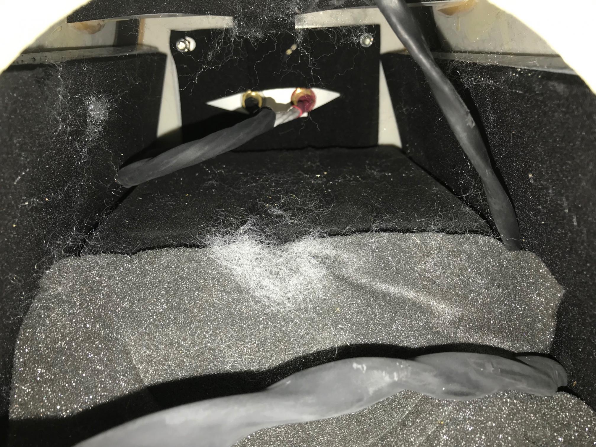

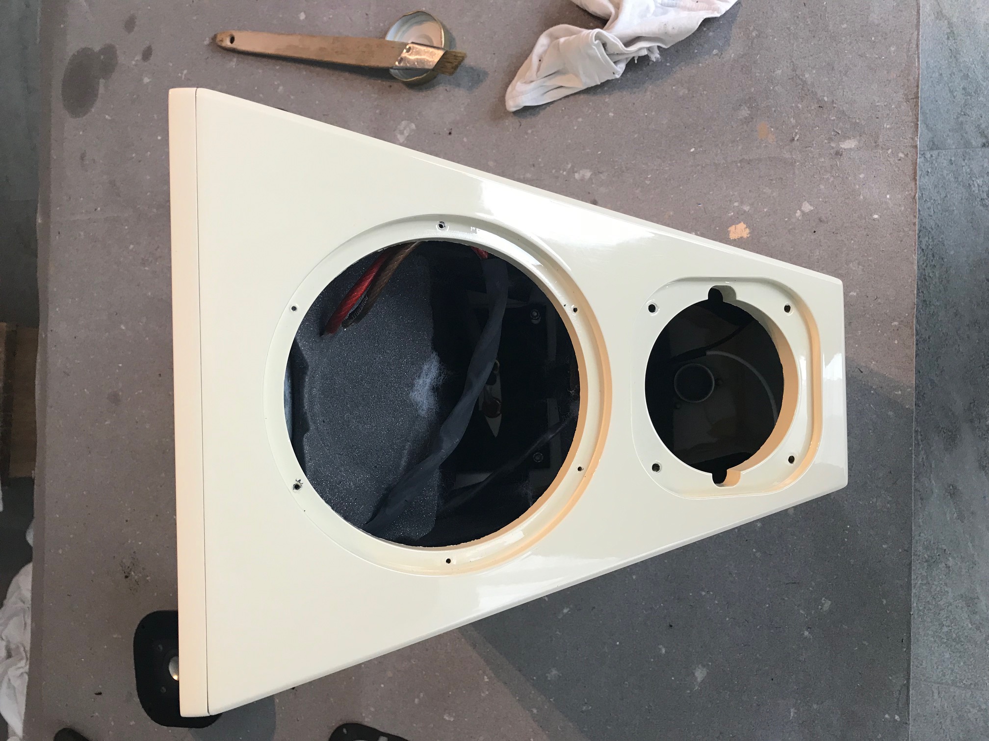

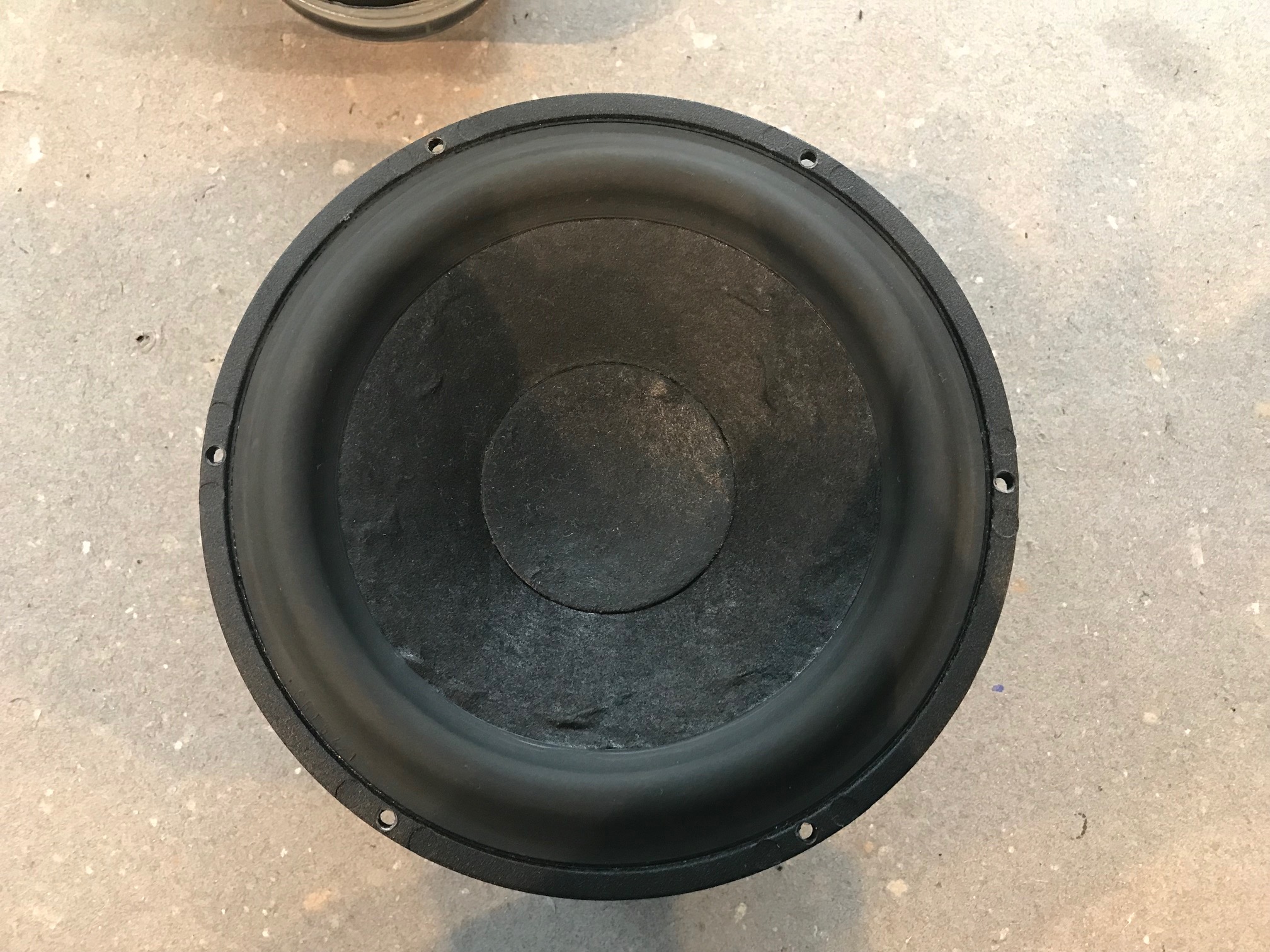

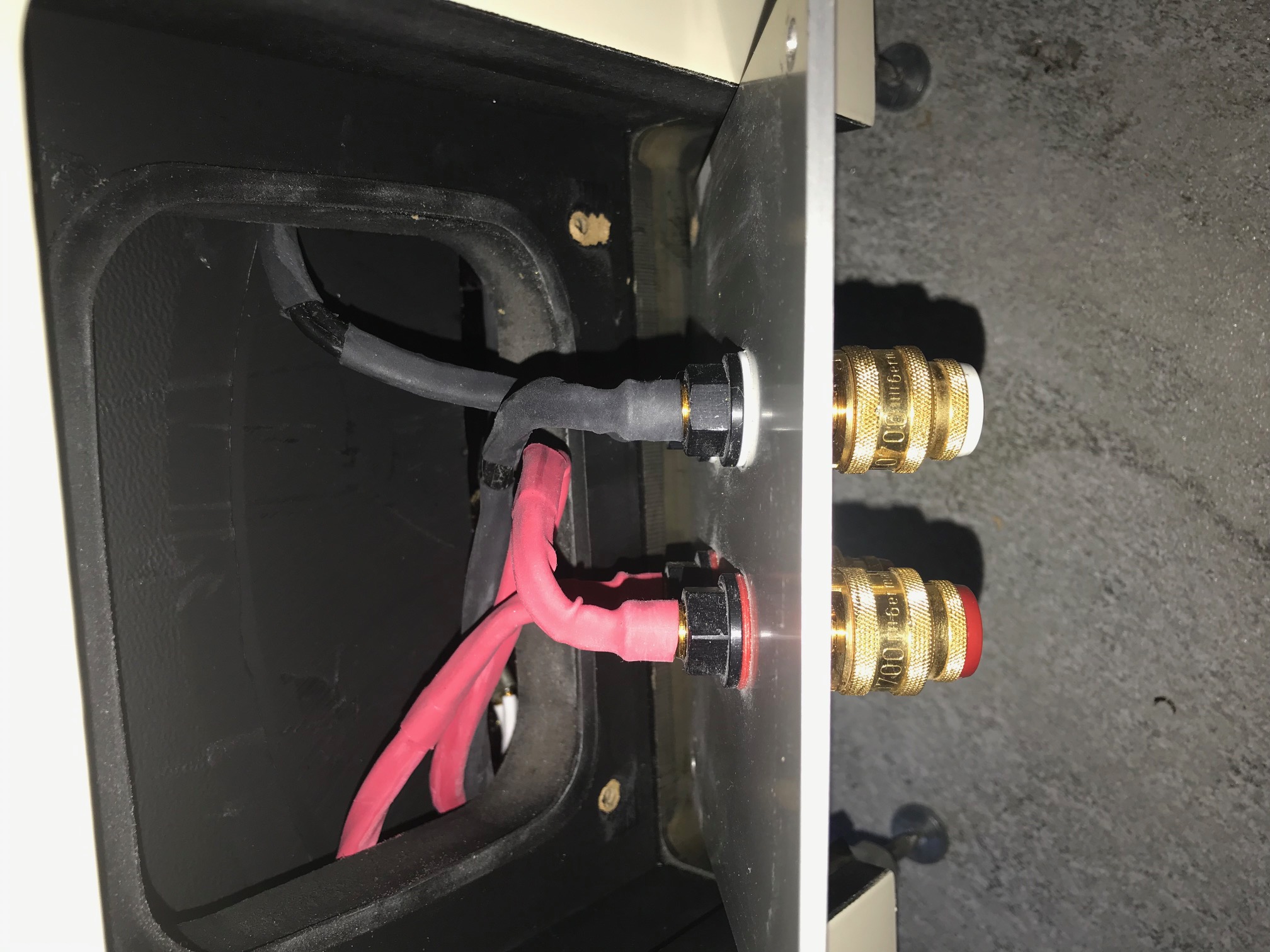

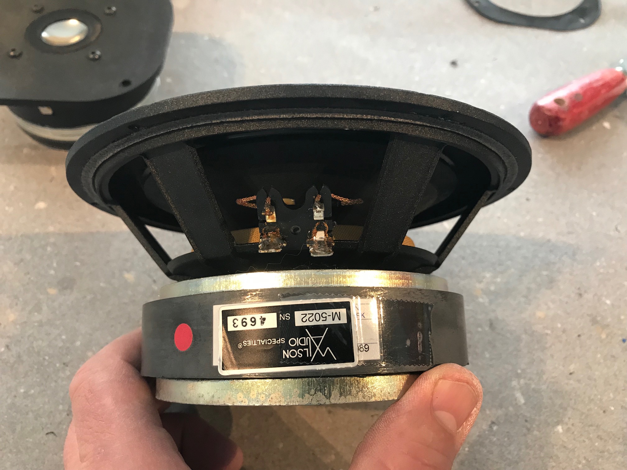

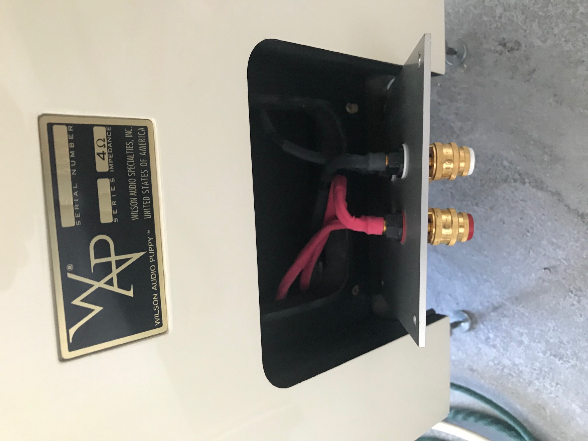

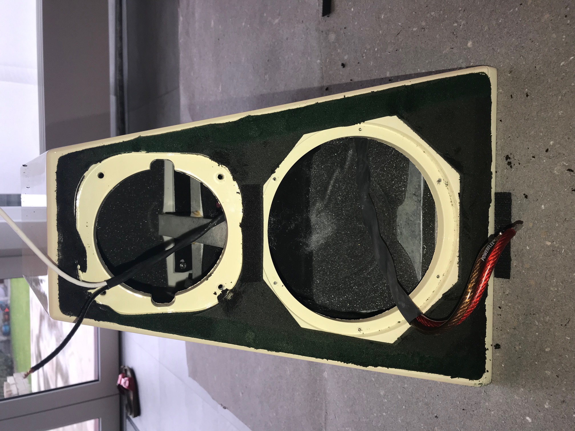

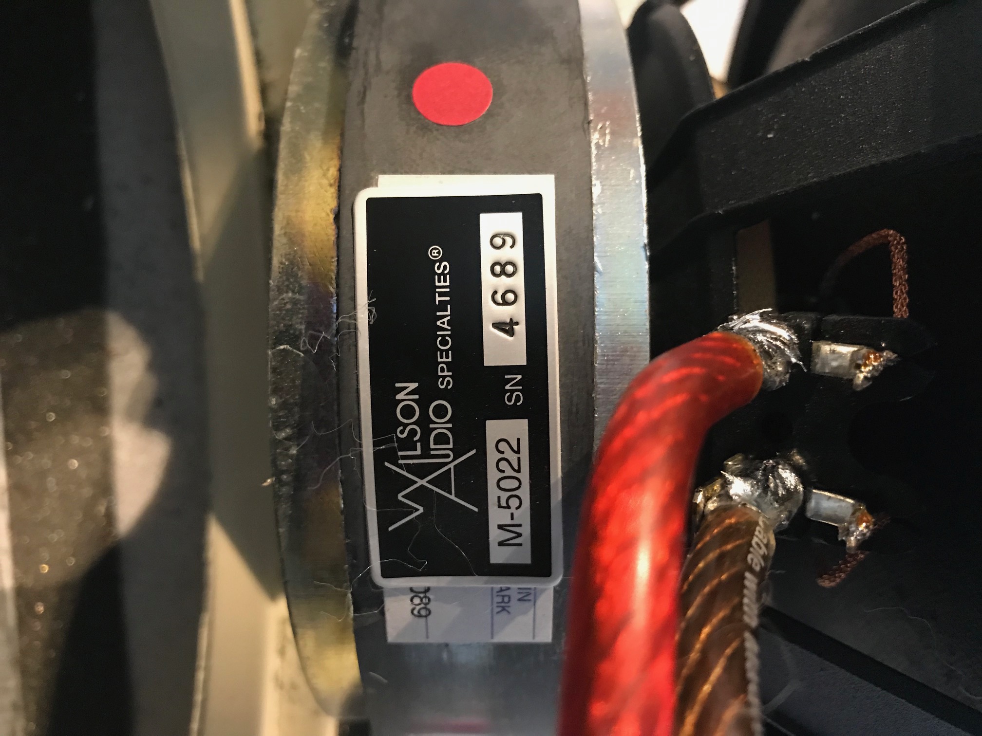

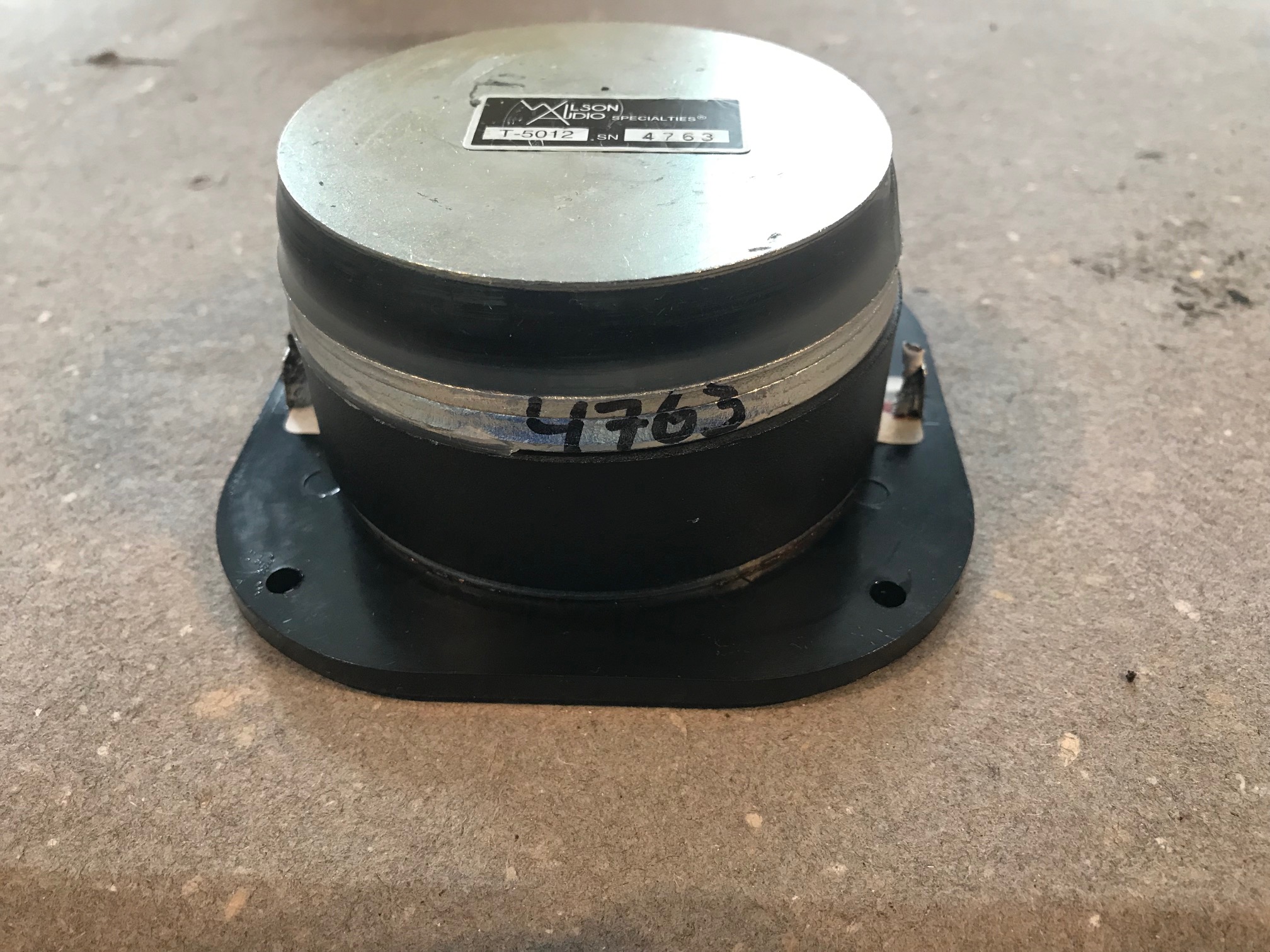

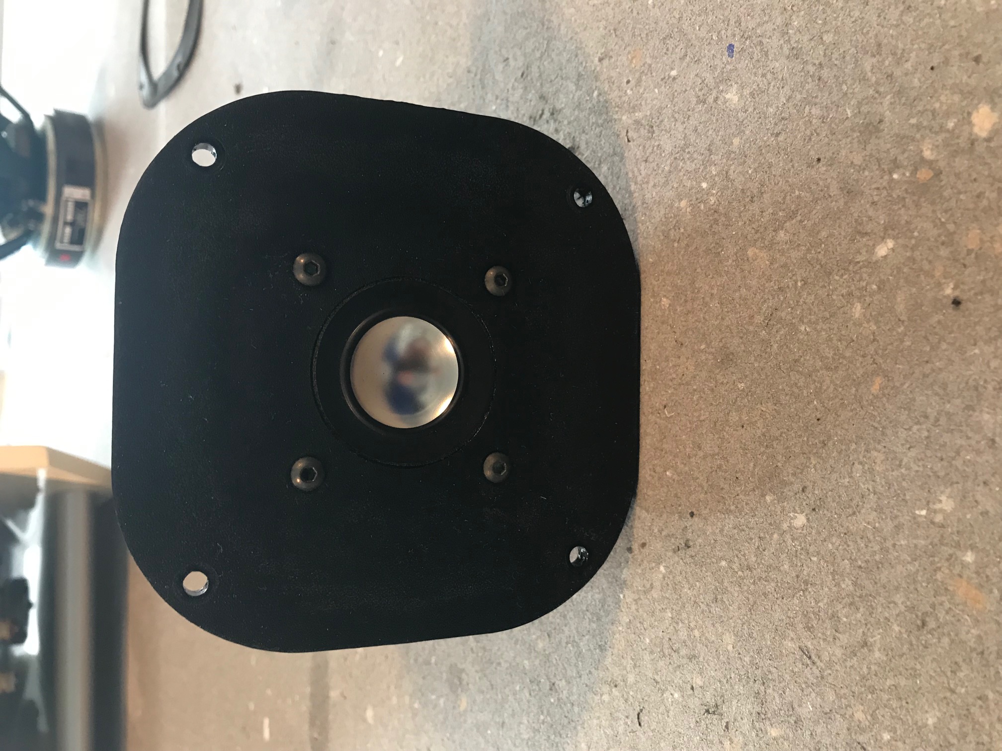

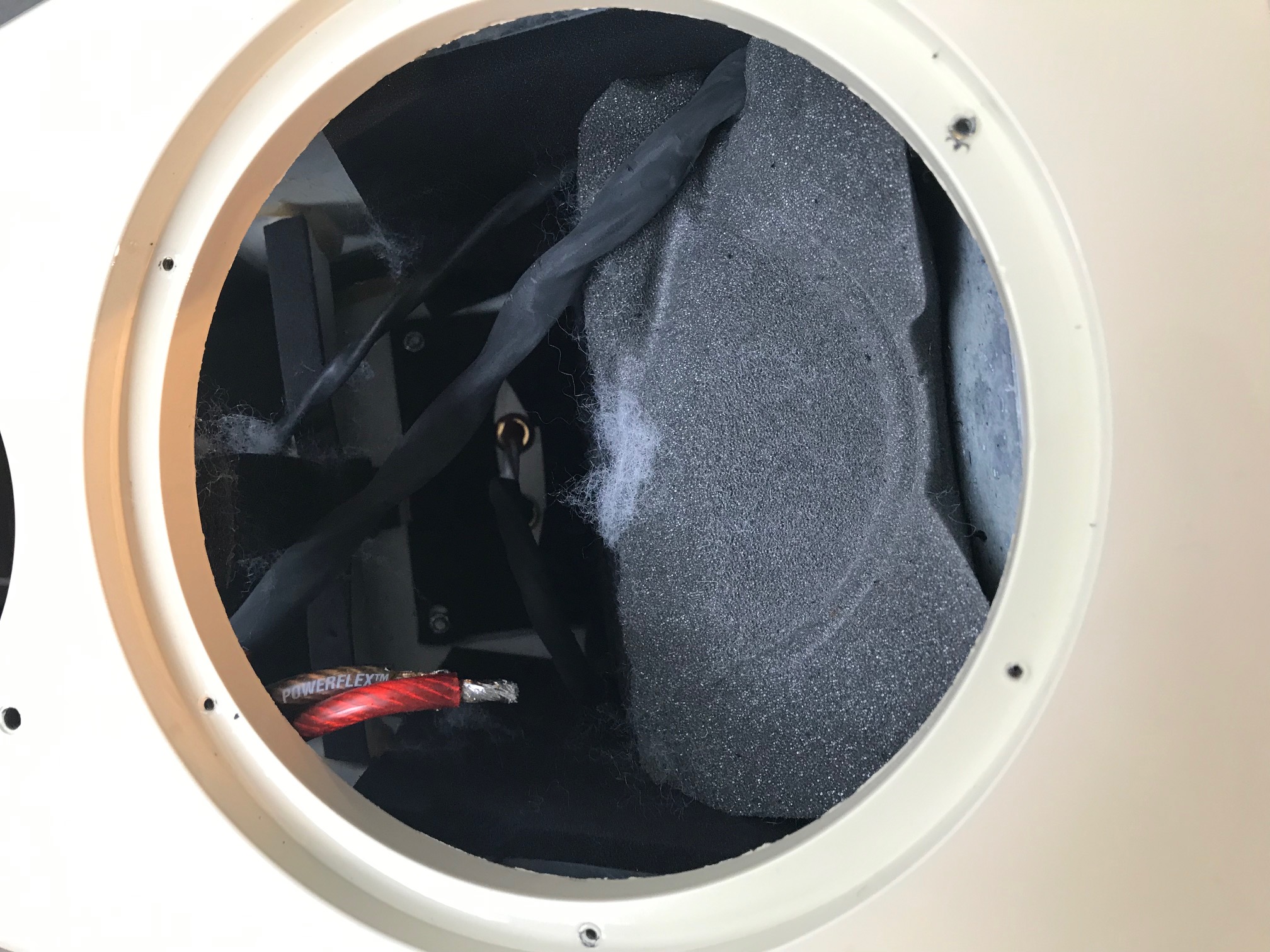

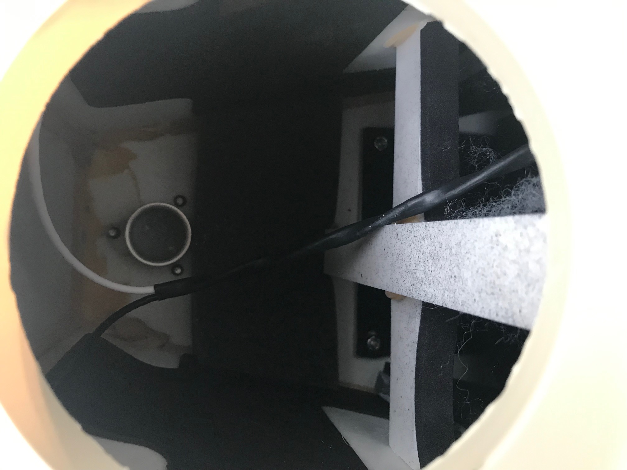

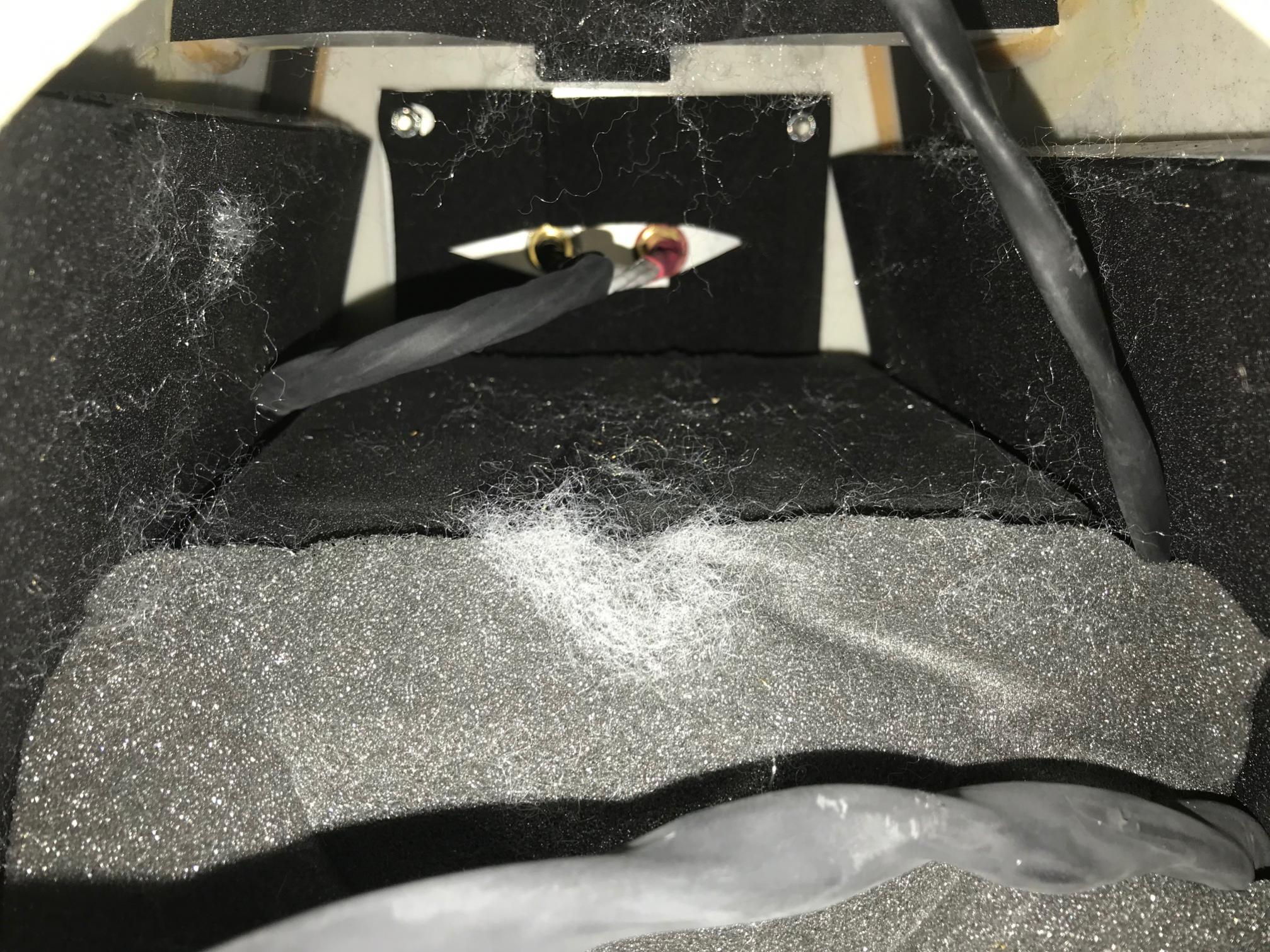

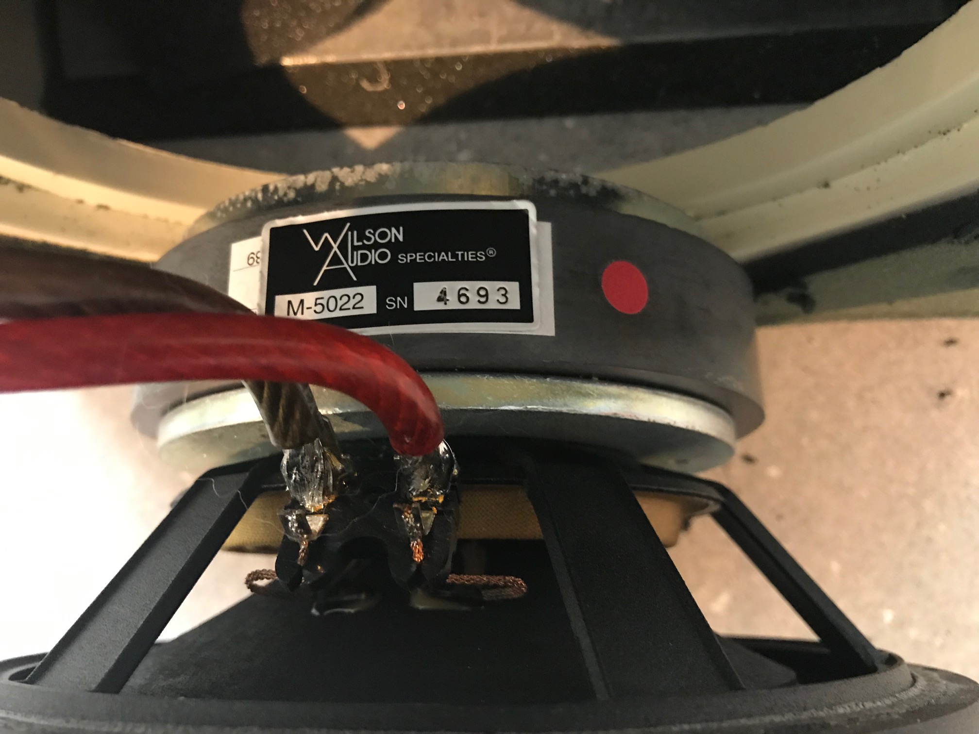

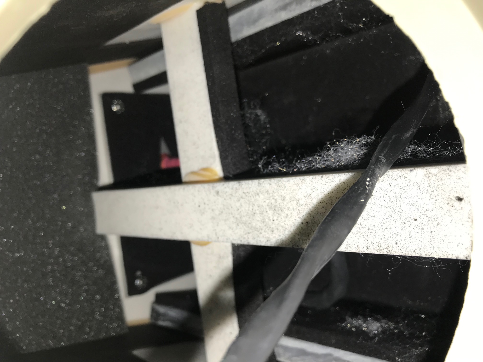

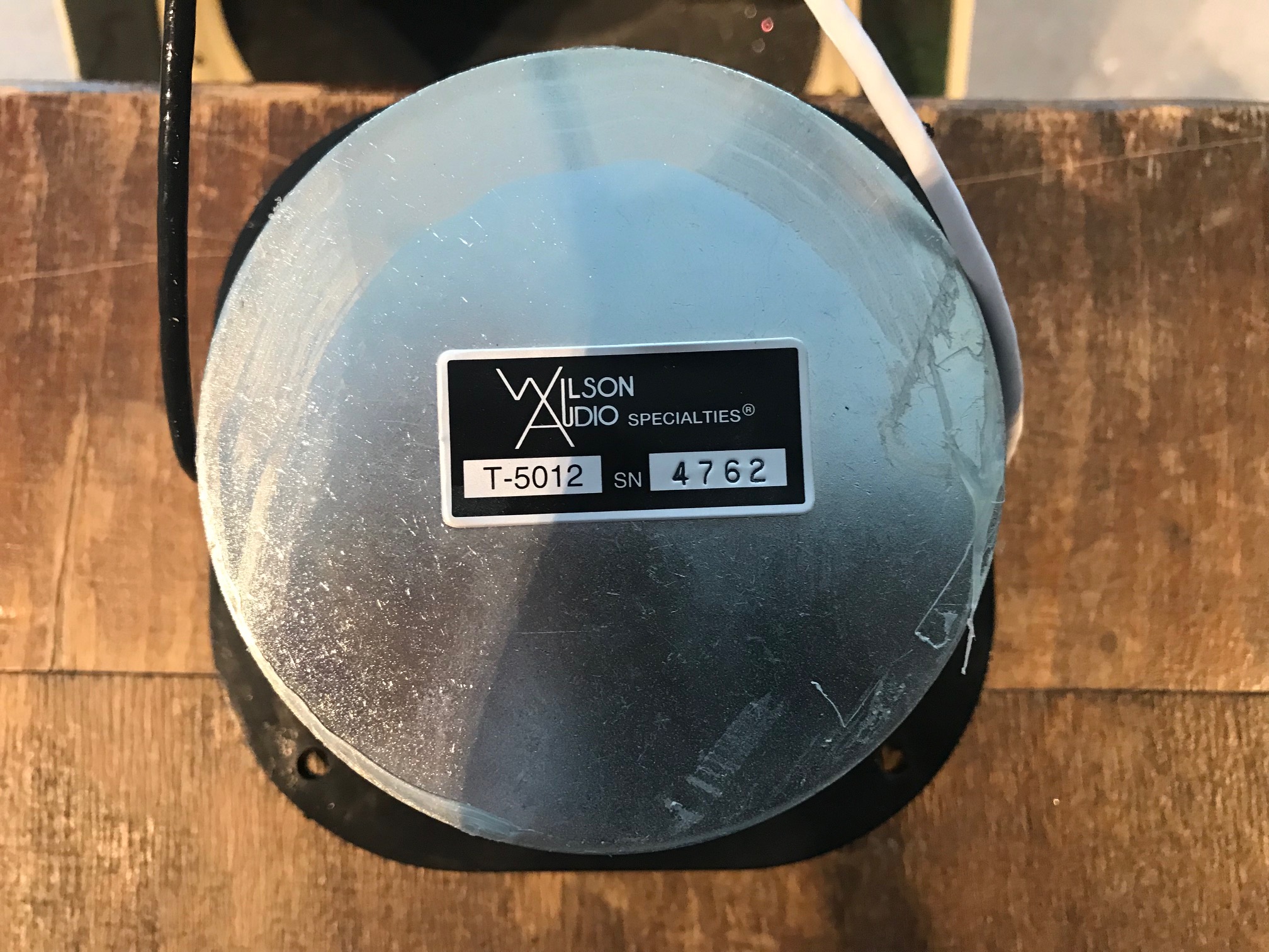

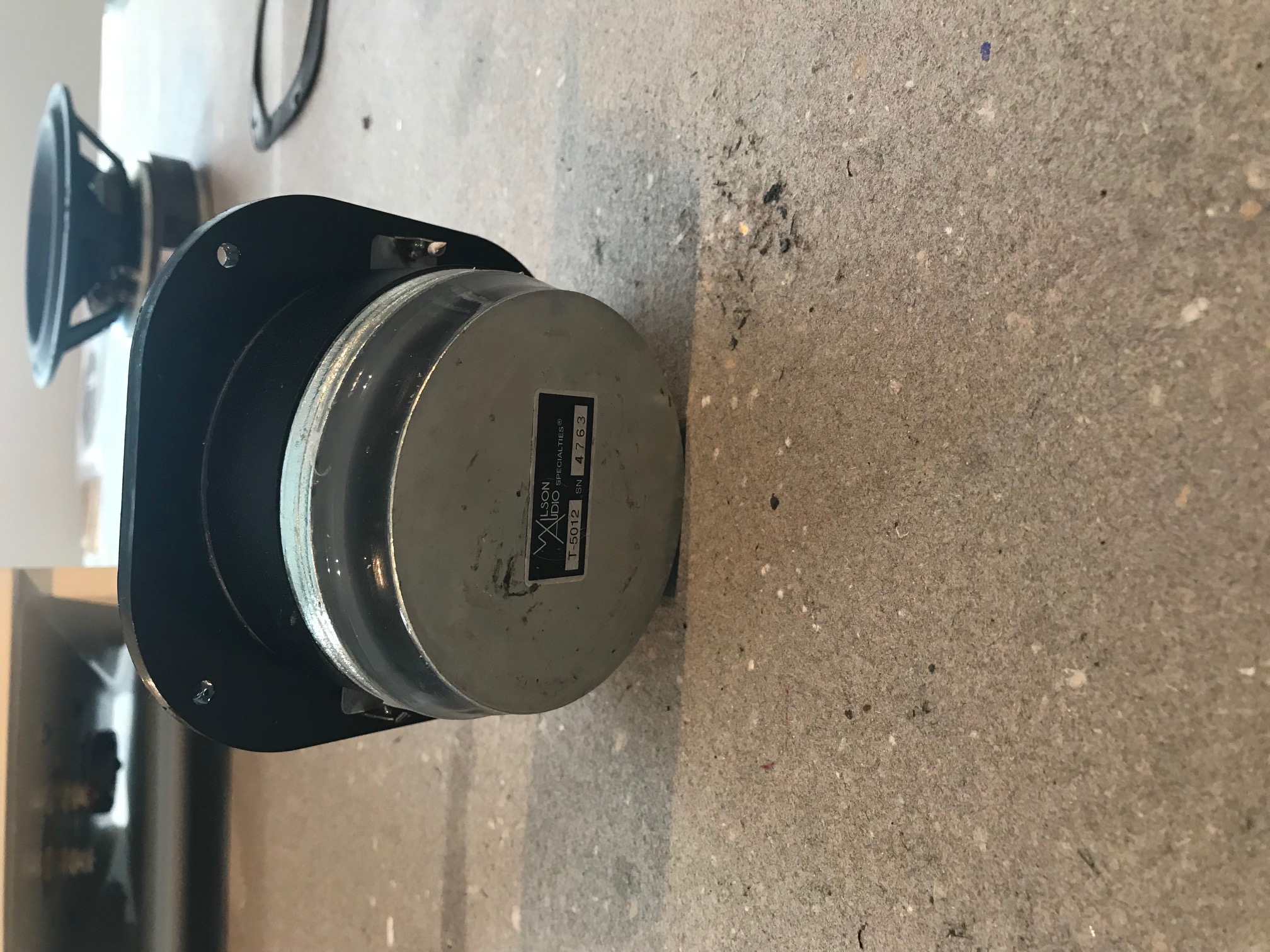

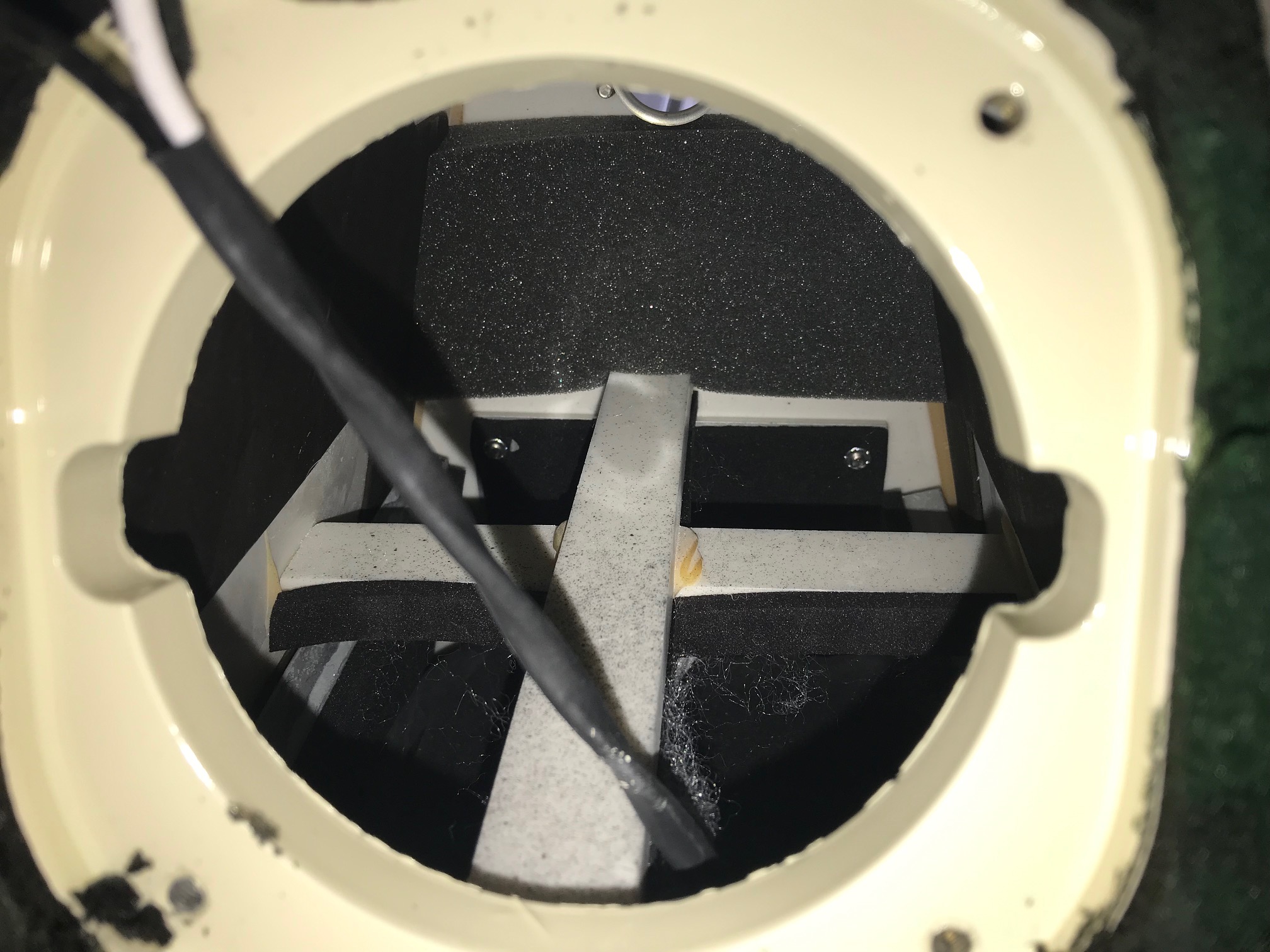

the biggest difficulty is the fact that the pottet crossovers are still stuck firmly to the walls of enclosure resp. envelope. Thus a measuring procedure without and with crossover network will provide the part values (µF/mH) by compare with external components. Now some pictures of the transducers and cabinet:
Nice relabeling of these drivers, 😀😀😉
I always find it super silly to be so fancy about a crossover schematic.
Just reverse engineering usually doesn't take that long.
Just a matter of visual inspection in combination with measuring some parts.
It's not really rocket science.
