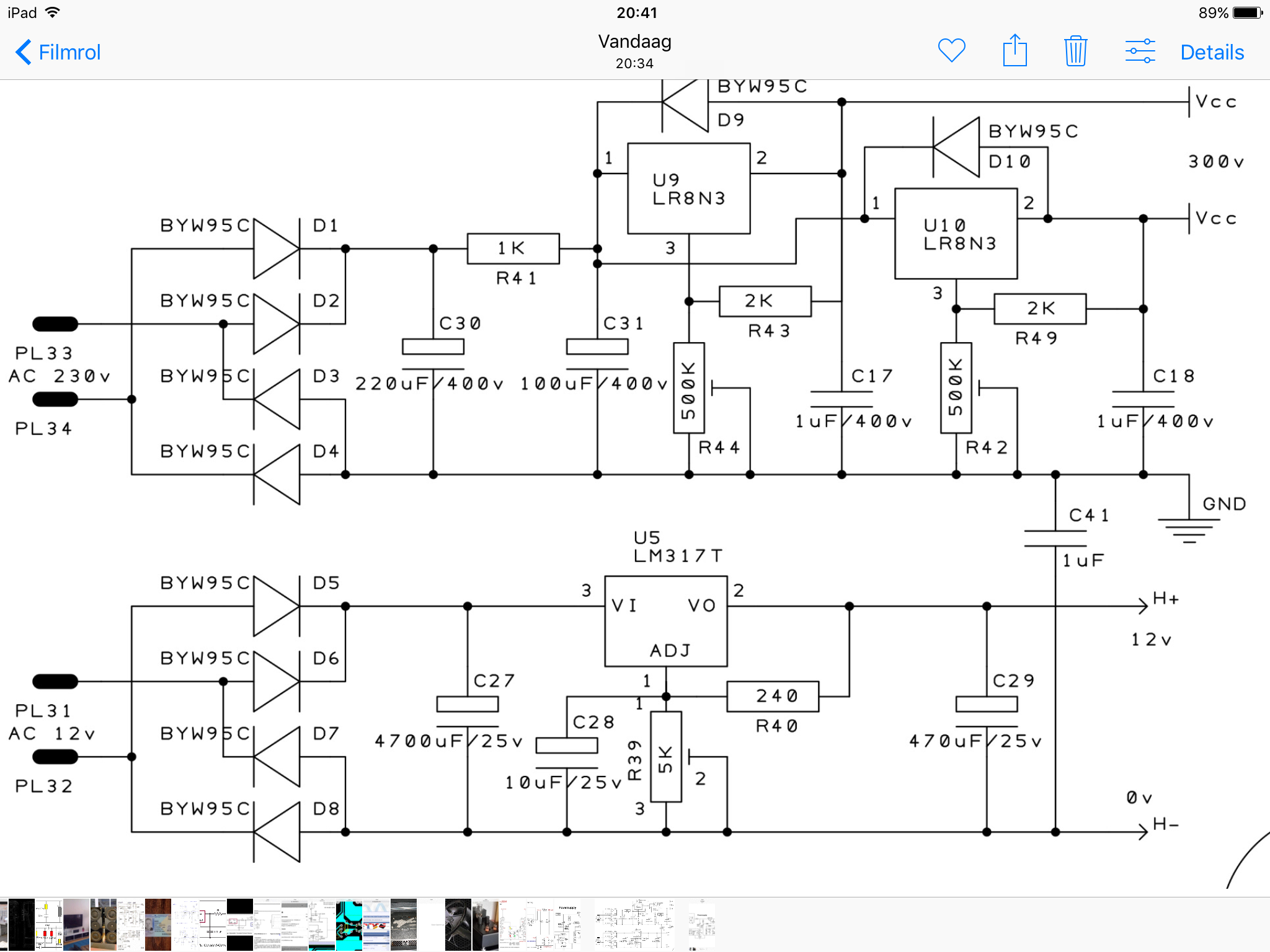

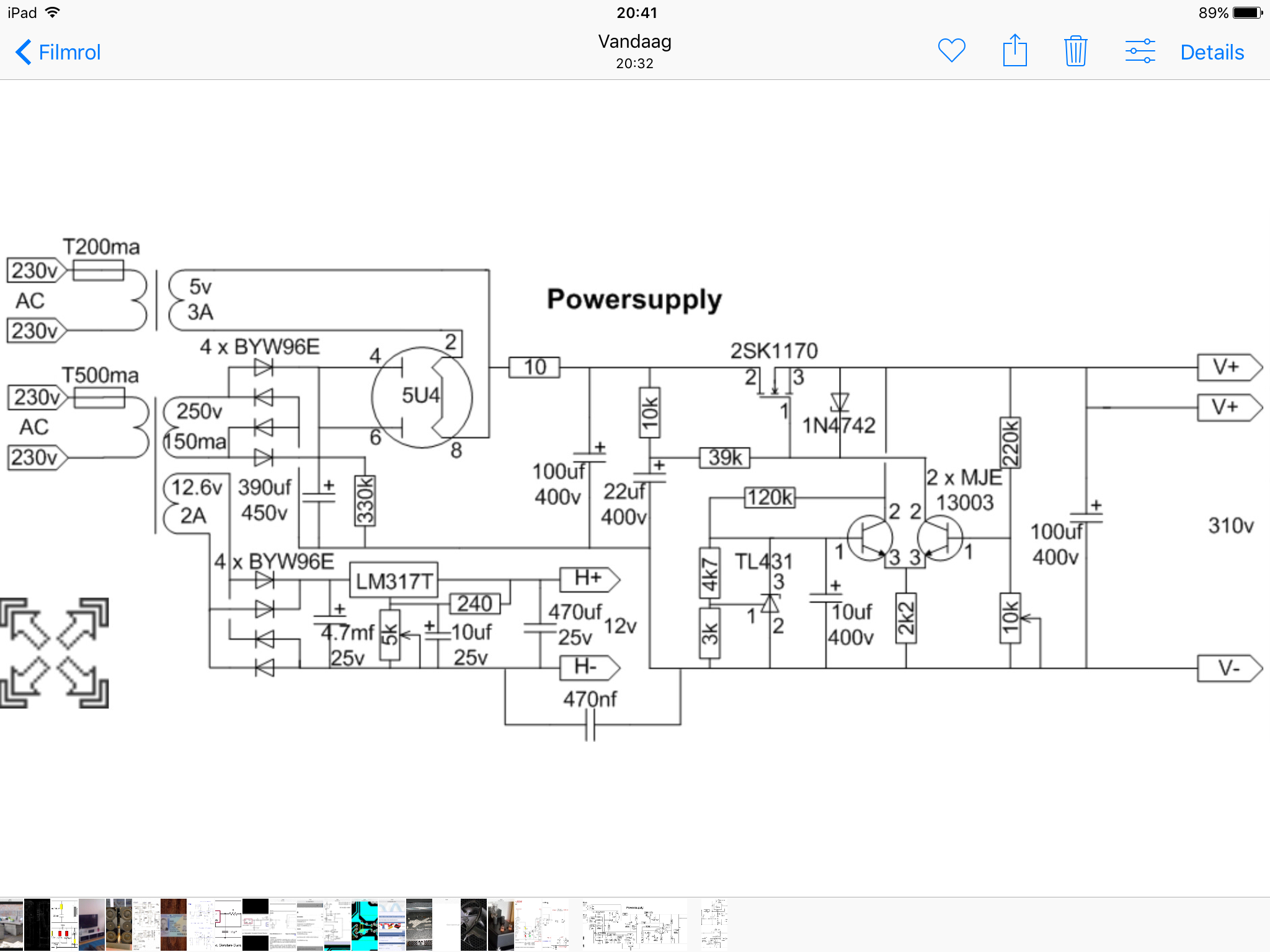

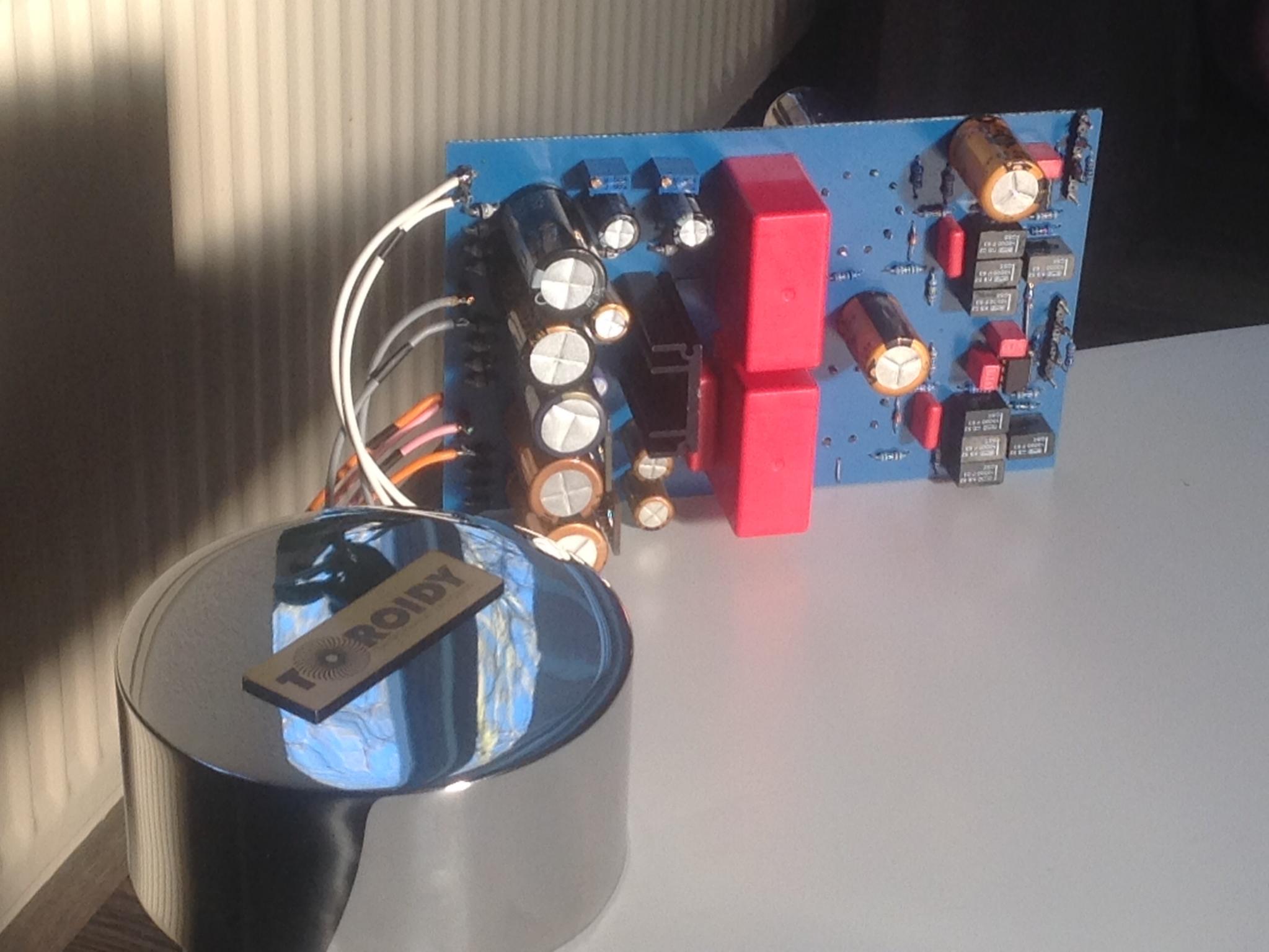

Below another two quiet power supplys.
First i use with the phonodude. Second i use with my hybrid phono preamp.
For 110v net just use transformer with the right primary voltage.

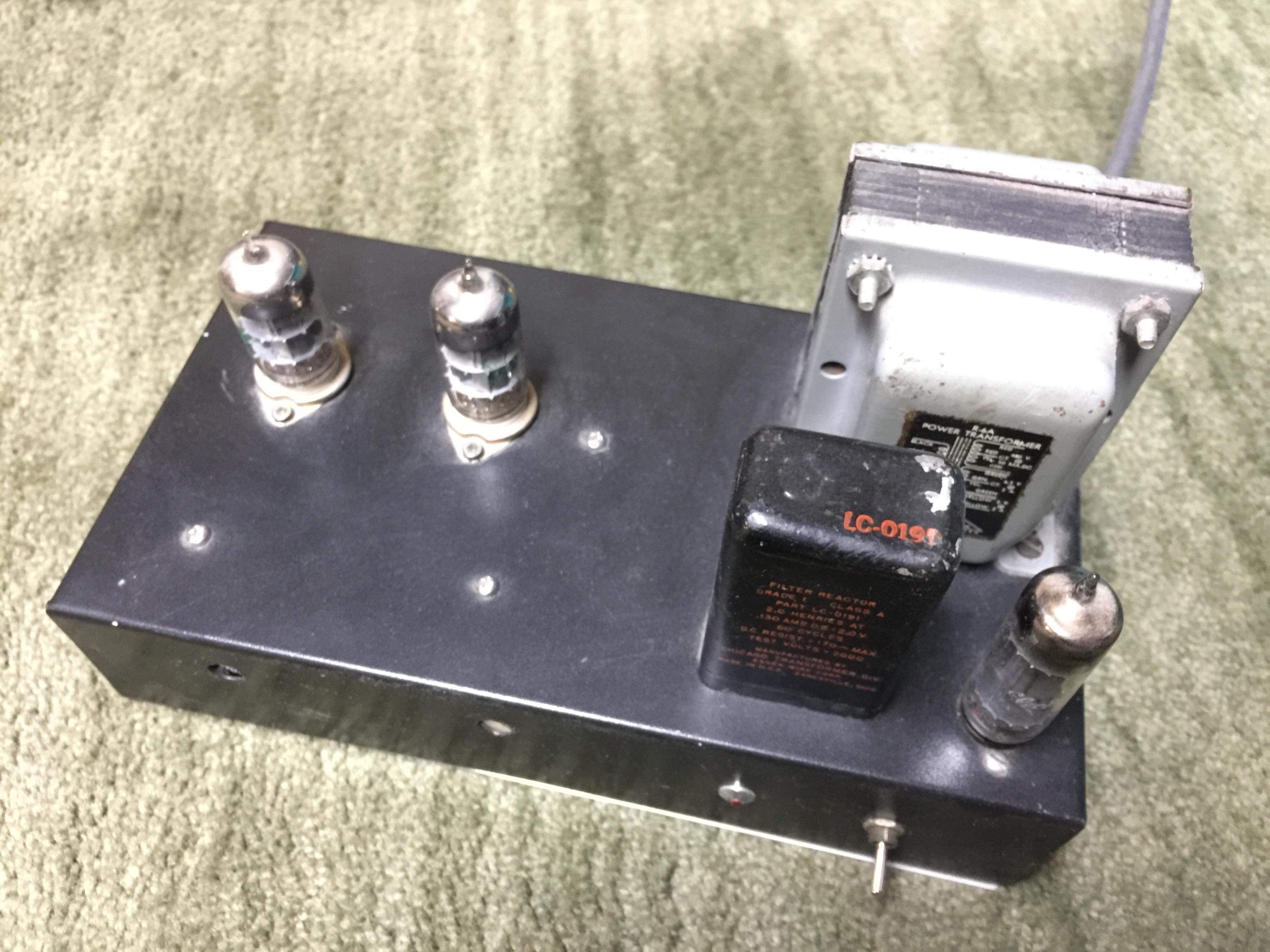

Alright here is my phonoclone. The chassis was used for something previously hence the two empty holes in the front. The choke is from an old military radio. Its dirty from sitting in the basement which was going to be my listening room but the acoustics are awful.
