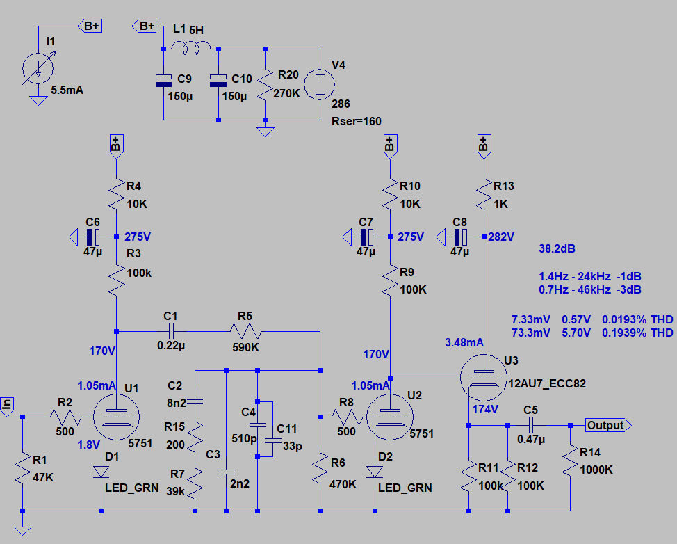

If you want no silicon in the circuit at all, you can replace the ZVN0545 MOSFET in Eli's design with a 12AT7 cathode follower. That will work well enough and give you a pretty nice phono stage. I whipped up a sketch that looks like it should work well.

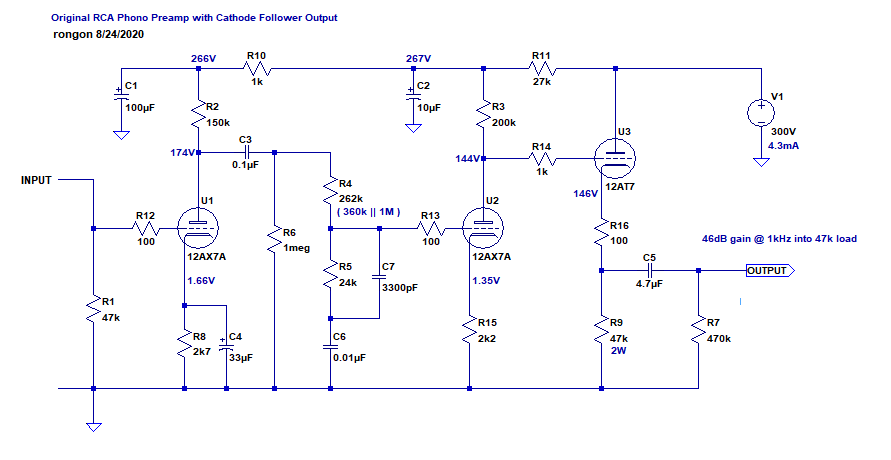

Some questions about the schematic:
- Where is the trace on the bottom left intended to go? (chassis ground?)
- This is one channel, and 12AX7/12AT7s have two halves. Just to be sure I'm 100% following, the intent is to use 1/2 of each tube per channel, correct? I've seen many applications in the guitar amp (mono) universe that have multiple halves in use, but for some reason (I've always assumed spatial/manufacturing constraints) only the one half of a given tube. I know this is an ubernoob question, and I'm fairly certain I know the answer, but want to be 100% certain rather than assume.
- In roughly the center of the schematic, you have a 262k resistor with "(360k || 1M)" below it inn blue. I assume that means the 262k can be swapped with either of the others? What would be gained in doing so?

The trace on the bottom left is 'ground'. Best practice would be to connect that to the chassis at the input and use insulated input jacks with their grounds connected to the chassis at the input.
You can wire it up so that each 12AX7 and 12AT7 has one side used for the Left channel and the other side used for the Right channel. Or you could use one 12AX7 for the Left channel and the other 12AX7 for the Right channel, but you'd still need to split the two 12AT7 halves between the Left and Right channels. I'm not sure there's any advantage to doing it one way or the other.
In either case, the heater supply will need to floated above ground to about +75V DC. That's because the 12AT7 cathodes will be about +150V above ground, which exceeds the maximum heater-cathode voltage spec.

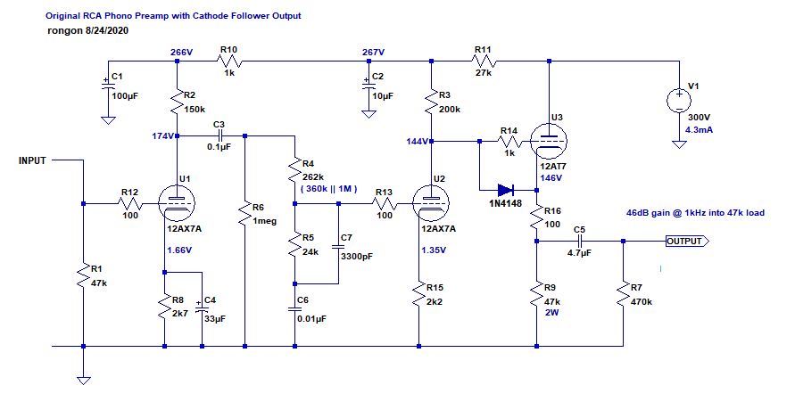

Also, I'd add a simple 1N4148 diode or a neon lamp between the cathode and grid of the 12AT7, to protect the tube from cathode stripping at turn on (in the few seconds before the tube begins conducting). That's just a preventative tweak; nothing to do with the sound.
262k resistors may not be easy to find, so you can use a 360k and a 1M resistor wired in parallel to make roughly 264k ohms if you have to.
Ah. Yup. Makes sense. See that all the time doing double duty as a power indicator lamp.

Right. Gotcha. I interpreted the || as the logical OR operator (software engineer). The math for paralleled resistors doesn't immediately pop out to my brain like some.
How would I go about a power supply for this? These always seem to be separate, and I don't understand why?
'Floating' the heater supply is pretty simple once you see it in a schematic. You might want to read through Merlin Blencowe's Valve Wizard website. Merlin's a great resource.

Actually in this case that wouldn't work. The 1N4148 diode doesn't make any light, and the neon lamp (if used properly for this purpose) will only light while it's protecting the tube, and will go dark once the circuit operates.
Ah. Just kidding then.

I do not disagree with any of your objections. I'm willing to allow some slippage in the ultimate sound quality in favor of following a particular design ethos. I write code for modern electronics stuff all day, every day. This is meant to be the polar opposite. I also like carburetors despite the fact that I live in the mountains and see as much as 3K' altitude change any time I go anywhere (at least 1K' every single trip). A little compromise isn't always a bad thing.
EDIT: I came back due to an email indicating a response (and running a time consuming simulation for work). I see that you've edited your reply above since I wrote and posted this reply (the initial post was just the first line). I've not yet read the edited reply, but will do so now. Just wanted to be clear since the response below seems to hint at something I missed in the edit.
