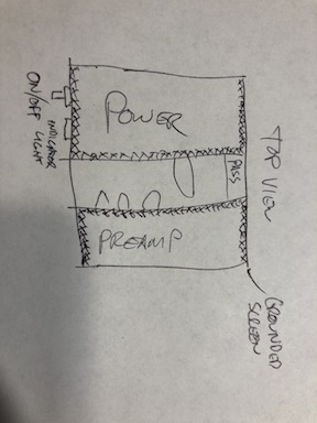

I have a plan for keeping the noise to a minimum. Long story short, imagine a footprint identical to that of the turn table divided into thirds the center third being a void, and the thirds on either side being wood boxes with either brass or copper plate (I literally just dug two large sheets of copper plate out of the side of the canyon wall weekend before last). The tubes stick into this void from either side. Rectifier tube from one side, preamp tubes from the other, transformers entirely contained inside the boxes. I've given thought to affixing some screen mesh around the inside of the boxes, and running that to ground as a faraday cage if it's not quiet enough. The only way for noise from the power supply to get to the preamp would be from the rectifier tube directly to the preamp tubes. No idea how effective it would really be, but that's what's been kicking around in my head for years. I live in a canyon that runs parallel to the face of the mountains/civilization, so external RF is likely really low (only a small handful of radio stations make it up here from Denver, and the canyon walls keep out most of the rest). My biggest problem is going to be that the power grid is not great, but there is literally a crew across the street right now replacing poles to rectify that exact situation.

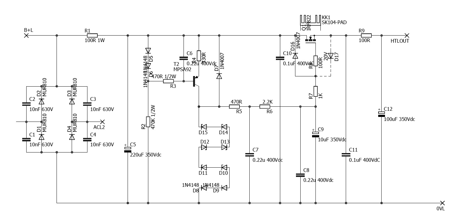

For simplicity you could always go with an LR8 regulator and a pass transistor for the B+ voltage. For filaments don't bother with the ancient LM317 anymore it wastes 3 volts. The MIC2941 has similar specs and drops only 0.6 volts at 1.25 amps.
Since LR8 is good for 400V and 10mA, and each tube will be consuming 300V and 2mA (12AX7) or 6.5mA (12AT7), why not regulate the B+ to each of the three tubes independently, each with its own LR8?

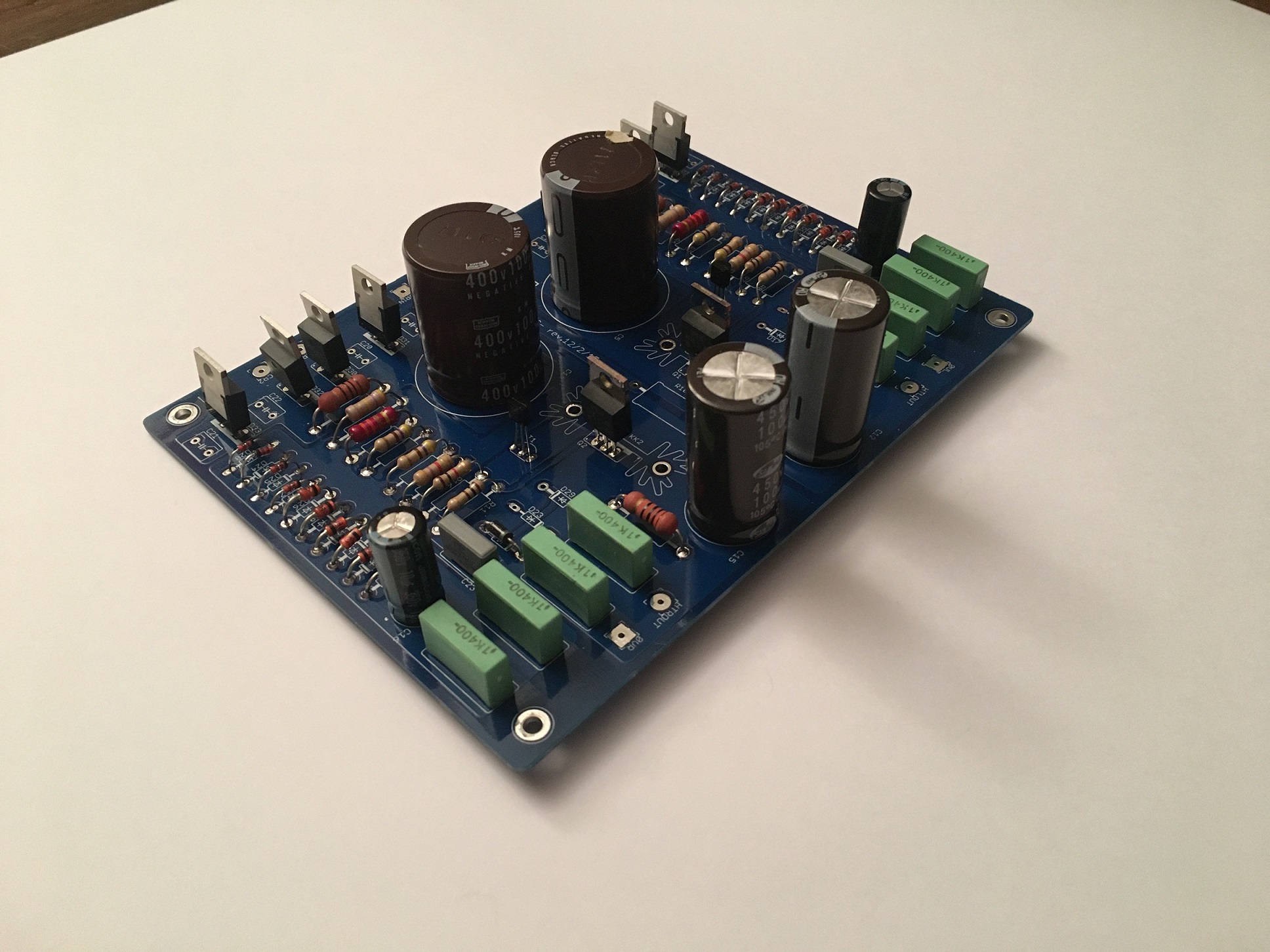

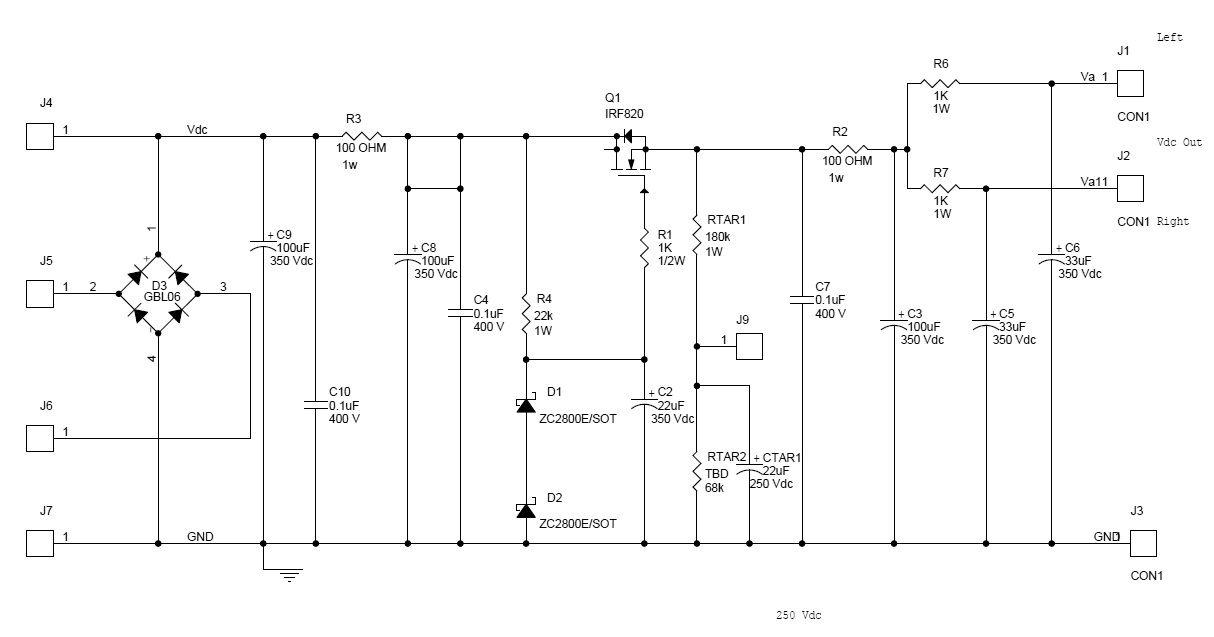

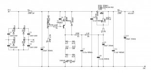

the best solution with Tubes and Riaa is the use of a regulated ss circuit.
In attach the circuit I use for my Junior and other stuff plus a diagram( one channel)
It is dual mono with bridge with diodes separated; the residual ripple is almost zero and the results are on lab test.
Please do the circuit with are presented with test lab otherwise is always a problem to understand the results.

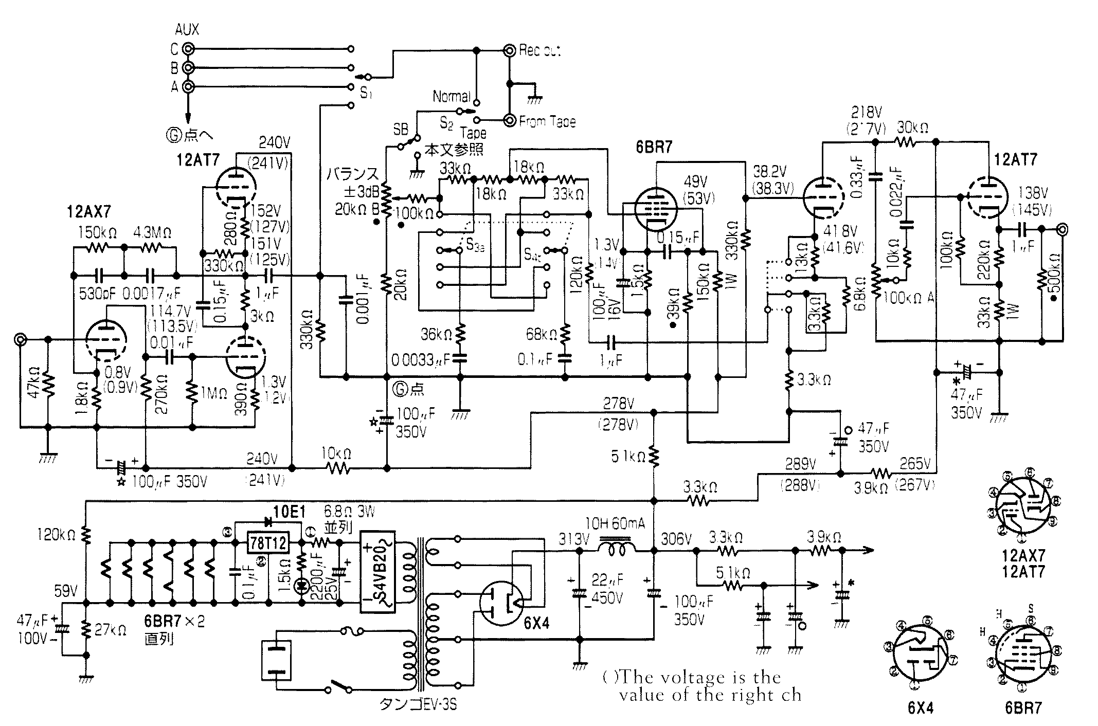

Armed with a few more microns of knowledge, I went back through to reread what's been said in the hope (certainty) that I missed some things.
Koifarm posted this earlier in the thread (last post on page 2). It's the wrong mains voltage, etc., but it looks close to something that might work. It sounds like it'll take some effort to keep the hum down with this, but that seems like a good set of techniques to learn. Can this be massaged to work with US mains and the preamp we're working with?
It seems like a fair bit of that comes down to physical elements of assembly. One thing that comes to mind from my automotive hobby is shielding the heater wires a la Faraday. There exists stainless steel mesh wire looming for automotive racing applications. It wouldn't help with internal hum, but would shut down anything in the chassis. Combined with 7025s (TubeDepot lists some Electro Harmonix 7025s as new production, so there's a box checker), that might help quite a bit, and may even be serviceable.

That schematic employs a full wave center tapped (FWCT) rectifier into a Π section, AKA CLC, filter. It is poorly regulated. The FWCT 6CA4/EZ81 setup is a given. A choke I/P filter is how you fulfill your desires of 100% tubed and only current production, along with obtaining good regulation of the B+ rail voltage. TANSTAAFL! That schematic also employs a SS rectified and regulated DC heater supply.

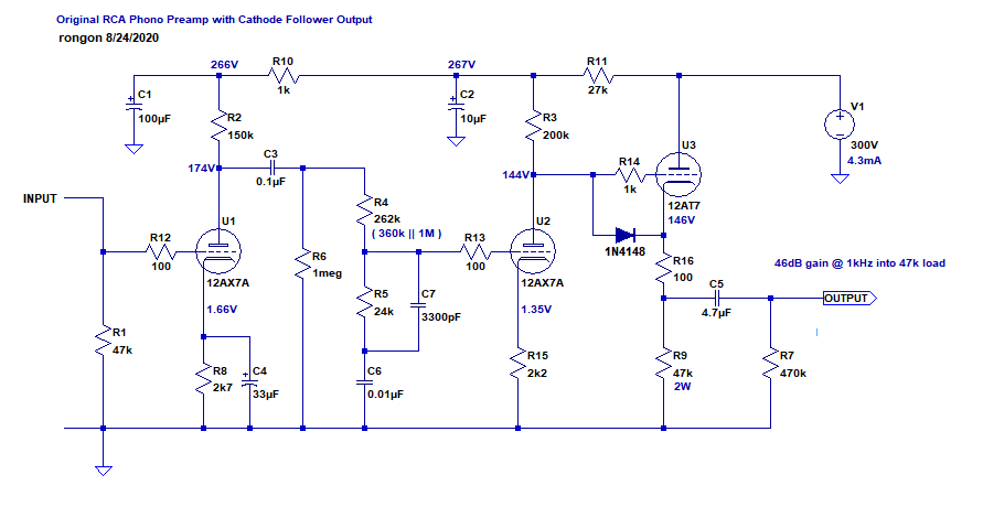

Small signal tubes are going to be pulling a few milliamps constantly so supply regulation is of little concern. Regulation for minimizing noise? Sure. Current should be constant with this type of load.

Ah... That's probably what "Audio-Creative voeding PCB" is... I see now that's the heater supply section.
