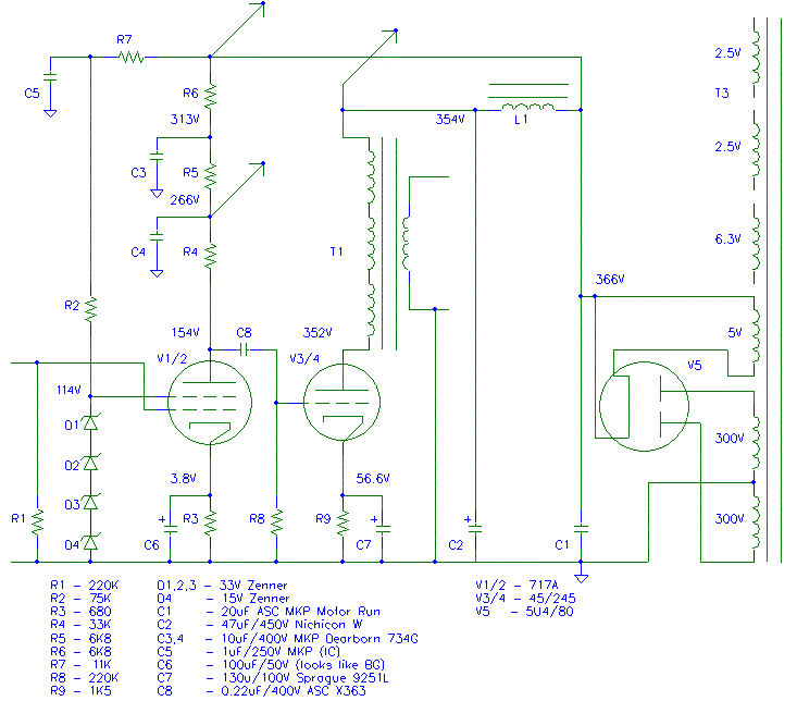

Konnichiwa,
sonix said:
have anyone the schematic from this amp?
yamamoto a-08
The Web Pages contain enough high rez photos of the innards to reverse engineer the schematic, so have a go.
Start with these, rotating them to be readable:
Then look at the picture of the circuit in thius PDF - zoom in:
http://www2.117.ne.jp/~y-s/A-08ura.pdf
Another hint, electrially the 717A and the C3m are not miles away.
Sayonara
Konnichiwa,
I have decided to post the Schematic in another on-line group with pretty complete detail, so also find it here, in context. It is basically 99%, one or two values may be slightly different, but not much.
If you want to copy the Amplifier you do of course need the iron, considering fit/finish, component quality and inclusion of NOS Valves I'd think it's worth giving Yamamoto the business and buying the Kit if you want to build the Amplifier, a Set of Tamura Transformers and a nice case plus the valves will take most of the cost of the kit.... ;-)
Sayonara

Am I the only one here that finds this schematic not compelling?
Unbypassed zener string, Pentode driving a triode, ewwwww! Ok, the transformers and the cherry wood and the finish are sexy, but it really looks like somethinh an amateur would design. (How am I going to drive the DHT, it needs a lot of voltage! Oh! I ll just stisck a Pentode it has all this nice voltage gain!!!!)
While I understand your objections and would have completely agreed not too long ago I have to mention that I have heard several similar amps that sounded surprisingly good in fact. (IMHO I think in a lot of cases a single stage driver is preferable to several cascade triode stages in terms of resolution if there is sufficient drive capability available. Here I would probably use a single 5842/417A triode myself.) Given the voltage levels on the screen of that pentode I would be surprised if you could hear a difference in noise levels bypassed or unbypassed. You might want to try it before dissing it, once having done so you have more than engineering dogma and opinion to base it on.. (I have been all too guilty of the same things, so please don't take my comment too seriously..) 😀 FWIW
What's wrong with using pentode? Have you listened to it or an amp using pentode driving a triode? Didn't the Western Electric 91 use the same thing? If designed right, I don't see any reason to object to it.
Depends a whole lot on the pentode used, some of the more modern high transconductance types are quite good at it, the concern is always going to be the effect of output tube miller capacitance on the HF response.. High transconductance pentodes with modestly sized plate resistors running at high currents should slew well enough at high frequencies and shouldn't have a problem to well beyond 20kHz..

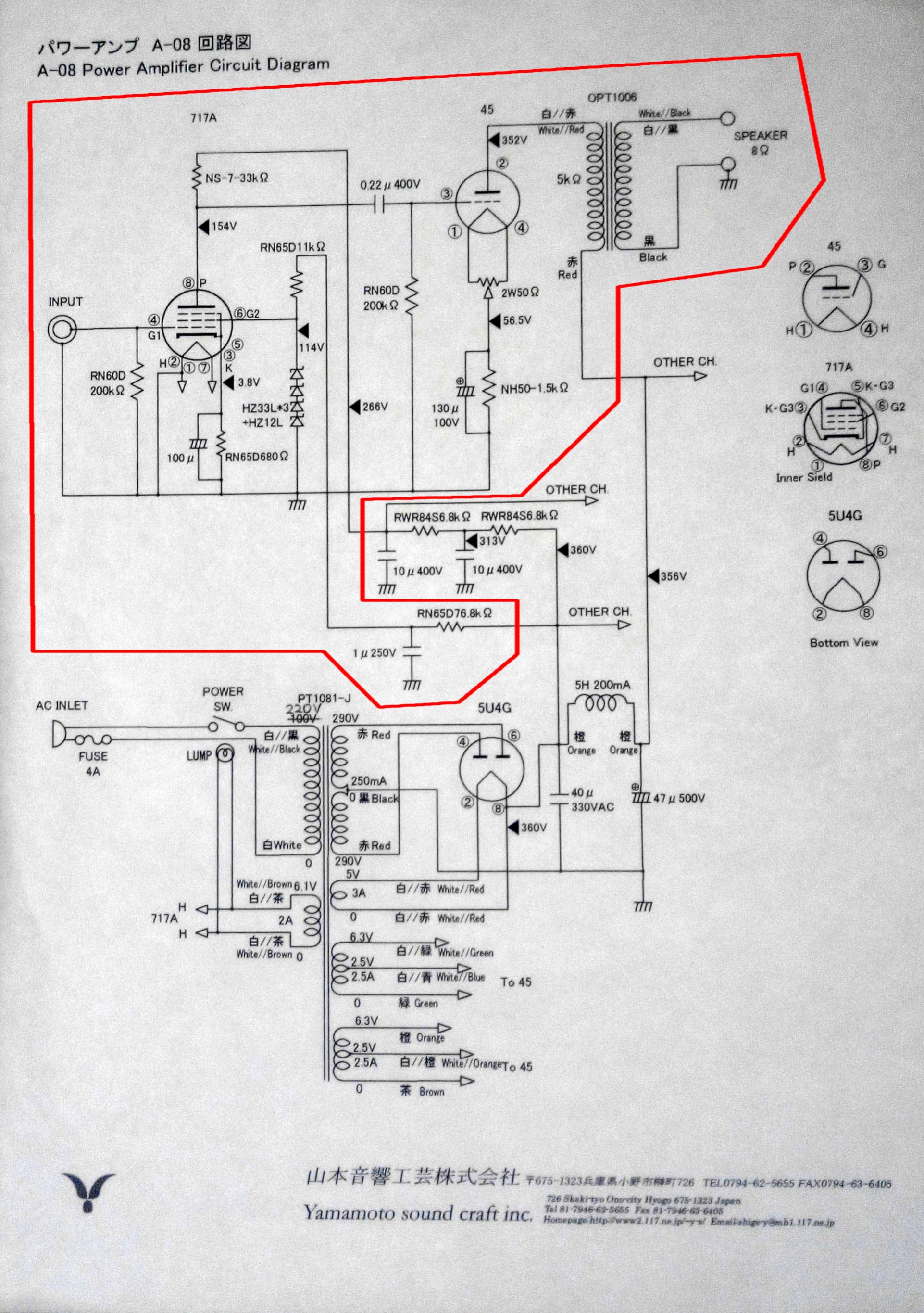

Can't really afford a $2400 amp as a student. What should I look for if I want to find similar irons?
Channel outline
Hello there,
I'm interested in building this with my own components and chassis, so I picked up the schematics from one of the links (originally from Yamamoto's manual) and enhanced the image for clarity.
Being kind of new to this, I also outlined the channel-related components to highlight which ones I need 2x of.
Can someone confirm that my outline is correct? Thanks.
