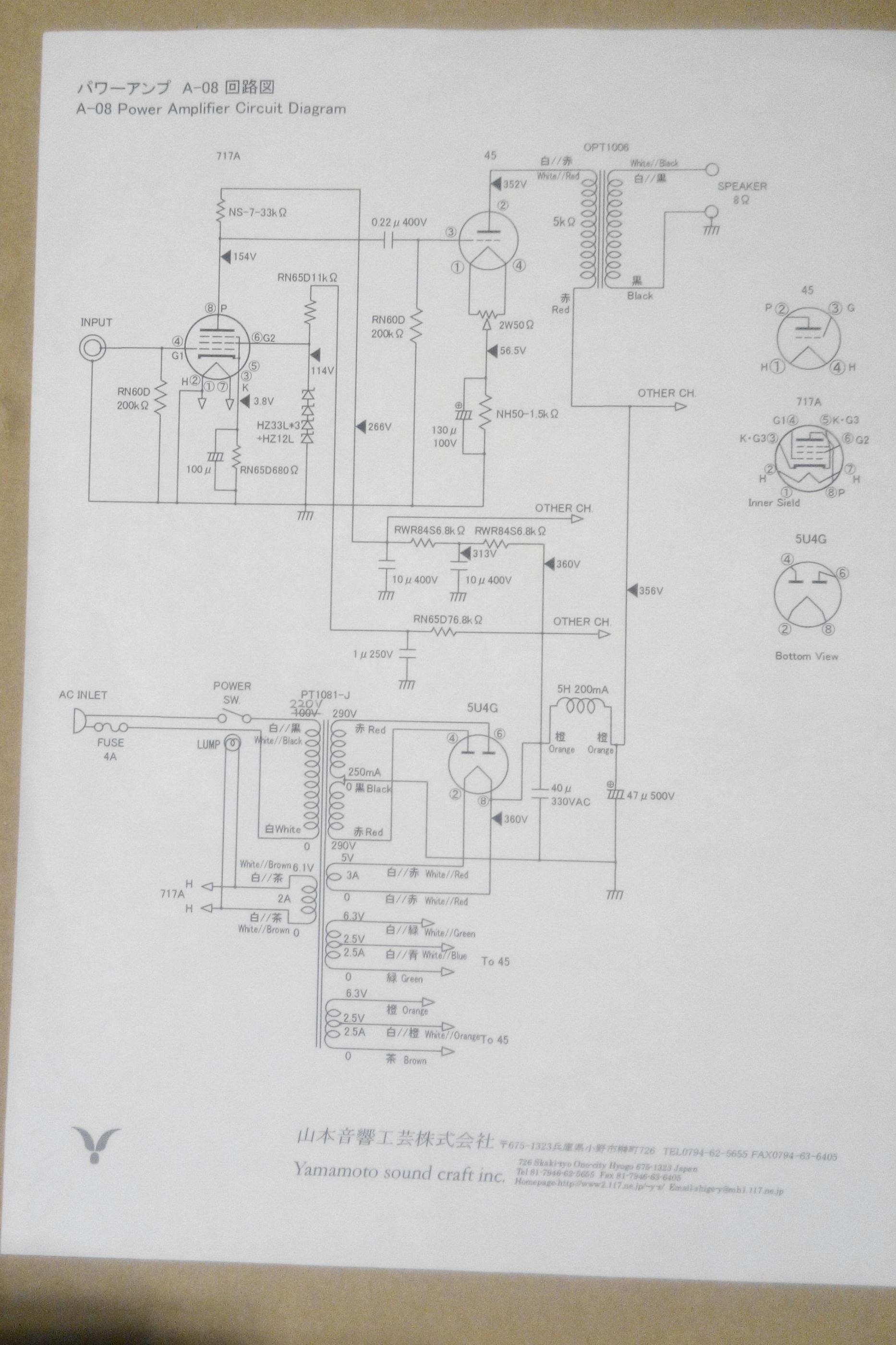

schematic from this amp 45/717a/5u4..
Thanks euro21. That would be a slightly different design, right?
Speaking of CLC, I notice that ThorstenL's diagram is different from the Yamamoto manual page in the first capacitor (C1) value: 20 vs. 40µF. I couldn't verify the value from photos since that's the upright, above chassis one. Which one is right?

I have decided to post the Schematic in another on-line group with pretty complete detail, so also find it here, in context. It is basically 99%, one or two values may be slightly different, but not much.
If you want to copy the Amplifier you do of course need the iron, considering fit/finish, component quality and inclusion of NOS Valves I'd think it's worth giving Yamamoto the business and buying the Kit if you want to build the Amplifier, a Set of Tamura Transformers and a nice case plus the valves will take most of the cost of the kit.... ;-)
Sayonara
Too many design flaws.
Zener string has its advantages: easy to calculate gain for a bogey tube: disadvantage : circuit performance deteriorates as the tubes age.
If you use a resistor divider with 100n-1u film to ground for G2 on the C3m your circuit becomes more tolerant to tube aging. Because as the tube ages the G2 current decreases, this will increase the voltage on G2 somewhat and keep the gain stable over time.
The drawbacks of this approach is that you need to know how to do a thevenin equivalent circuit of a voltage source with a resistor in series. You then eyeball the current from the graphs and plug those in to the circuit.
But i think the EC86 10M45S loaded is much nicer...
..... and that is a problem ? On Surface amplifier, I run 100uf / 30H / 100 uf , for the plate supply.. have not seen any issues. I could run more, but it's a part cost vs performance, and these values work pretty good enough....
This is my first amp project not from a complete kit, so I have a very basic (to put it mildly) understanding of the math and I'm trying to stick to the design. The only variable that I have to change is the OPTs that I just bought for another 45 project before changing my mind and started getting materials for the Hashimoto design.
Having read elsewhere that the capacitor values in the PSU are best closer to spec, I'm kind of confused about which values I should follow. At this point, following the original manual seems the safest bet. Forgive the newbie's confusion...

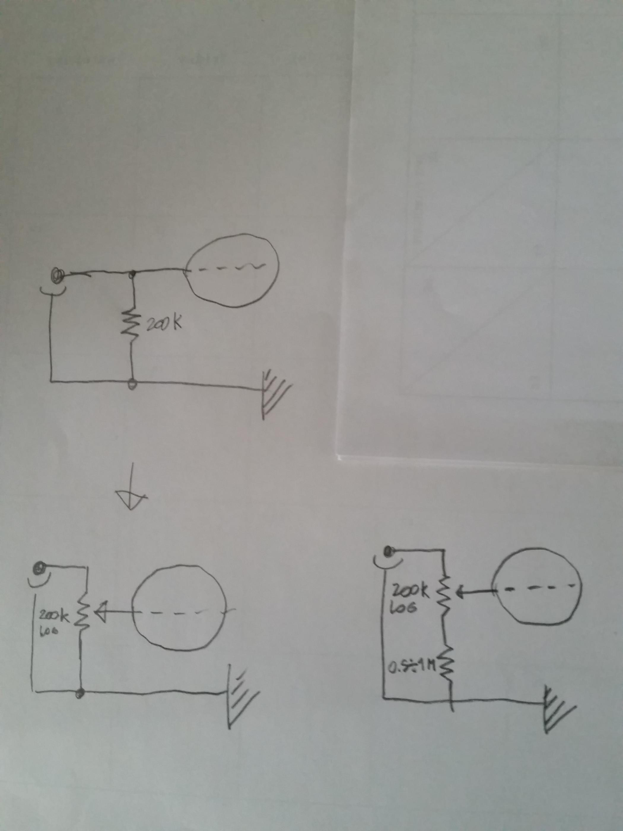

gattu marrudu,
You have two each 200k resistors, one for the input stage grid, and one for the 45 grid.
I thought you meant to get rid of the whole driver stage, and replace it with a line stage and a volume control.
Silly me, that was not what you wanted to do.
6A3sUMMER, yes, just the potentiometer—I have already a phono stage (Roy Mottram's PH16) and a preamplified DAC with plenty of output to drive my Audio Nirvana 300B SET and 10' full range speakers. In my small room I play the 300B at about 1/5 volume.
Theoretically yes ... but when potmeter wiper not contacting correctly, the tube grid potential undefined (no grid leak resistor).
Usually use this layout as potmeter wiper joined to grid, but large (0.5-1Meg) grid leak resistor also in use.
So, like in the attached drawing? (bottom left is my mod, bottom right your suggestion) Also would using a high quality potentiometer be enough to avoid bad surprises?
