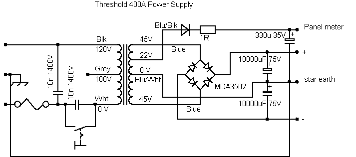

Just make sure you put the new caps in exactly the same polarity as the old ones you take out - sketch up a drawing to be sure. You do not want a cap of that size with reversed voltage applied to it.
This should be the wiring diagram of the PSU in your 400A.
The caps have a different value, but the wiring will be the same. The diode bridge here is rated at 35A at 200V.
Also I think the sec voltage should be more like 55VAC rather than the shown 45VAC - if the rails as shown on the amp schematic are to be approx 75VDC.
