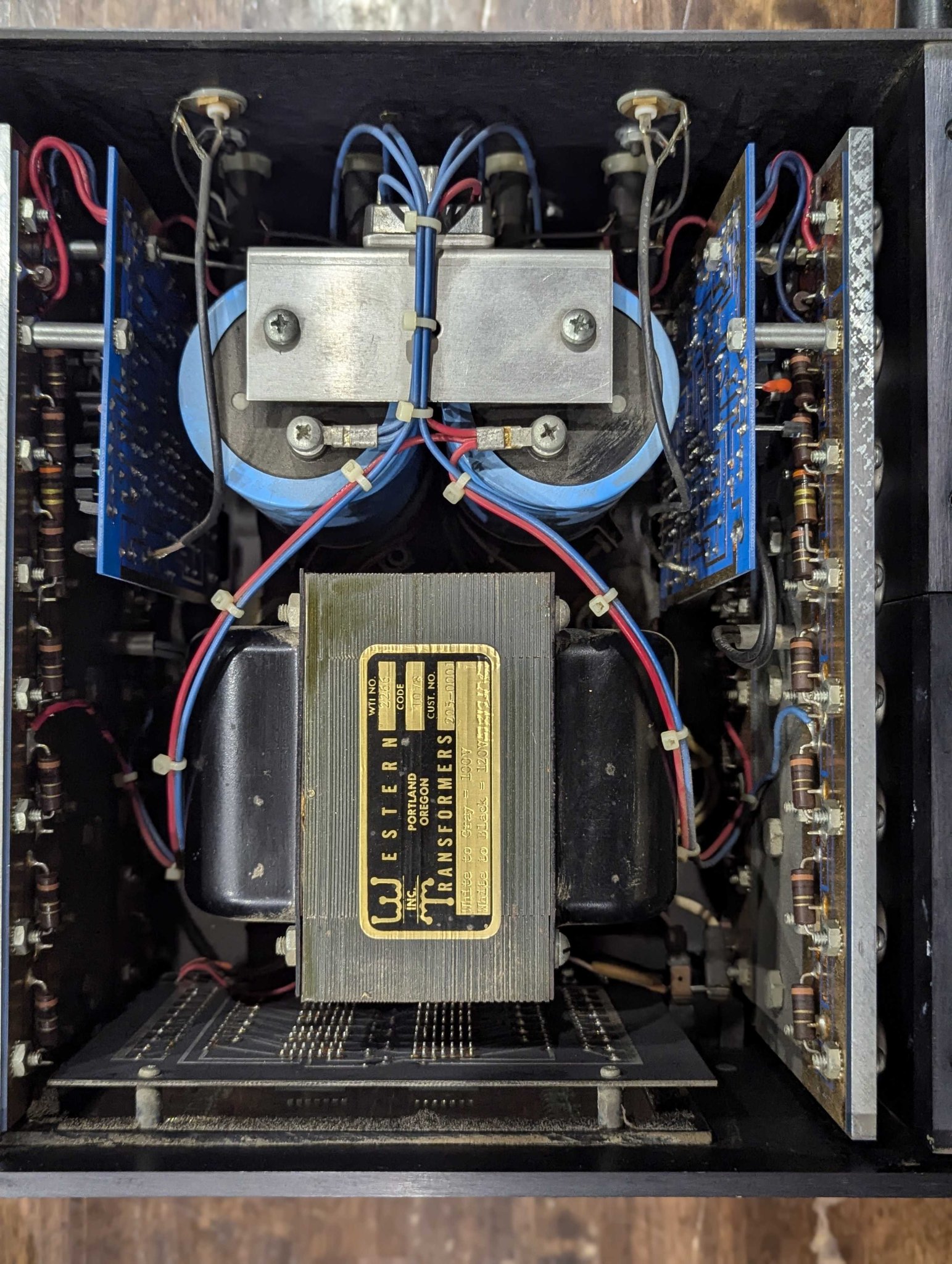

Gary S, here are the specs you requested for the Threshold 400A PSU capacitors (2ea):
Manufacturer: Mallory
Type: CGS
Capacitance in uF (found on cap label) 15000mfd
DC voltage rating (found on cap label) 80vdc

Hi Paul, thanks for the details. You wont find those original caps anymore - but a direct replacement is the Nichicon LNT 22,000uF 80VDC rated type. It is 63mm diameter and only 100mm high - so you gain some height and will fit existing clamps. You will also note it is a higher capacitance value, which is good for this type of amp. It is also rated at 105 deg C - so higher than the original cap as well.
Jon Soderberg uses this newer type value and it is the same one I have used on other Stasis rebuilds as well with other members.
Cheapest source is Mouser in the US at $43.64 USD each and they are in stock at the moment. The Mouser part number is: 647-LNT1K223MSE

Gary, thanks for doing the research for me. I noticed that that part number has a 2000 hour lifespan. Ive seen some others that have as much as 5000 hour lifespan. Should I be concerned about that? Is there possibly an alternative cap with a 5000 hour lifespan?

I found this one. It looks like it is also a good quality. https://www.mouser.com/ProductDetail/KEMET/ALS80A223DF063?qs=AQlKX63v8RtuKVNgRabIDA== What do you think?
The one weakness in the above cap, is its voltage rating: 63 vdc. That proabably disqualifies it, doesn't it?
Yes it does, as the power supply voltage will be around 72VDC or so on your amp. Also that cap is only 36mm diameter.
There is not much choice these days in the big can caps - not like the good old days. 2000 hours is fine, I don't think you will find one in the case size you need. The caps will last for way longer than 2000 hours by the way. Over 20 years or more some PSU caps could have been energised for more than 20,000 hours when you work it out.

I am not quite sure of your intentions, if you are going to rebuild the amp, then buy the caps then. If the amp is working now, it won't hurt to put new PSU caps in. You mention 2 off caps - are there only 2 in your chassis? Normally in the Threshold amps of that rating there are 4 caps.
I would replace the diode bridge(s) that feeds the PSU caps at the same time. Any 35 amp rated at 600 or more VDC rating will be fine - even a 50 amp rated unit is not overkill. I usually use 1000VDC rated bridges.
As I mentioned previously, I would be replacing the output transistors with On Semi TO3 devices and new 3 watt emitter resistors.

Here's a photo of the inside of my Threshold 400A S/N serial A78121065. As you can see there are 2 power supply capacitors, not 4.
