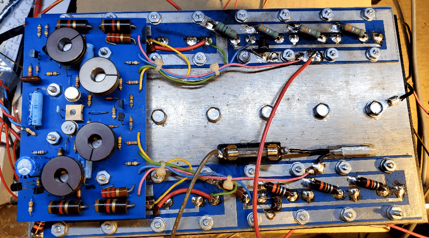

Fortunately your FE boards look pretty clean and reusable, the rebuilds I have been involved in have all had to have the FE boards replaced with the newer Nelson Pass Stasis FE board ( there is a thread about that you might want to look at) on the forum. This is that thread: https://www.diyaudio.com/community/threads/new-stasis-front-end.363701/
There are a lot of other Threshold threshold rebuild thread in the Passlabs forum, a few on the 400A even - just do a search.

If your current FE boards are working, then I would stay with them - from your pics, they look quite clean actually. The other rebuilds I have been involved in had damaged/burnt original FE boards with blown components, and we replaced those with the new Pass FE boards (Zen Mod has also done a pcb of the same design but on a smaller sized pcb). They all worked out well with happy owners.
