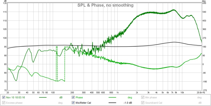

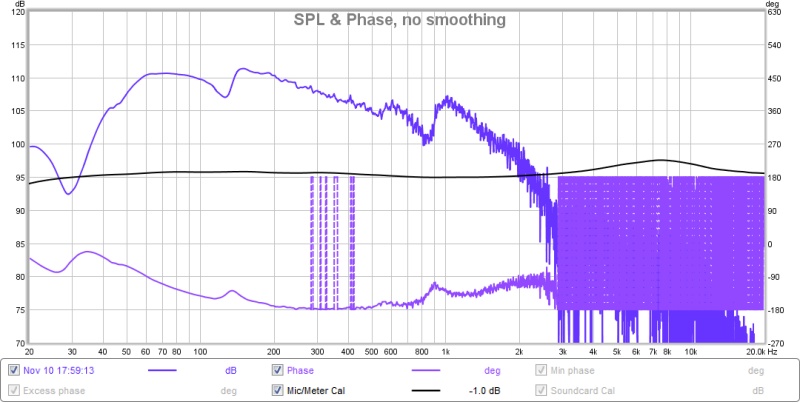

some near field measurements
here are some nearfield measurements that wewe taken very close to the dust cap with REW. I will have to work on a pole long enough to take gated 1 meter measurements, hopefully soon.

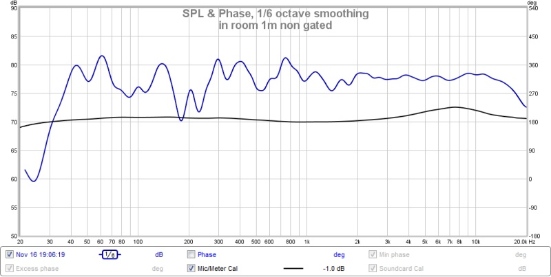

if you refer to post#1 of this thread you will get the details.
