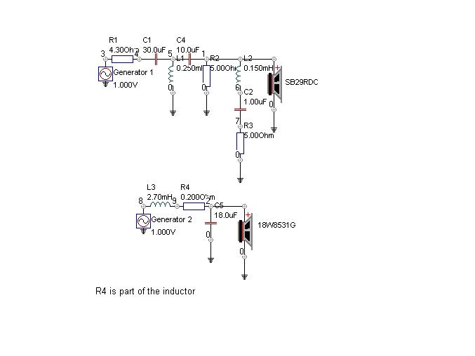

can't say I'm surpriced to read this, after I had studied the xo and noticed a series 2.7mH inductor in series with the midwoofer
I suppose this is a simulated design ... or ?
just curious ...
how does it become a commercial kit, and what is the proceedure ?
and your part of the commercial aspect ?

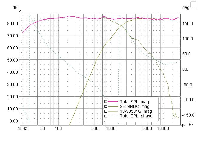

some near field measurements
here are some nearfield measurements that wewe taken very close to the dust cap with REW. I will have to work on a pole long enough to take gated 1 meter measurements, hopefully soon.
