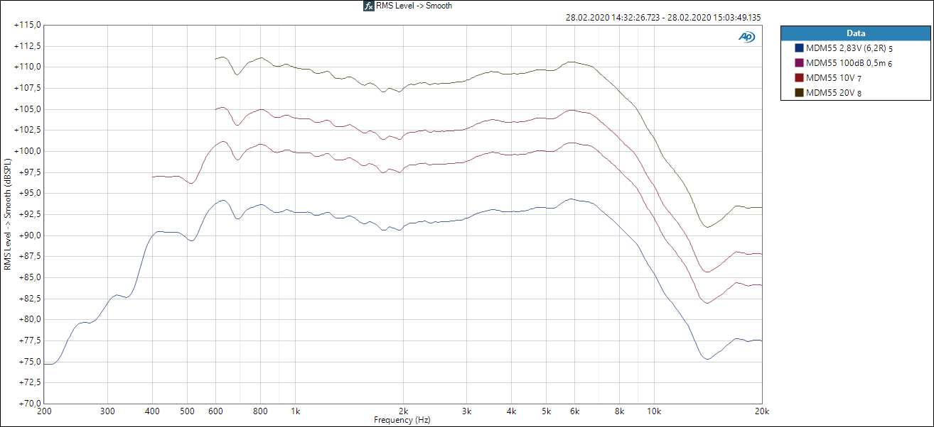

With 2 MDM55 you can cross lower as 800Hz for a "normal" HiFi Speaker. It's not a super low THD driver but nice and stable.
The MDM55 is a very good 2" dome. As said before, not the lowest word in THD, but its distortion profile isn't offending to the ears. Thats what matters most. The upper end is slso very smooth and extended past 6k, so you can cross it above 4k. Its also a solid 89 dB/2.8V, which is more than plenty of sensitivity for 3 ways with larger drivers.
Also don't overlook the Hivi DMB-A. For $25 its a steal. Not as clean as the Morel, but close.
Many of these mid domes have a dominant 3rd order peak but its not off putting. The motors usually suffer from a little magnetic asymmetry, mainly caused by the inboard magnet setup. The short VC winding height to upper gap ratio further compounds this.
I've used the MDM55 in alot of monitor builds. They require an 800 hz 2nd order min HP which can be lowered to 650 hz using a pair shaded in one cabinet. ⁵ By the time you buy a pair of these, you're out of oocketalmost $250. You can get quite a better mid for that.

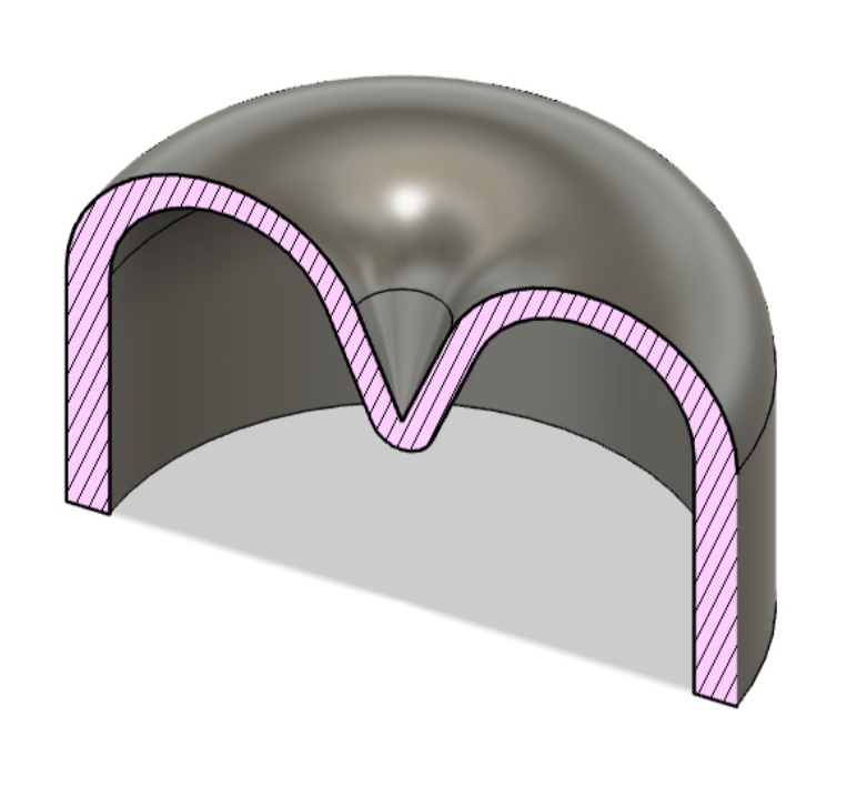

I'm done with prototyping a design using some cone shapes made from foam board and epoxy. A terminated TL is IMO the best shape for dampening without over doing it, losing too much precious lower mid output. The rear volume is much less than originally speced out. Its enough for a 600 hz 2nd order HP with plenty of output to achieve a 100 dB+ at reasonably low distortion numbers.

Do you have an image that could help visualise the concept? What is the internal volume and how are you setting up the TL, is it a simple internal insert or more complex?

The rear chamber shape is similar to those used on some B&W tweeters. The SB MD60N dome mid also has a type of 1/4 wave TL chamber. Its a bit more tricky on a larger dome without making it too large for most enclosure depths.

I'll be posting the STL file once the design is tested with absorption media in place and it fits the D7608 as intended. The chamber design is for personal use only. Any commercial use should be cleared with me first.
Initially I'll be printing a pair of test chambers from PLA to verify the overall fitment and perform some measurements. I took inspiration from the newer Seas T35C002 design, as it requires minimal mechanical dampening to achieve decent decay spectrum and avoid most common standing wave modes.

Looks great, it is quite cute what is the volume? My current chamber design for the D7608 is 1.1L with triangular diffusers at the back, I think it was supposed to provide a Qts around 0.6. I have a very economic local 3d printing service nearby so I will likely give these a shot.

Volume is about 350 ml net. The Qtc will land around .65 - .70 and highly depends on dampening media quantity. Going lower will only throw away sensitivity and precious output potential. I'd recommend ABS filament for these as it glues very well with contact adhesive or cyanoacrylic resin.
