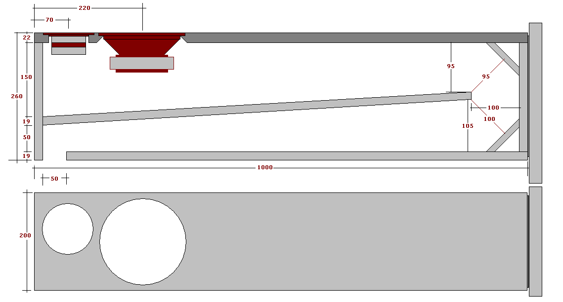

You can place the port to the rear or front.
13 liter volume, Fb = 43 Hz, port = 50 (ID) x 143 mm (use port unchanged)
18 liter volume, Fb = 37 Hz, port = 50 (ID) x 140 mm (use port unchanged)
22 liter volume, Fb = 37 Hz, port = 50 (ID) x 110 mm (cut to 110 mm length)
but I suggest is TL version Studio-101
That makes it even stranger that my woofers start playing 70 or 80 Hz (at least feels like it). Thanks for your comment. What do you mean by TL version? So I can use the exact same crossover for 13, 18 AND 22l cabinets? Surprises me!

TL is the pic i post ,means tramission line Transmission line loudspeaker - WikipediaWhat do you mean by TL version? So I can use the exact same crossover for 13, 18 AND 22l cabinets? Surprises me!
Yes you can the more add more L is relate to bass estension not to xo ,and is simple to add
PS as suggestion up work on reflex port too
Yes I have heard many good things about Transmission Line speakers. Also that it is very difficult to design. Looks doable after all on the picture. Bass control and extension is supposed to be unbeatable on TL speakers if done the right way!
