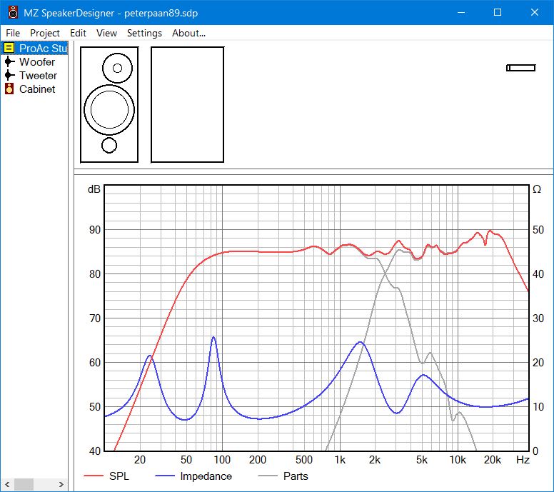

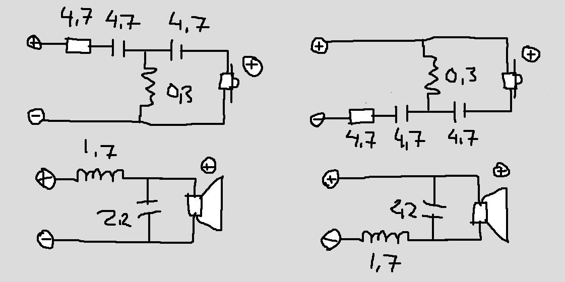

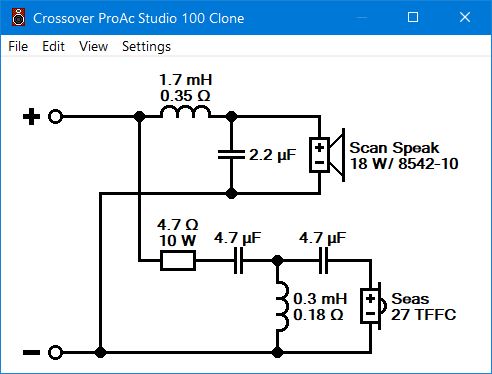

ScanSpeak 18W8542-10 bass response in ProAc Studio 100 clones
Yes I like this speaker, had the Studio 1 MK2 before. I do have the drivers here now and kind of want to use them as selling and buying others will cost more money.
What else would you suggest? As I am not living in a house and probably won't in the near future, standmounts are preferred.
