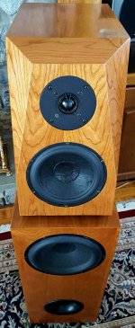

BTW, here's a photo of the 98000 tweeter in action on my Scan-Speak 8" 2.5-ways.

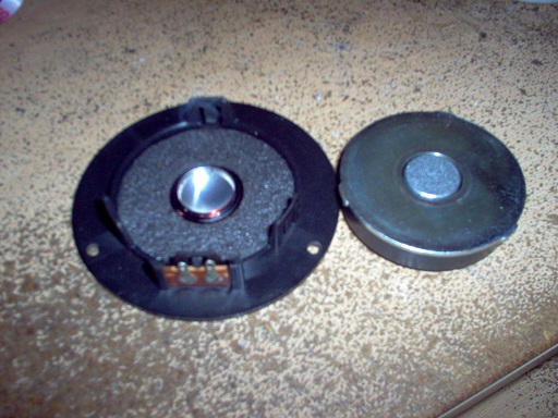

Ferrofluid is easy enough to replace in a tweeter with a replaceable voicecoil:
Ferrofluid 100uL General Purpose for 1" Diameter V.C.

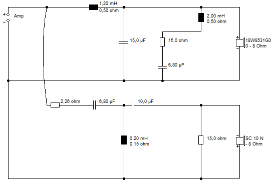

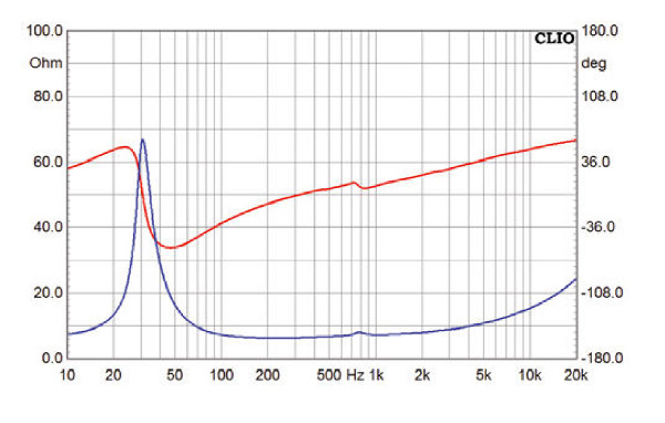

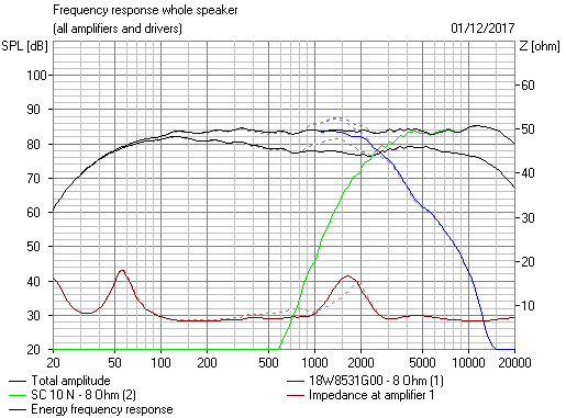

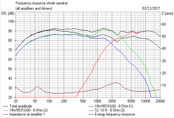

This whole thing is a bit suspect to me:
I don't get an impedance anything like this:
And the frequency response is suspiciously flat.
I had to redo the tweeter filter for a more conventional flat tweeter here so the impedance is slightly different, but this is what I got. And it was negative polarity too and tending to Butterworth. For sure it has a better crossover point than some others, and the 2.5 way helps a bit with the bumps.
I think you'll find this is a Klang + Ton kit, Andy. It's actually a reflex and the initial posted impedance curve here and above is wrong.
I personally don't like complicated xover but the posted xover looks a bit raw like not fine tune ... well sometimes it works but a lot of times they don't quite have the right balance.
Ferrofluided two pairs of 20 & 30 years tweeters : FF from Ferrotec as often. I bought mine from Queensland speaker repair in Aussie (EBay) : serious shop, several choices of FF, not expensive ! with a single kit I refluided two pairs !
Ony problems is you never find the exact same formula than the genuine FF of the tweeters as Ferrotec USA has a big choice, most are not sold for repair !

Thanks Steve for chiming in! It does look suspicious. I don't have the CLIO software to vouch for any of this. I'd be skeptical over the 4.5kHz bump response curve which is inherent to the 714000 tweeter. Tony G has addressed with baffle geometry. Troels has dealt with by shunting a cap on the series R altering the phase to smoothen the frequency curve and by placing the tweeter 18mm behind the woofer in his ATS-4.Ferrofluid is easy enough to replace in a tweeter with a replaceable voicecoil:

I'd be curious how Ophelia's front baffle geometry will impact the measured frequency response. I dont know if K + T tested different front baffles and chose the one that renders the smoothest response. That's where the tire will meet the road. No sim can predict measured response.
As for ferrofluid replacement. Good luck trying to put back everything and have it perform to spec and be matched. Besides mine was stamped shut - "Made in Taiwan." Seems passe to go through the aggravation and effort when so many other tweeters can outperform FF types nowadays.

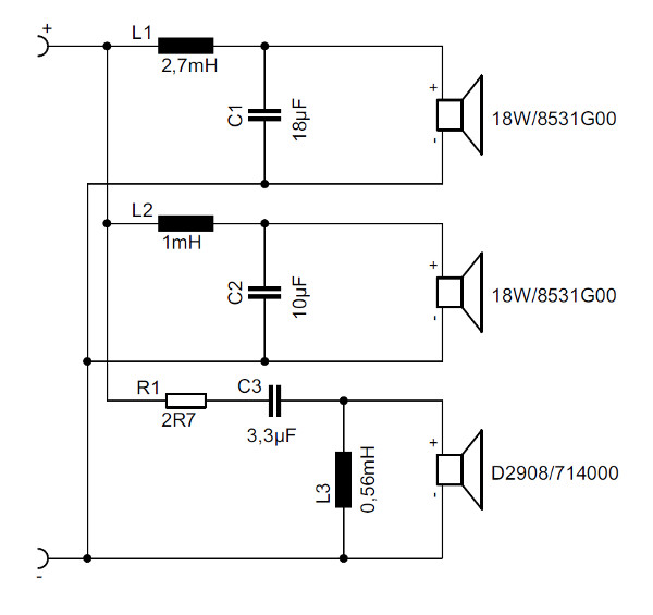

The 3.3uF and 0.56mH is actually the sort of thing you'd use with a waveguide tweeter. The Be dome does seem to have a response like that, so I'd think it is quite accurate.

After a long break, I’ve resumed the Ophelia. Question:
1. Do I add the notch filter to both woofers, or just the 2kHz low-pass woofer?
2. Do the values of the low pass L and C change with the addition of a notch filter?
