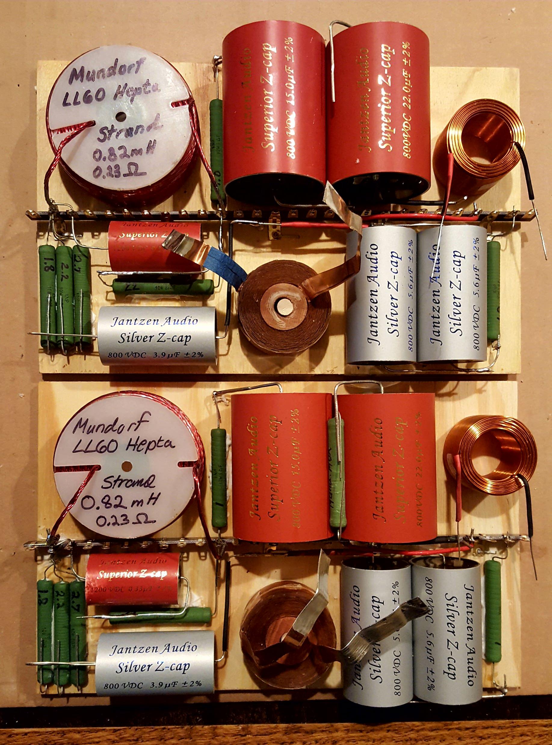

I have the the Illuminator 18WU in a 13" 3-way as a mid with the 66000 tweeter. Stellar sound, transparency, dynamic, 3-D imaging, smooth and coherent. It took 4 tries until the crossover yielded a coherent sound with balanced harmonics. The large mid-cap is 88uF Jantzen Superior Z, and the tweeter is Mundorf Silver Oil + Audyn Reference. (Photos shown).
What the Illuminator 18WU excels in over the Revelator 18W is transparency, low-level detail, dynamics, and compression under high volumes. I use PP caps to tailor the voicing of any speaker. I the sliced-paper seem to benefit from Mundorf Supremes caps.
People are wondering about the 18W/8531G00 and whether it needs an LCR... Baffle geometry is vital and has to be tested as all simulations fail in this regard. Well, the 8-Ohm version is fairly smooth on most baffles 9-11" wide. It's reported to be very easy on crossovers, and the Klang and Ton article even sites this characteristic of this driver, making crossover design very easy. Furthermore, the slice paper cone breaks up any nasties that may result from a single cone geometry.

OK, I just re-read my own crossover design using the 18W/4531. I'm sorry I was mistaken. At least in my design, I could have done without either....but!.... I ended up leaving the Zobel and notch filters in due to the incredible phase match with the tweeter.
Sorry to have confused.
I have said before though, that it is an excellent driver, and much much easier to mate with a tweeter than the published FR would leave you to believe.
Again, I think achieving this simple of a design in a 2.5 way is quite a feat though! 🙂 What limits the driver has with compression compared to the Illuminator are most likely taken care of by the use of 2!

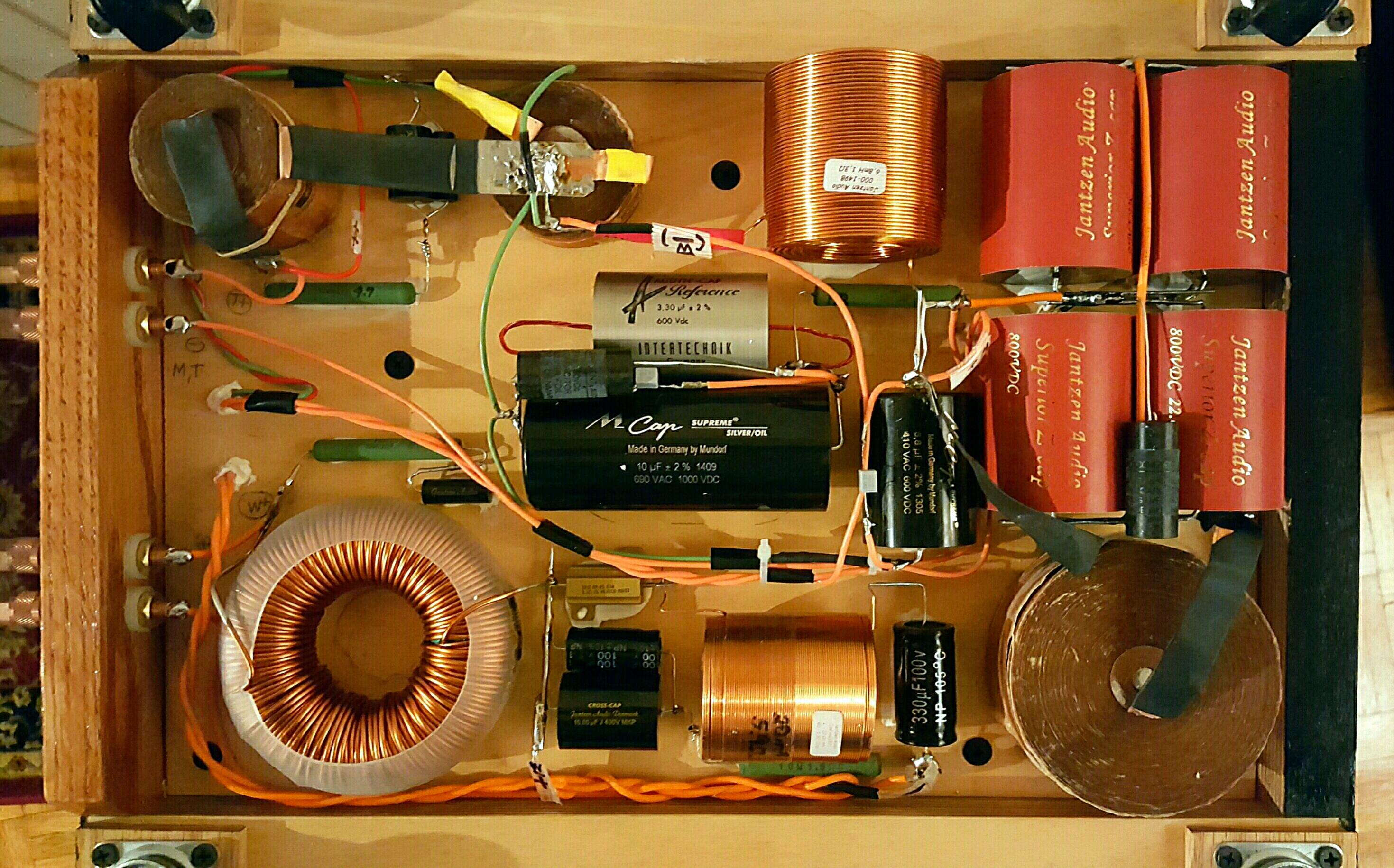

Hi Shure, I remember your thread. I'm stuck having to build the D'Appo to completion because already I had already cut the front cut, and had all the parts. Troels has "tweaked" the crossover since by reversing the tweeter polarity since. I also have the 98000 tweeter, in case the XT25 tweeter is garbage. I plan on experimenting with several tweeter R values. Let's see what happens... I've finished the crossovers. (Attached photo).
Regarding metal music, or rock, (especially 1980s digital) sound horrible on solid state and high end speakers with high end super caps. The glare is intolerable. So, I listen to 1970-80s music on LP and on tube geat. Much better on the ears.
