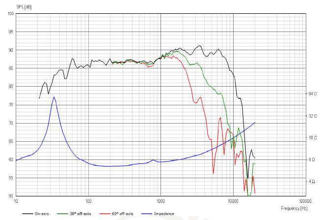

I have actually knocked it into shape. Which, IMO is doing considerably better than US Zaph or Scandinavian Troels Gravesen, who frankly, landed flat on their backsides with this one.

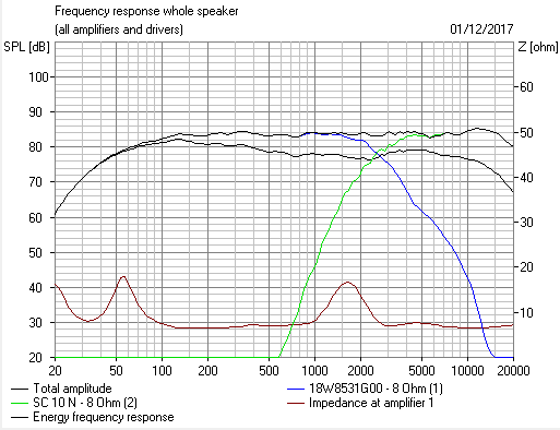

Observe the comfortable 2.5kHz higher crossover. The lack of shout on vocals. Clever stuff. We don't care if it's MT or MTM or MMT. You can't teach that in school. I throw in Boxsim's import modelling from Zaph's own measurements to assure you I am not completely off the wall. 😎

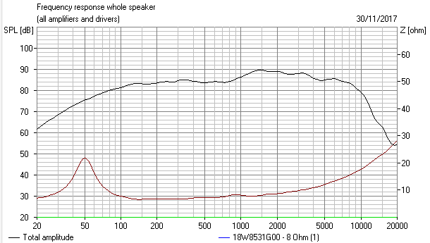

My specific "concern" or, er, "issue", in the current C21 politically correct and inoffensive gibberish language, that we have so got used to that we don't question it anymore, is that the Scanspeak 18W-8531-G00 Revelator is a dreadful overpriced driver. Rubbish. Poor. Wrong. 😱
I mean, there is a lot to like in solid cast chassis, copper damping rings and low inductance. But really, getting the kids to slice the cone with a Stanley knife and glueing it back together before I get home to notice, is testing MY patience. 🙄
But maybe hardware problems are fixable in software. I found this so. I got rid of the Scanspeak's worst 1.5kHz midrange shout easily enough. But if I told you how, I'd have to shoot you. 😀
Clue: The dotted line is SS on a second-order filter. My simple fix is the solid line. 😎

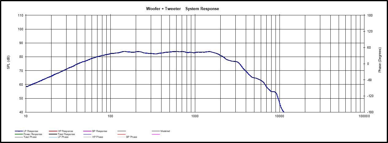

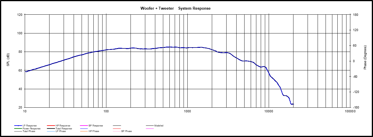

You mean a bit like this Steve?
This is using John's (Zaph's) measurements, but I quickly simulated a simple baffle & its step-loss + diffraction & added that in. I confess, I have had to use 3 components to hit this (roughly 2nd order Butterworth @2.1KHz) target slope. Not precisely the same acoustic slopes as your own, & it would need more work, but I only had a couple of minutes & if we're talking about 'knocking the 8531 into shape' it isn't a bad starting point.

Ophelia measurement seems flat on the #1 post if measured at 50" on axis ! Should be very smooth at listening position.
Many SS drivers have this bump above 1k to 1K5 Hz ! What is the origin of that behavior ! How to tame it in the filter? C//R in serie on the signal of the driver ?
Btw, have googled a little with this thread and indeed the Illuminator seems clearer and have further détails... But, all those high end speakers with Revelator are a good sign,no ?
There's a minor spike in H2 associated with it; that is usually related to an edge reflection and / or movement in 2 directions i.e. a minor discontinuity / resonance in suspension behaviour.
Depends what you're trying to do. In the case above, I simply used a conventional Rl shelving high pass followed by a shunt cap. The target slope & transfer function is sufficient to flatten it.

What are you thinking, 1.4KHz or thereabouts?
Actually I was expecting the crossover of the design to be higher than it actually it.
