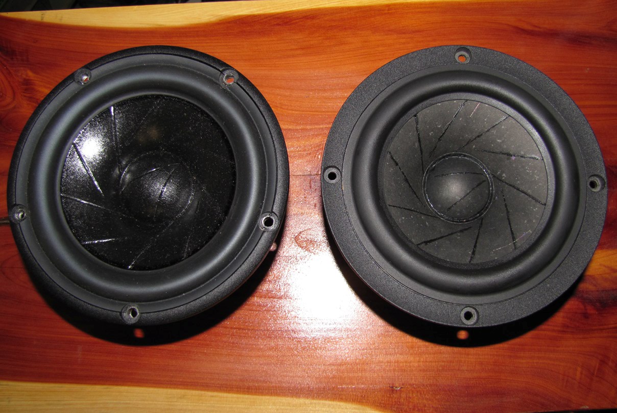

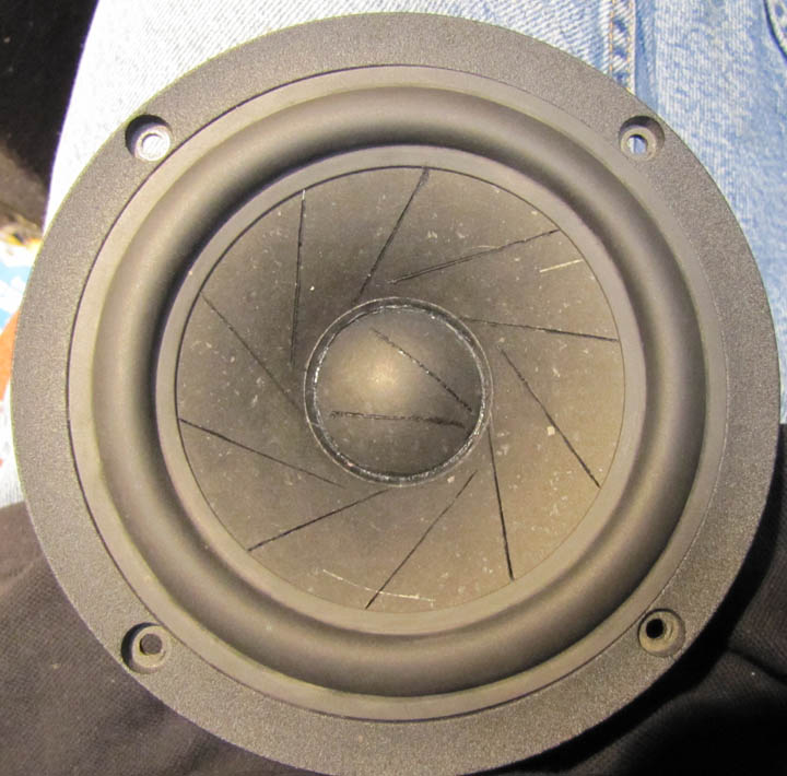

I got to do some cone-slicing again 🙂
Working on a 3-way (inspired by Troels PMS) and re-used some Vifa M13 mids. I wanted to do a 1st order (electrical) LP on the mid to get good phase tracking with the tweeter, but it had some breakup peaks from 7k and up that worried me.
4 slices per cone, and everything looked a lot better. Peaks were down abt 5dB.
This time I applied most of the glue from the back of the cone, and just added a little bit from the front of the cone dipping a resistor leg in the glue and using that to apply small amounts of glue to the front of the cone. Looked cleaner, and seems to work just as well. Now I just added a RC in parallel to the LP coil to slightly tame it further.

Wouldn't it be less nerve wracking to simply goop lines of silicon, or glue strips of a stiff material onto the cone? I vaguely recall there being a thread about this eons ago, might be worth a search
That is likely not going to work: as far as I understand, the slits interrupt the travelling waves in the cone, and thus should be gaps/open. The glue (or whatever filler) is primarily there to assure airtightness, and only secundarily as stiffner.
I would love to see some simulations of solid cone behaviour vs the same cone slitted.

I did it on a pair of SB13PFC's (I think it was). Breakup improved, but there was still some left. I added some coating too, and that improved it a little bit more. The speakers I built with them sounded pretty ok. Used them as front speakers for my surround system for a while, and now they are mostly collecting dust.. 🙂SB Acoustics SB16PFC would be a great candidate for this mod...
I actually found some pictures from the mod. FR before and after slicing, and how I sliced it. From memory dustcap did very little. Measured in baffle of the speaker, so it's a bit rough, but you can see the diff.
This is before coating though. I put some coating all the way to the inner fold of the surround. (Troels style, and as some manufacturers do). That smoothed out the dip under 2k a bit, I guess that was related to the surround.
