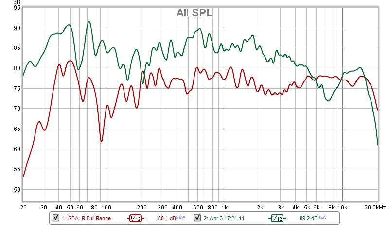

A quick measurement with REW from when the first speaker was ready for testing. The second is very similar (As expected), I'm still playing around with sub integration and plan to post more measurements when I'm happy.
These things play way deeper than I expected "in room"

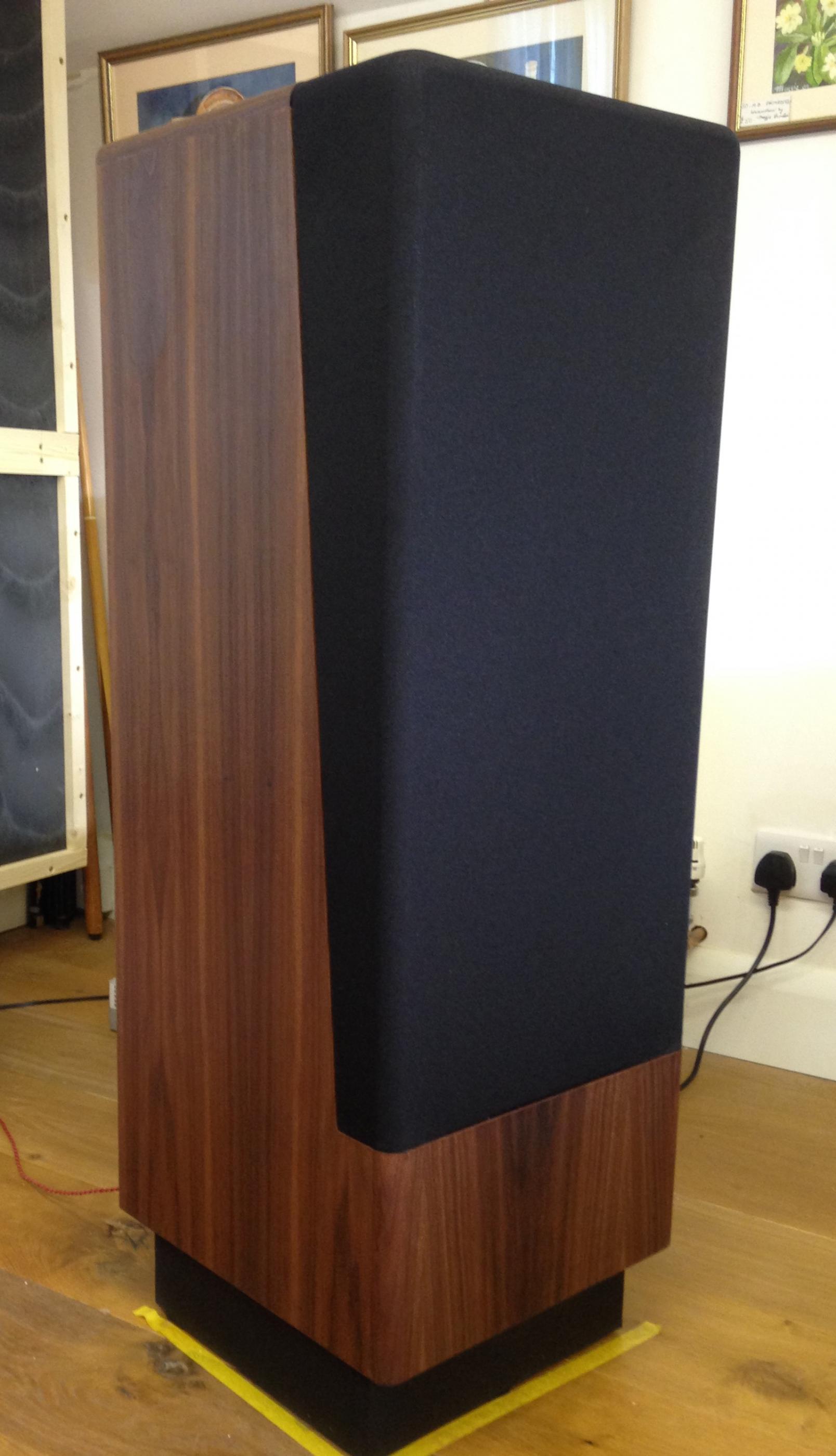

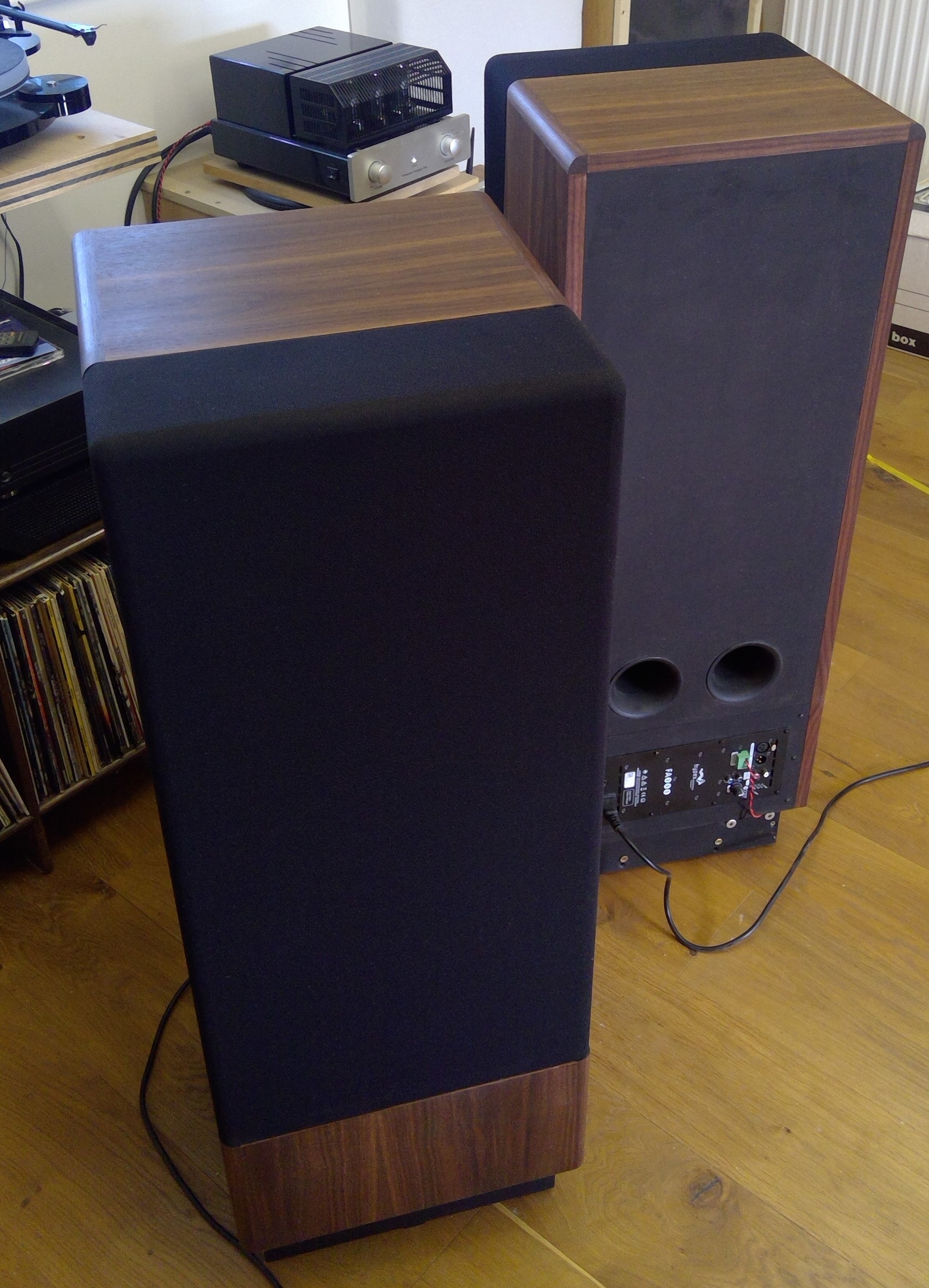

Anyway, thought you might be interested i built Troels Fusion BAD with Hypex 251, oiled walnut cabinets and a few rounded corners, otherwise like Troels design.
I only realised that everyone means it when they say the room is half the project, i have done some treatment now, not sure what the 8k dip is, i attached a sweep to compare with yours,

The only thing about my measurements that I find curious is that dip between 2 to 3 kHz. It isn’t present on Troels’ measurements and it seems to be equal on both of my speakers when I measured them. It sort of relaxes the presentation and is quite easy to eq out. Perhaps some more break in time will change it.
Without giving it due thought, I'd be wanting to cut 600-1500 instead.
Is it possible that Troels had included diffraction in his design that is easily reapportioned if you don't measure exactly the same?

If he did he doesn’t mention it. My build uses the same width and tweeter-from-top distance as the original. I did put a very small radius on the front corners to halt chipping but only 3/8”
I guess I was implying that if you strive to obtain an indicatively similar measurement to Troels, it could help to clarify the issue. The way you measure can potentially make at least this kind of difference.
I see. Thanks for circling back. I’m going to repeat my measurements in a week or so after things have had time to settle in. I’ll post them when done.

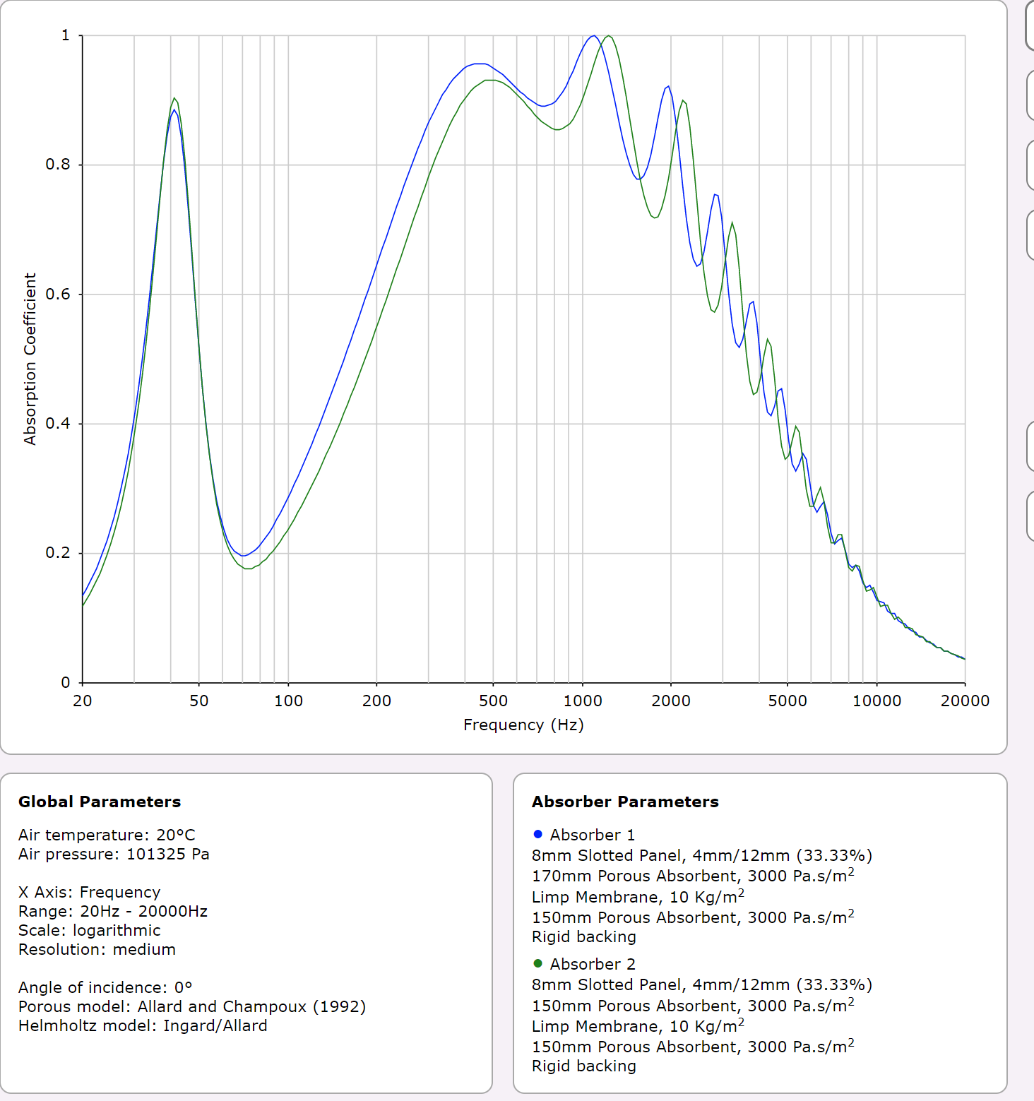

A few points, i also am after improving the 600-1500 rise, it is discernible as a bit of harsh/brashness in a quite important mid range area, female vocals, trumpet, piano, i have calculated a Helmholtz resonator, which i will build in front of my LM absorbers so that the same area does both mid and bass, my calc. looks as attached.

Yes, those are beautifully finished speakers. Just out of interest, do you have any photos from the front without the covers on?

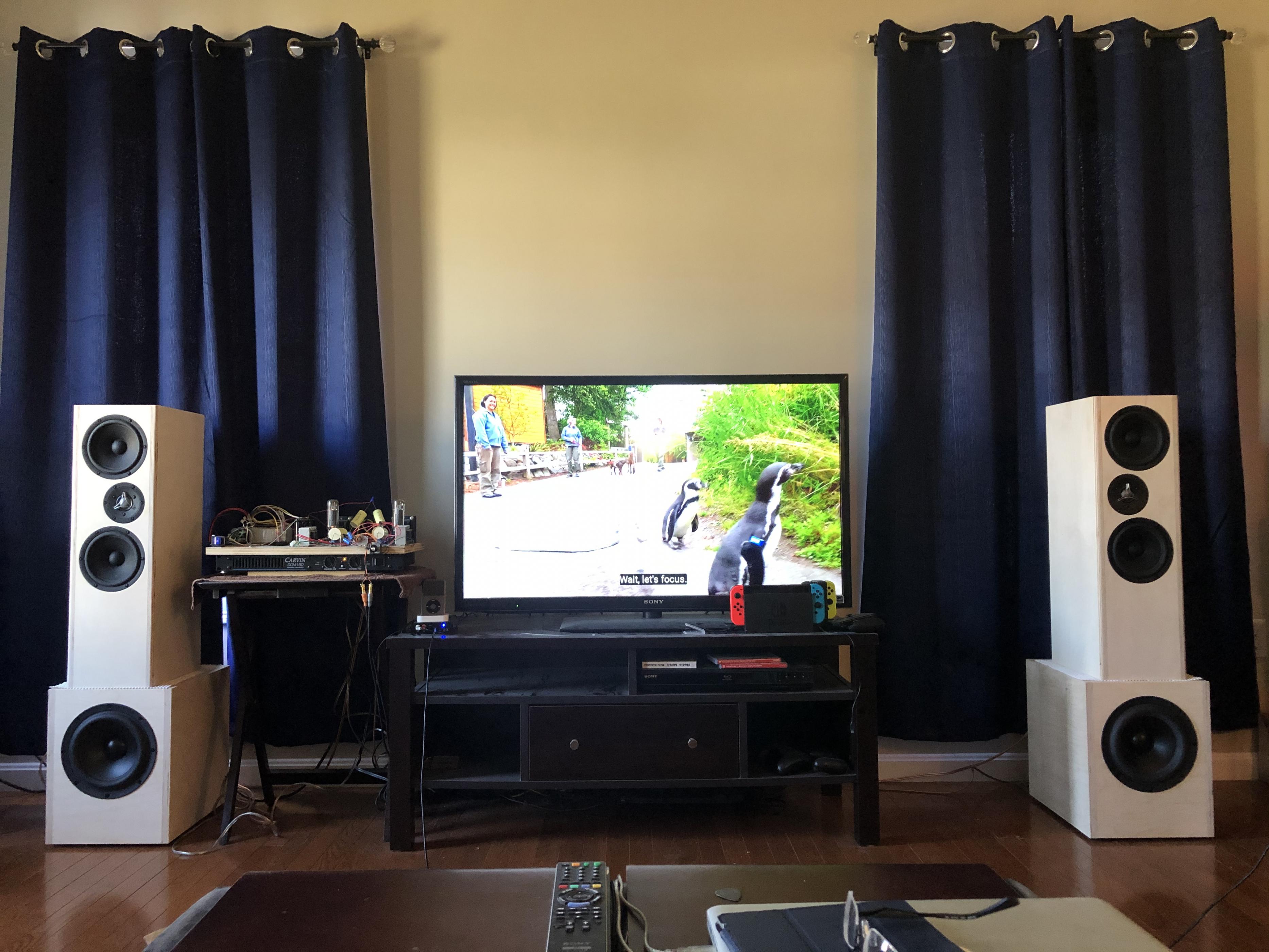

After some more mileage and a little tweaking on sub integration here's a new measurement. The MTM by itself gets nearly as deep as it does with the sub. This file is with a 65Hz 24bd/oct LR crossover (done digitally). This is left side only. It sounds good and doesn't display the 2-3khz dip mentioned above.
That's interesting to see, overall quite a flat FR, but I can get really quite confused with REW and often allow myself to conclude something, probably because i want to, rather than because its real, there are quite big peaks and nulls in the bass area, my guess is that with the mic in a slightly different position it can change the plot a lot, so until your room treatment can "cope with" or negate that you are still going to hear it, emphasised and nulled notes. i often play test tones, constant tones and move round the room and hear the peaks and nulls as well as sweeping through the range and sitting still, pick one of the peaks or nulls shown and play that tone and see what happens, then what to do about it is a room question, as Troels says, the room is half the project, and that's what i am working on now, my conclusion is that his speakers designs are likely exceedingly good and my room is not!
Have you looked at the waterfall for this, maybe someone with expertise could advise what they think of that, it would be educational for me.

Here we are Alex, with the current lock down they might get a new coat of oil as well! - i just added the taper top to bottom on the grille and rounded box corners, but baffle is as Troels designed.
BTW, i am an enthusiastic amateur and find i can enjoy projects and results where hard work rather than expertise makes the difference, i used a really great service to cut the parts, having worked out that i could not transport the big sheets myself i used a company called cut list to do all the main cutting for the cabinets, that way you pay a little more for the wood but get manageable sizes, cut square to close tolerance, they aren't far from you either, Oxford way.
