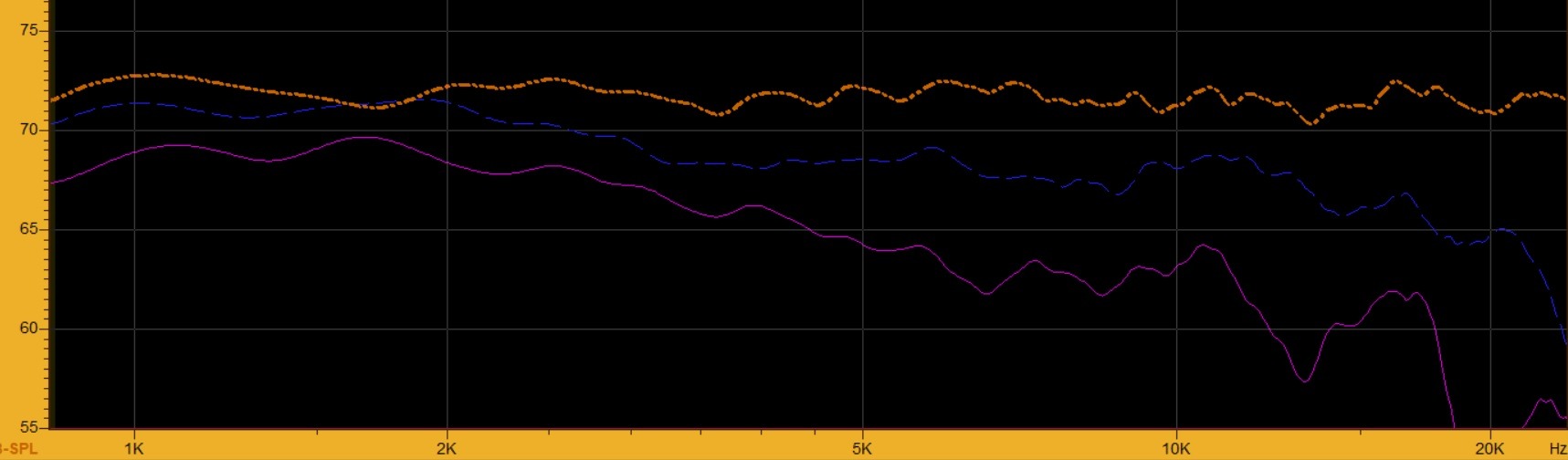

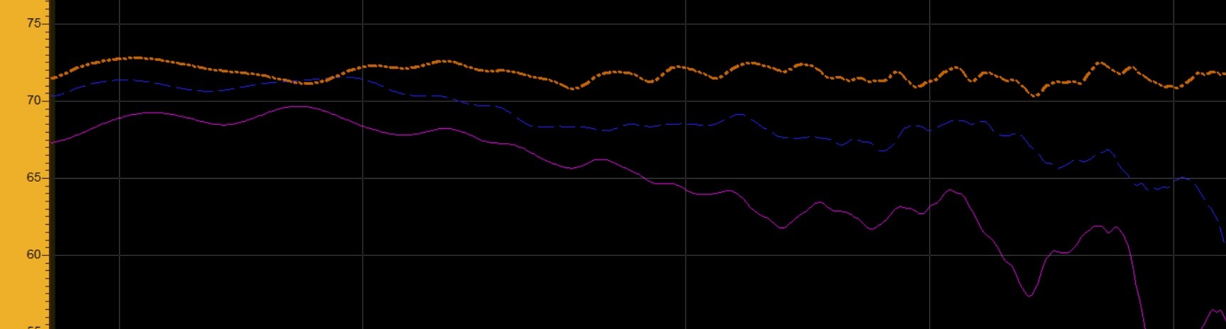

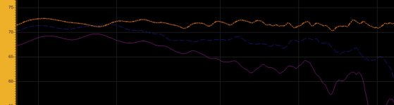

I tried the Bliesma T34B against the Seas DXT on top of a MW16TX at a friend's place in separate boxes. I clearly liked the DXT instead of the Bliesma - mainly because the Bliesma sits on top of the faceplate, "illuminating" the room with reflections all over. The DXT gave a much more precise and centered sound stage with that nice phantom center I like. This is why I replaced my RS125 as midrange and kept the tweeter.
We of course measured and EQ'ed before we switched around. I know it's not blind... but I'm very pleased with the Textreme/DXT combo - I just chose the MW13TX, since I found it theoretically easier to mate with the DXT and obtain a smoother directivity. Crossover is LR4 at 2kHz.
Maybe it's difficult to see, but there are three lines - one for on-axis, 20 and 45 degrees.
No smoothing and simply lifted the speaker up in the middle of the room and using gating with around 3ms window - duvet on the floor
