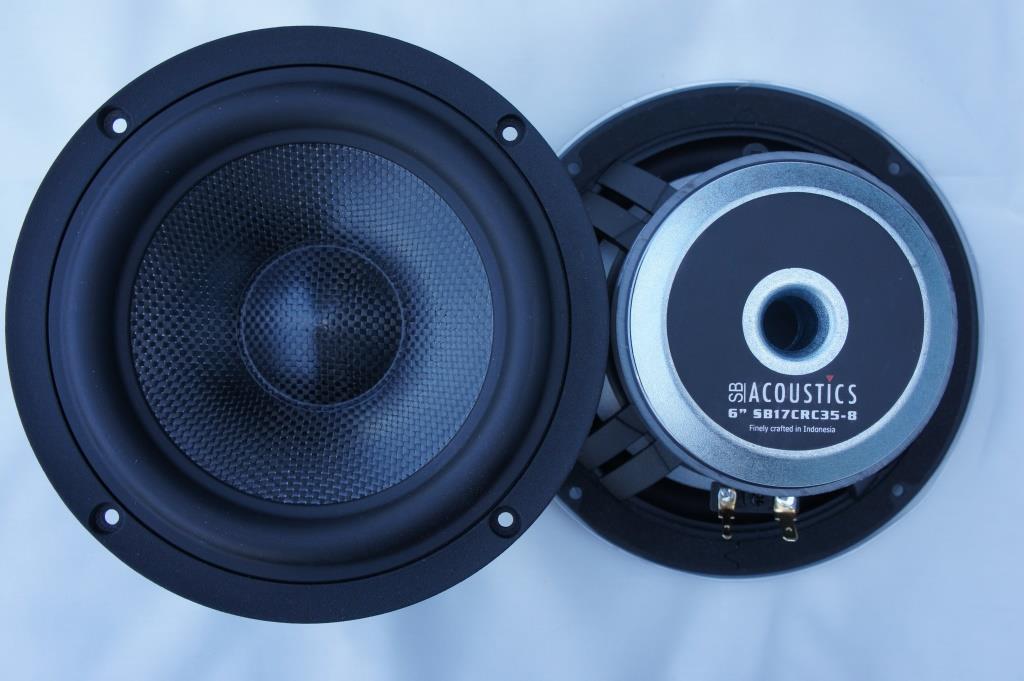

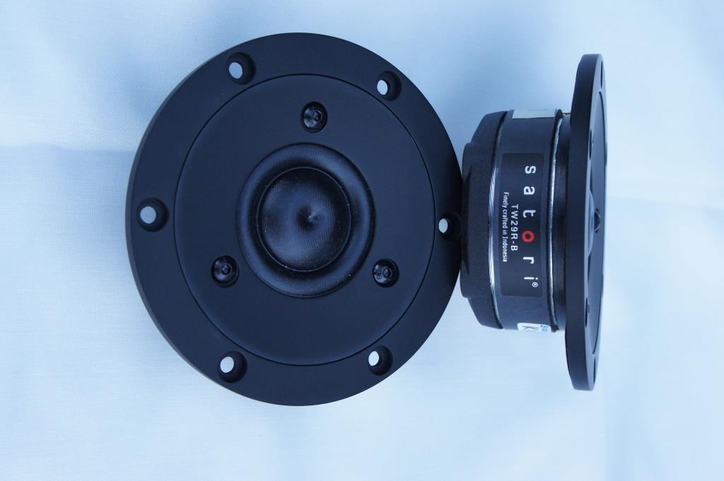

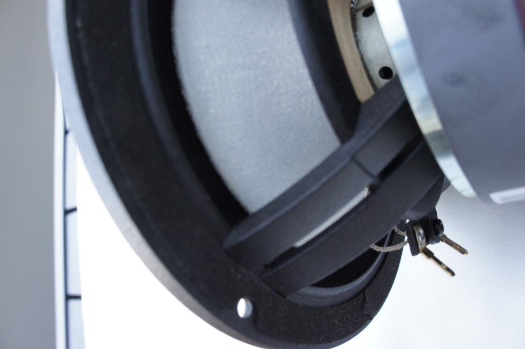

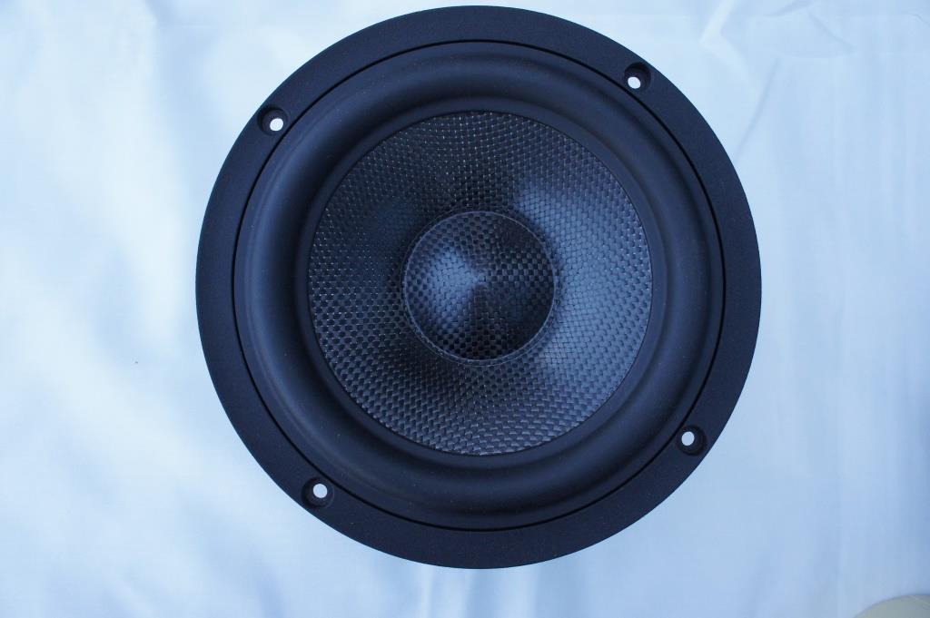

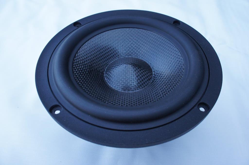

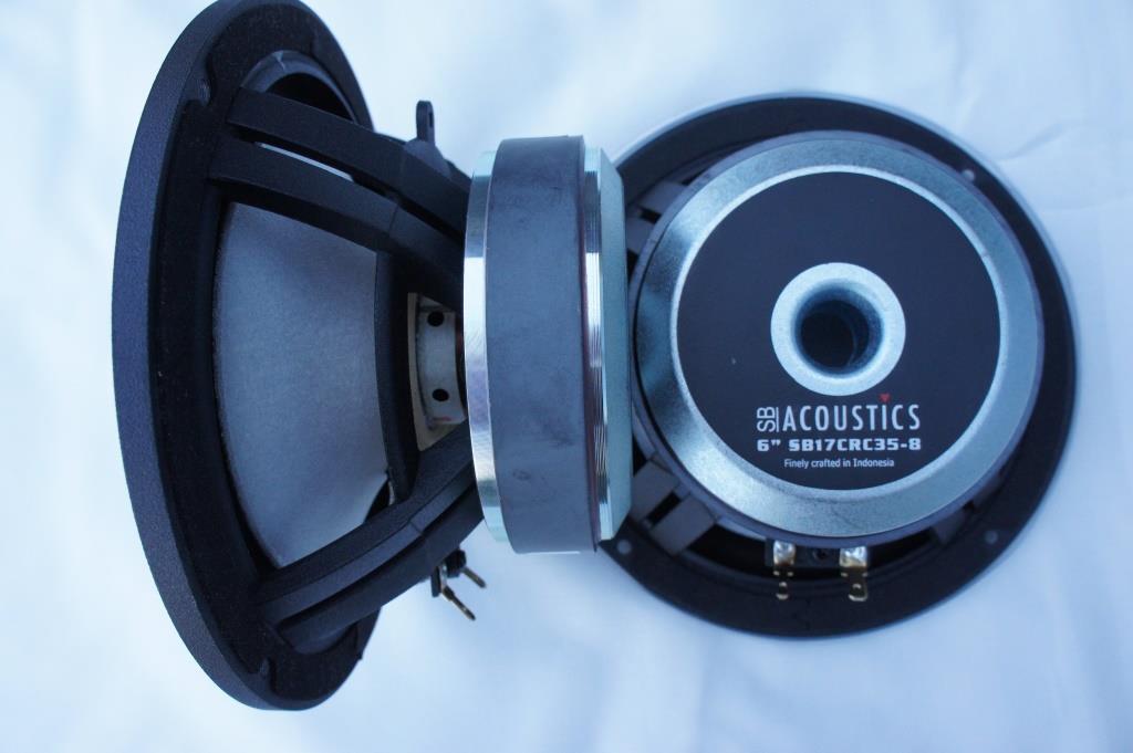

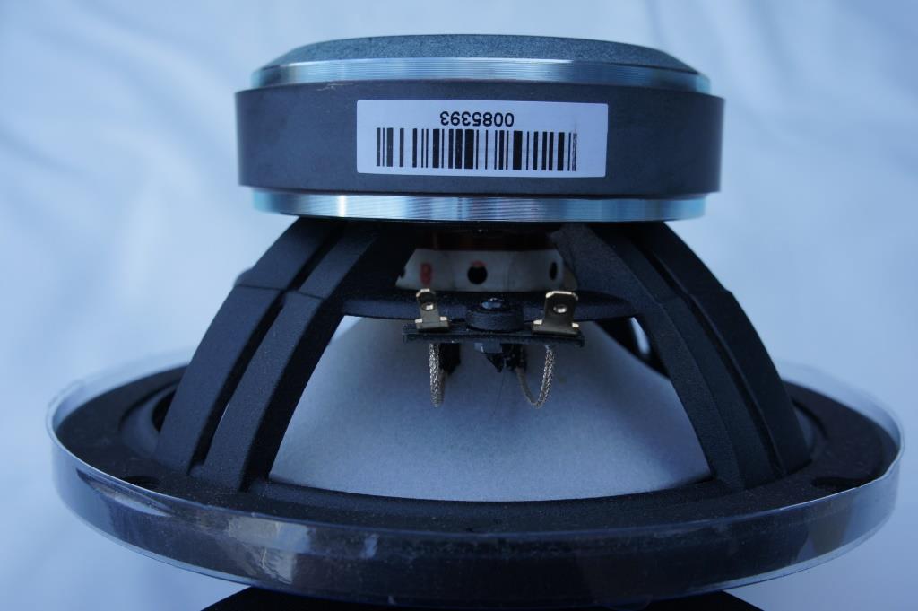

I picked up two pairs of SB17CRC35-8 "Rohacell/Carbon fibre" mid-woofers and a pair of Satori TW29R-B tweeters today.
It will be interesting to see how it measures compared to the aluminium cone version.
The carbon fiber cone looks a bit sexy. 🙂 The sandwich cone is rather thick, an estimate is about 4-5mm.
The tweeter also looks nice, but the dome is a bit sticky and it's collecting dust as soon as it's unpacked.
Hopefully I will have some measurements after this weekend.

The CRC looks to have decent bass extension; paired in parallel should be pretty nice 😉
Sexy indeed!

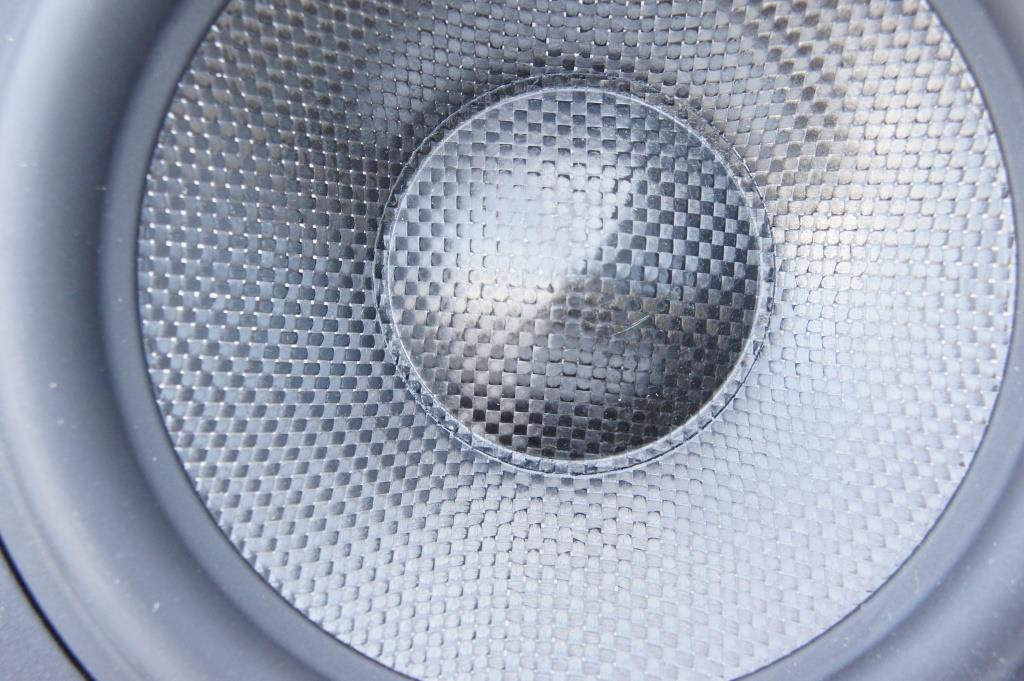

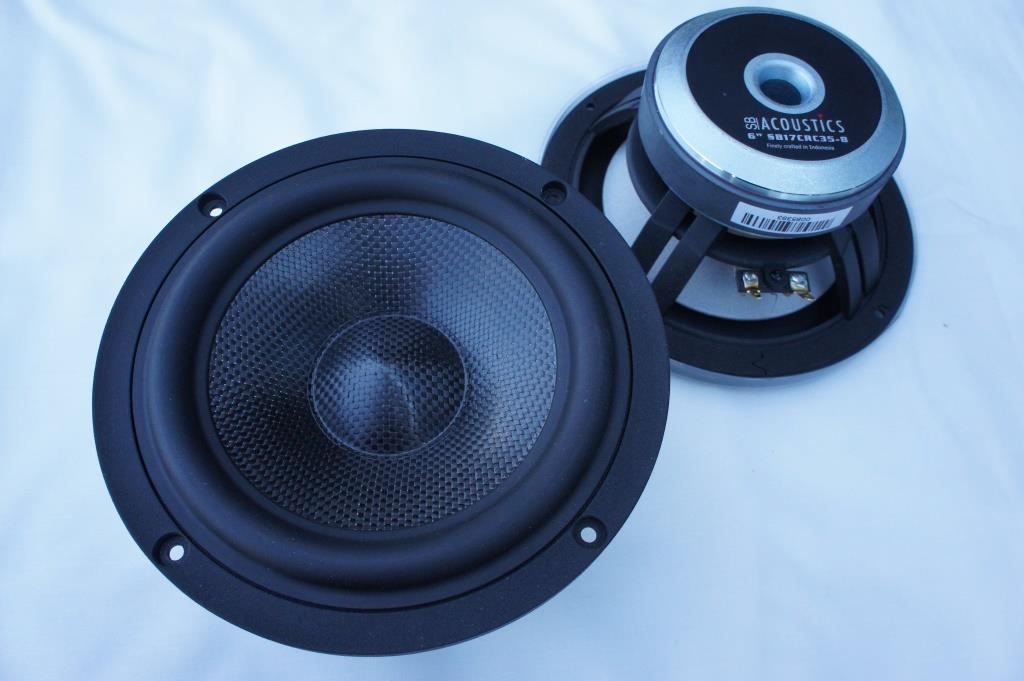

How did that third picture come out all silvery? It is the same driver as the first two pics, correct?
Sexy indeed!
Yes, it's the same driver. I'm no photo expert and when I zoomed in the light condition changed. I just wanted to show the structure of the cone surface.
The other photos show the true color.

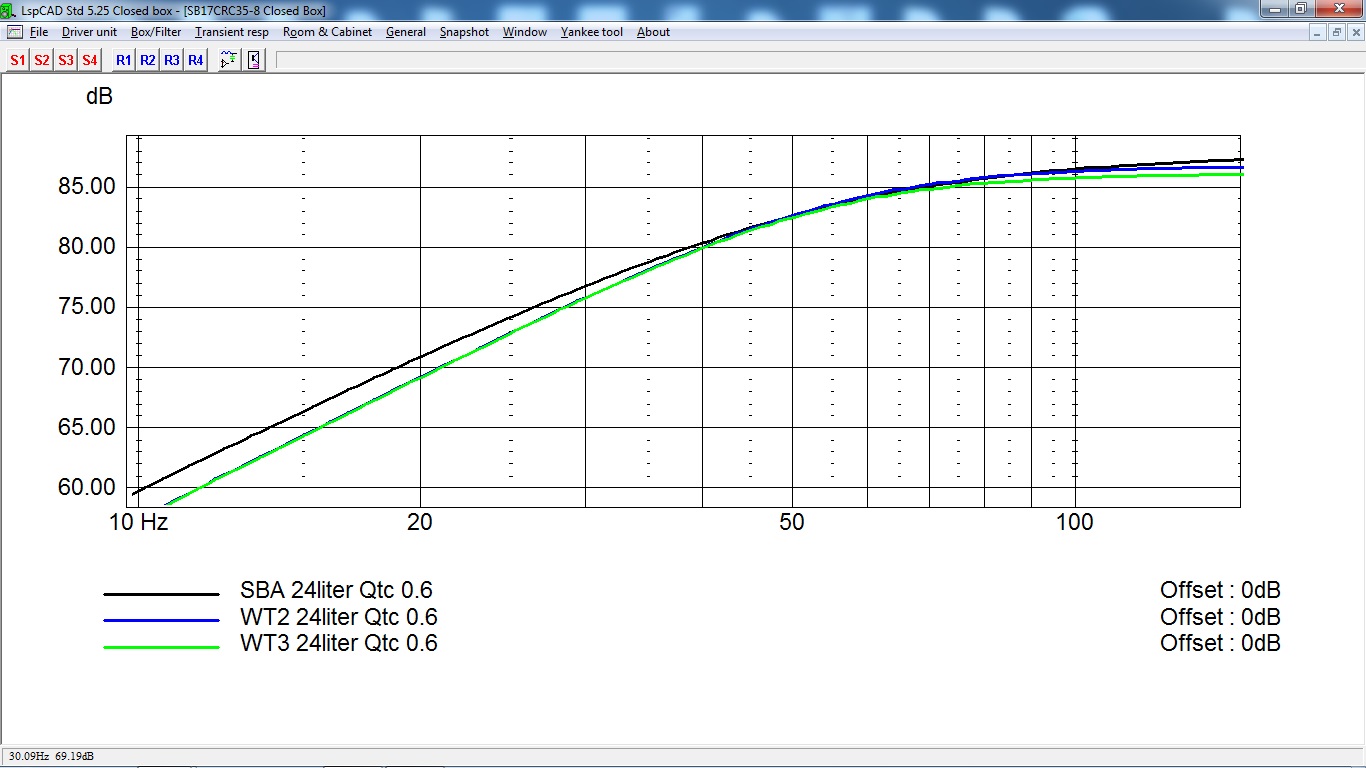

Yes, that's absolutely correct.
Usually SB acoustics are fairly correct in their official specifications compared to many other manufacturers. Personally I think many people focus to much on box size calculation theories compared to the rest of the loudspeaker design process. 😉
Most drivers are pretty flexible regarding box volume and port tuning frequencies. In this regard the loudspeaker can be tuned to fit personal taste and room placement etc. With that said, you can't go wild up or down in box volume or port tuning, but +/- 10% or more from e.g. a theoretic QB3 alignment isn't a problem in my experience. Also, many forget to add the series resistance from the x-over in the box calculations, which has an impact on the T/S parameters.

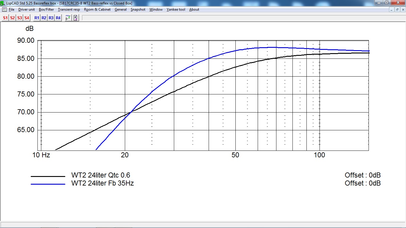

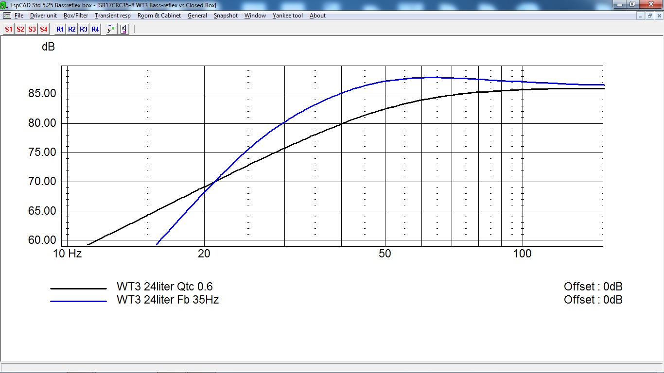

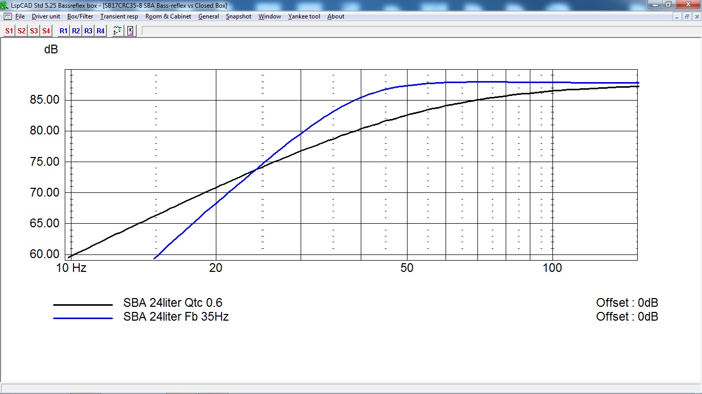

Here's some quick box simulations and as everyone can see, in real world such T/S parameters difference on paper doesn't really matter much.
SBA = SB Acoustics official specification.
WT2 = T/S measurements done by Smith & Larson Audio WT2 woofer tester.
WT3 = T/S measurements done by Dayton Audio WT3 woofer tester.
