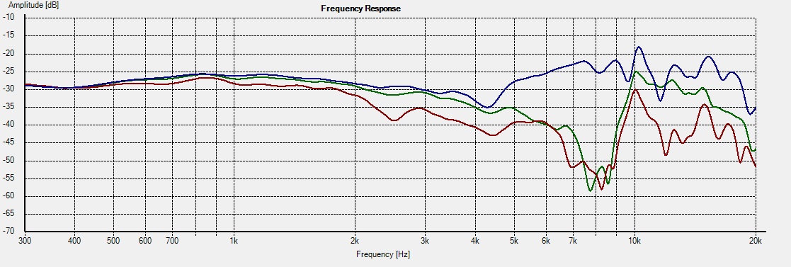

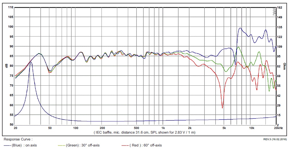

I don't know if its true, but if you trust the official measurement specifications the cone break-up seems less good on the 8 ohm version of the SB17NAC35 driver.
See attached pictures:
Picture1 = My measurements of the SB17NAC35-4 driver.
Picture2 = SB Acoustics measurements of the SB17NAC35-4 driver.
Picture3 = SB Acoustics measurements of the SB17NAC35-8 driver.
Blue = On-axis
Green = 30deg off-axis
Red = 60deg off-axis
The main cone break-up seems to appear at 7.5kHz instead of 10.2kHz for the 4 Ohm version. In fact a cone break-up at 10.2kHz is amazing for a 6" hard cone mid-woofer.
/Regards
/Göran

In your measurements there's a substantial dip at 4.2 kHz. Is this baffle diffraction related or an issue with the measurement conditions, or does the driver actually have a dip there?
No I don't think it's the baffle. SB Acoustics use an IEC 268-5 baffle for their measurement and the dip is almost identical to mine.
/Göran
