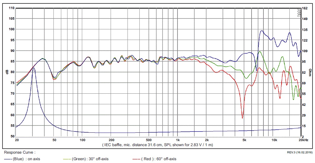

This new SB17 is really exceptional in my eyes. It's cone profile is almost flat at 3-5,5" which gives it uniquely flat treble and still it has low Fs. It should be all right also as midrange crossed say 3-400 and 3500Hz LR2 or elliptic/duelund.

Yeah the cone profile/design is very unusual, esp first picture in the thread.

It's cone profile doesn't seem like anything special to me. Still the usual off axis issues by around 2kHz that you typically see in drivers this size. It still needs a low xover to prevent any off axis issues - at least what I call an issue.
Just the perfectionist in me...You would not want to cross that high anyway for off axis reasons.
It's directivity between 2-4kHz will be perfect match with a shallow waveguide tweeter like this Monacor WG-300 and Vifa XT25TG by kimmosto Wave guides & horns
The viawaves have a built in waveguide, so this really interests me. A couple of guys over on PE are crossing them around 2.5khz successfully

2kHz is a good compromise for 6" drivers, but if you can go down to 1.5kHz then all the better.
