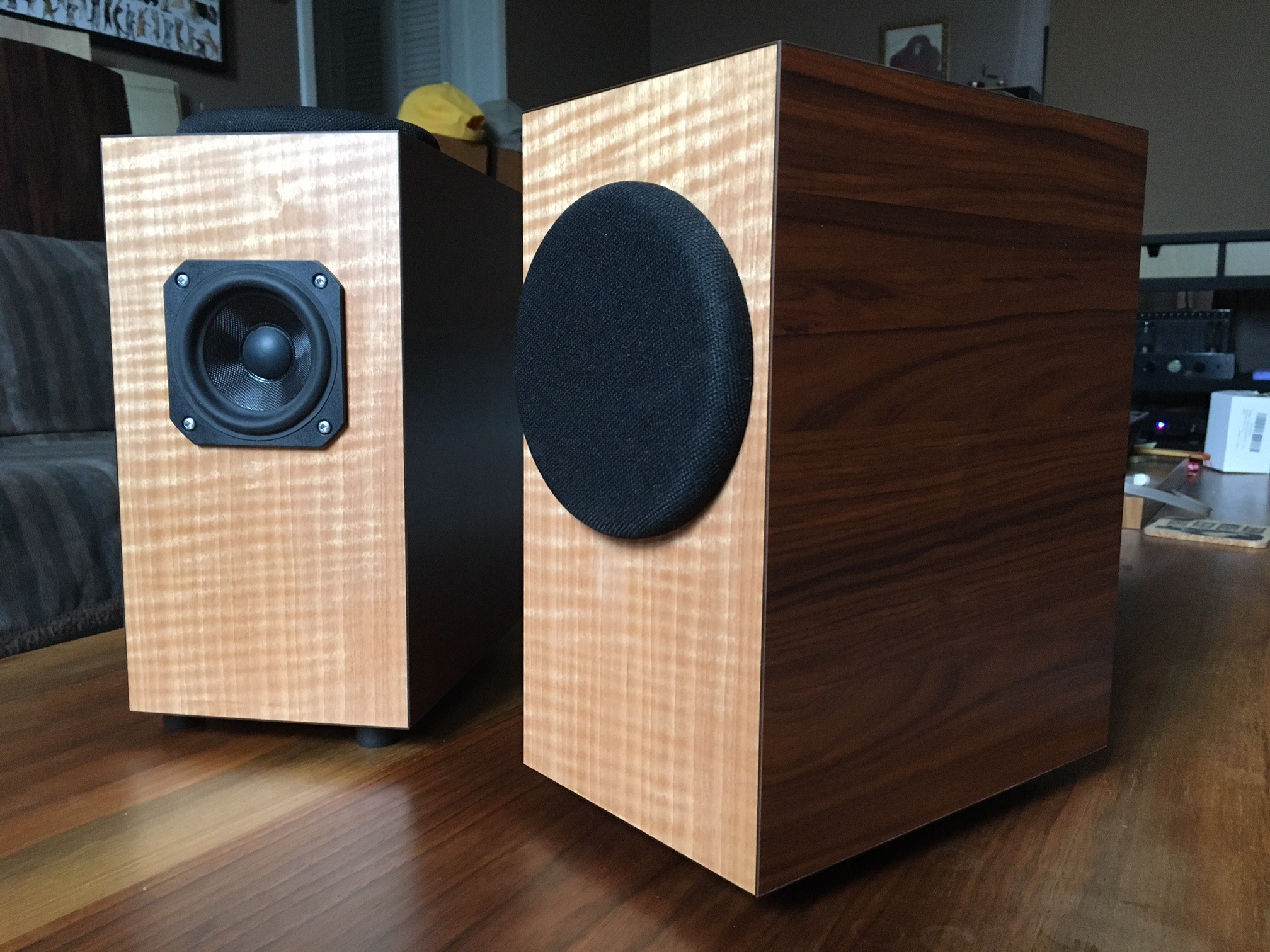

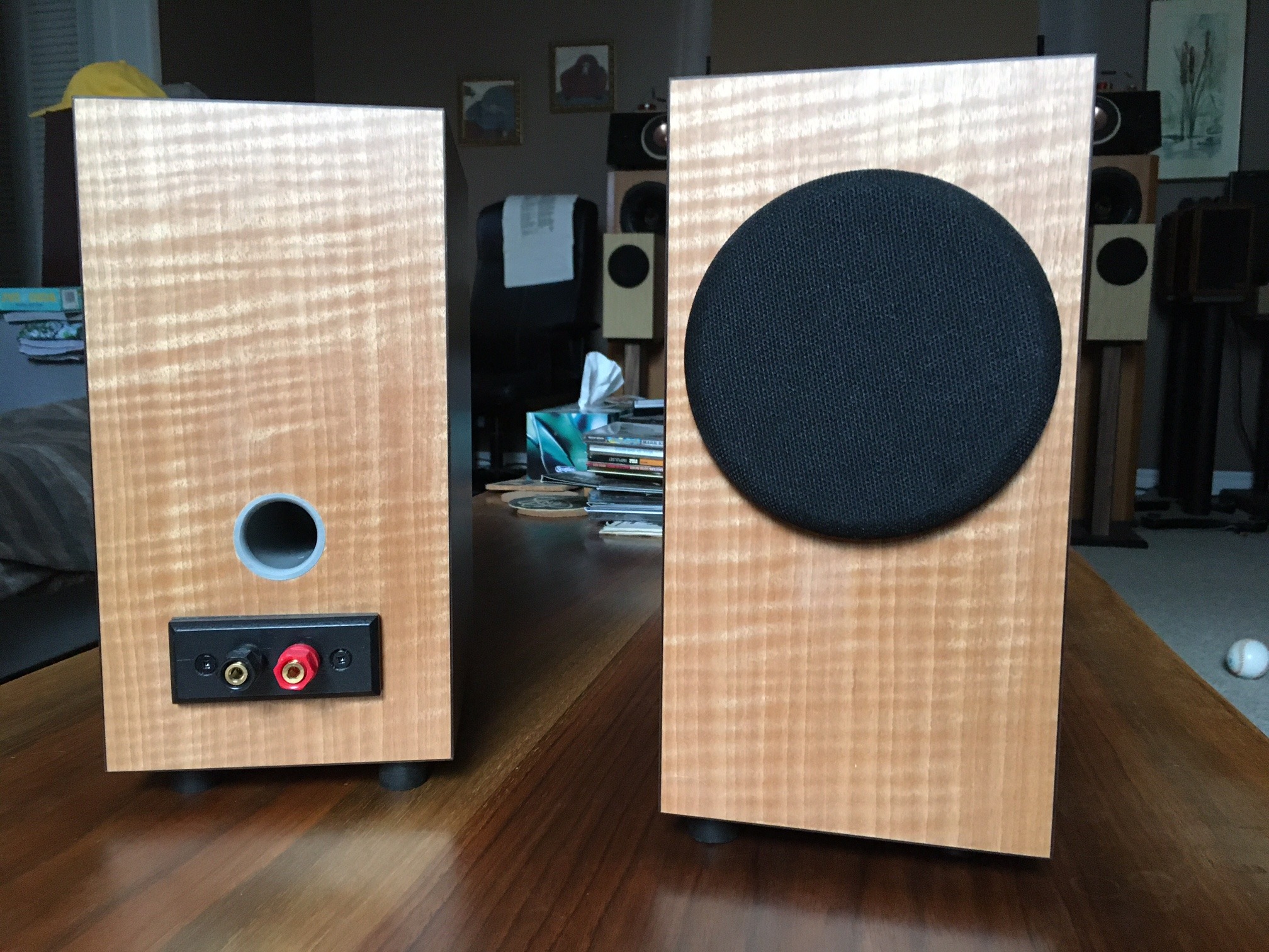

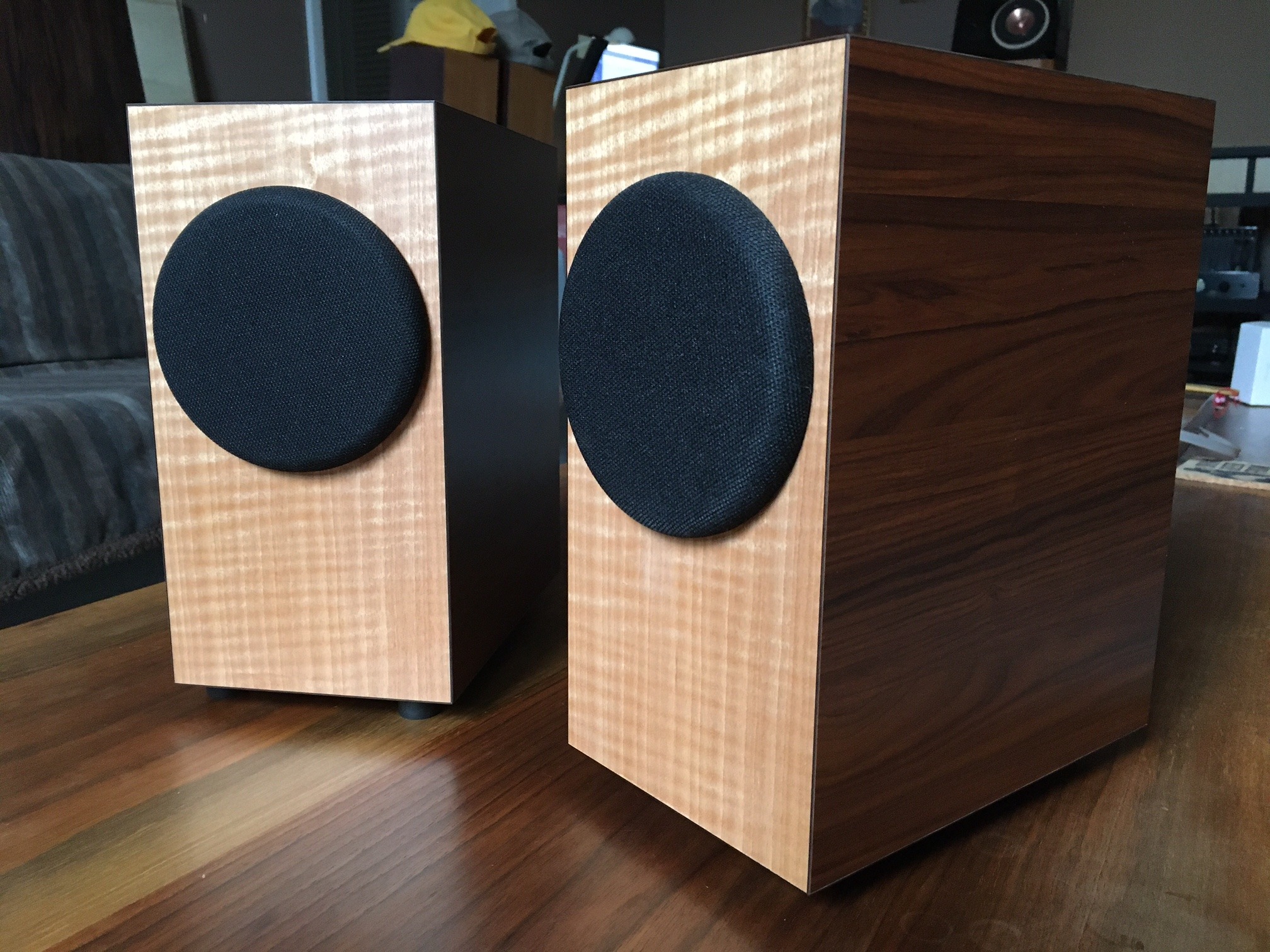

SB10 added magnets and Mod Podge treated dust cap in a 4.4 liter bookshelf. Sounding very nice!
Nice work.
The grain of the wood is beautiful.

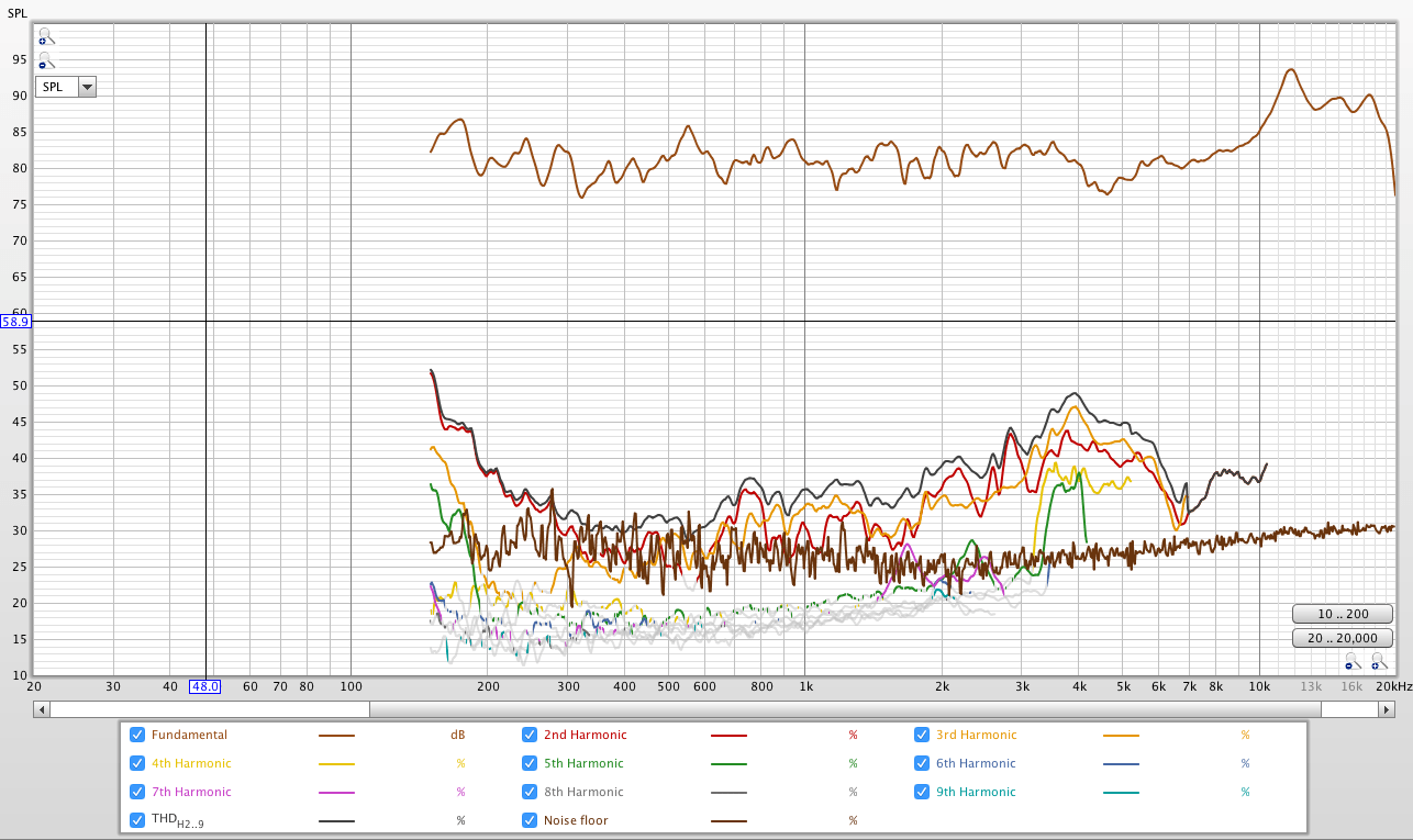

any of it took out the distortion peak at 4kHz, by any chance? 🙂

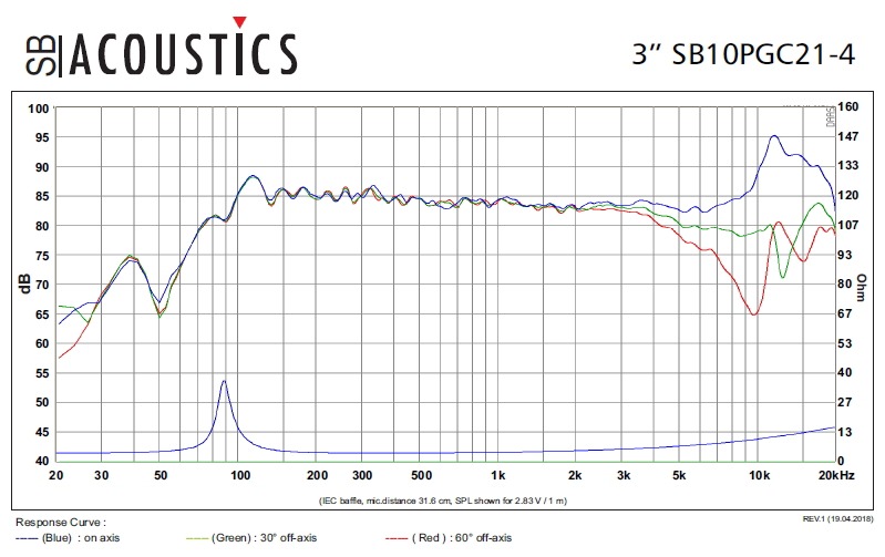

There's no peak at 4 kHz in either the manufacturer's published or measured values.
Looks very nice, are those the pre-made SB grills?SB10 added magnets and Mod Podge treated dust cap in a 4.4 liter bookshelf. Sounding very nice!
that's because there is absolutely no distortion is plotted on your graphs. Only FR and impedance from SBA.There's no peak at 4 kHz in either the manufacturer's published or measured values.

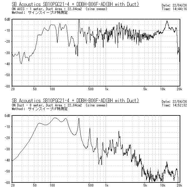

Here it is...
- Full Range
- SB Acoustics SB10PGC21-4 (3" Full-Range) / normal version and magnet added version.
