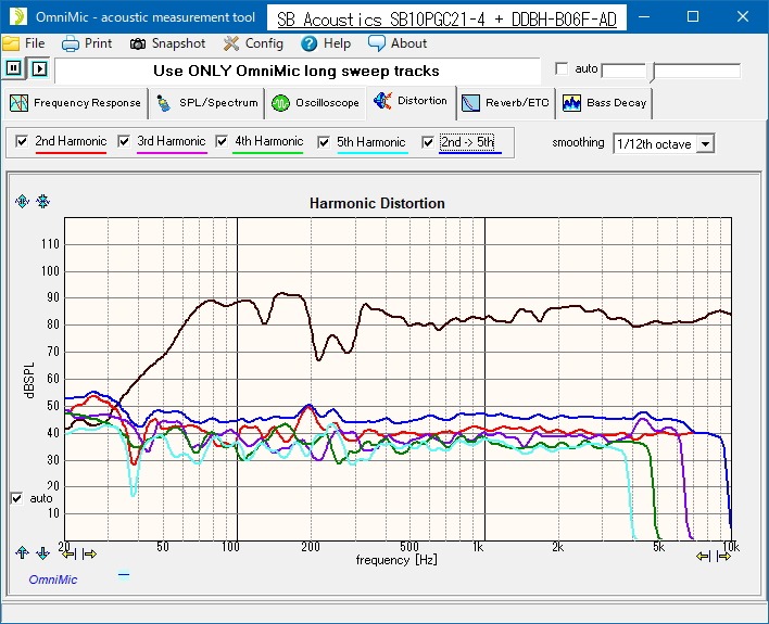

that's because there is absolutely no distortion is plotted on your graphs. Only FR and impedance from SBA.
Here it is...
I see, it's harmonic distortion.
There seems to be no peak at 4kHz in my environment.
Is it the effect of the enclosure or the room?
sorry, I did not try that driver.Ok, distorsion is high at 4000khz.

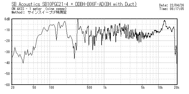

My FR follows the SBA published data a little more. Yours stops at 10kHz, not showing the breakup a little higher up.I see, it's harmonic distortion.

And you've got a chasm from 200 to 300Hz. Room related?

And the 4kHz distortion was measured in all of my 4 drivers I have here, in 3 different tested enclosures, so I do not believe it is related to a design or a room.
It seems that the measurement in OmniMic's Distortion mode only shows up to 10 kHz.

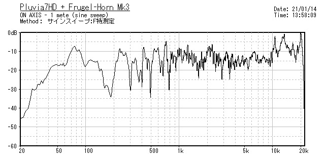

When I measure BH and TQWT in my room, I get a big dip.
It is similar with FrugelHorn.
Try moving them around the room, until that dip disappear. Hopefully it will be in a good spot for listening as well. 🙂
I don't think it's a problem since other speakers are measured under the same conditions.
In my hearing, the dip doesn't bother me and it sounds good.

if you placed all your speakers at the exact same place, it's normal that your room will behave the same, so same dip.

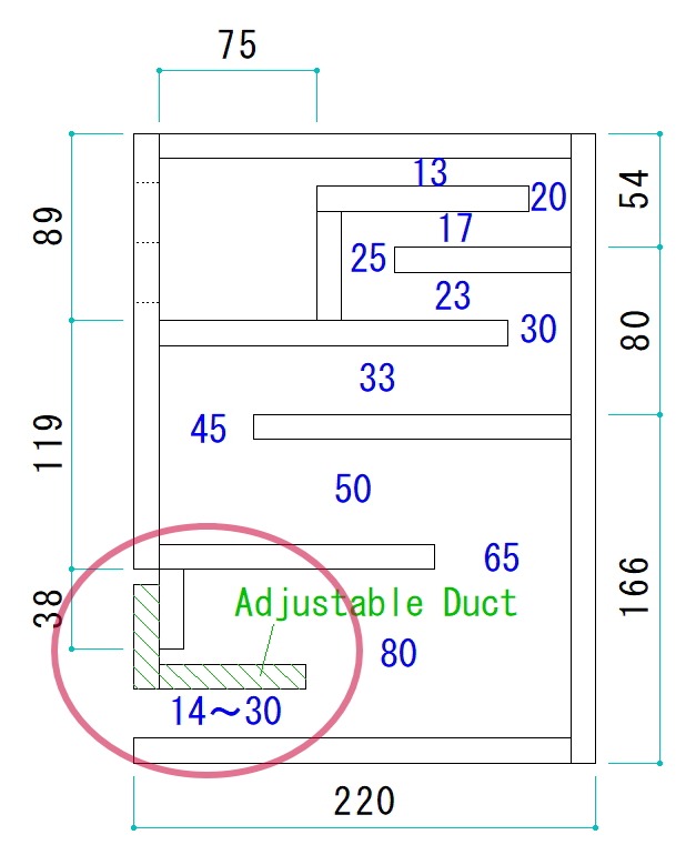

I apologise for this small divergence. The speakers above seem to have a mass loading plank over the exit. It interests me that it creates 2 separated exits, one narrow and one wide. If I am right, is there a logic to this?
That is an adjustable port.The speakers above seem to have a mass loading plank over the exit. It interests me that it creates 2 separated exits, one narrow and one wide. If I am right, is there a logic to this?
The top slot is just clearance for the port to slide open.
