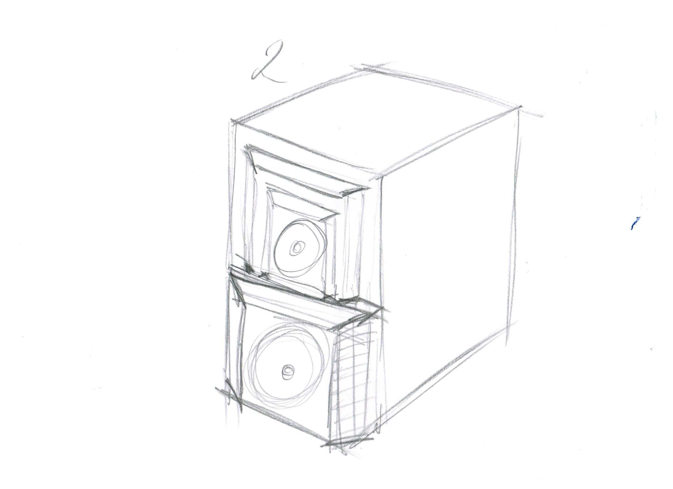

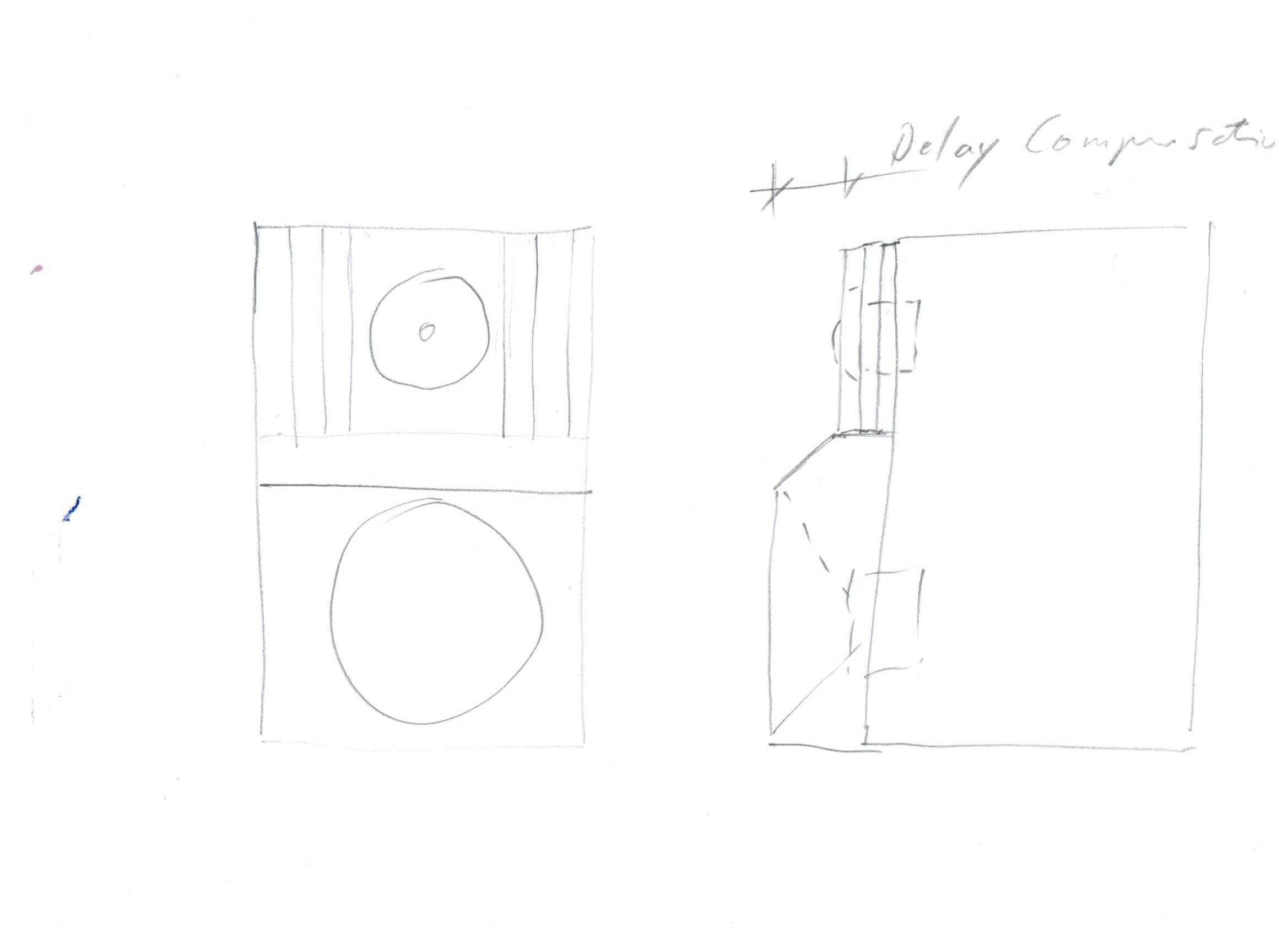

Here is my design for an easy to make cabinet that looks good and does the Job as well.
The baffle is staggered and allows delay compensation between the tweeter and the woofer. Diffraction is scattered so the cabinet has less influence on imaging clues. The second version has chamfered edges and should work even better. The edges can also be rounded.
Design number 1 can also be modified by putting felt around the staggered elements making the tweeter baffle flat in essence.

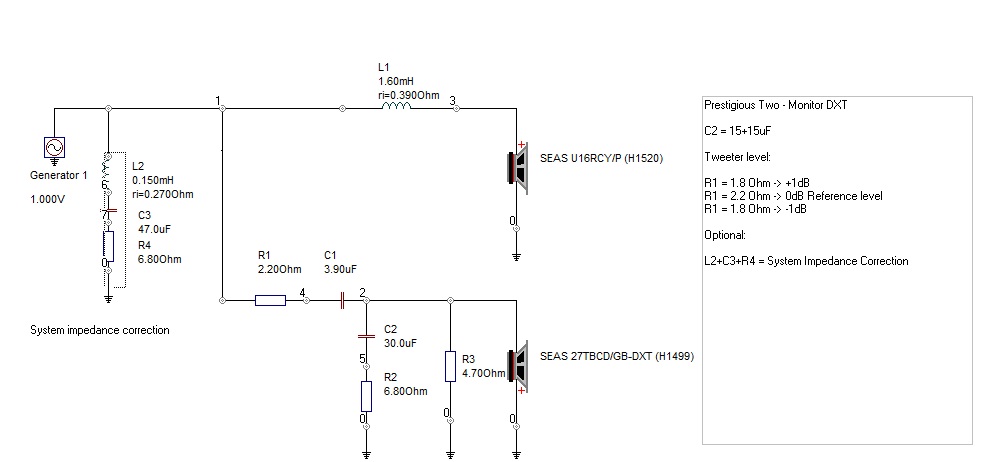

Here's an example:
Sequence Two – Monitor
Sequence Two – Monitor BE
Regards
/Göran

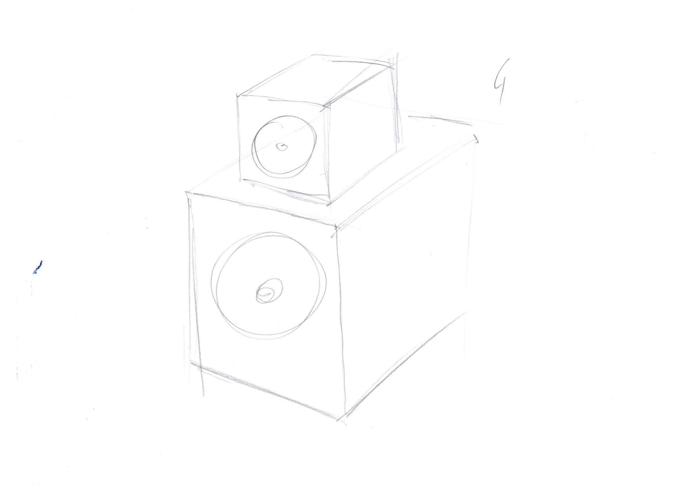

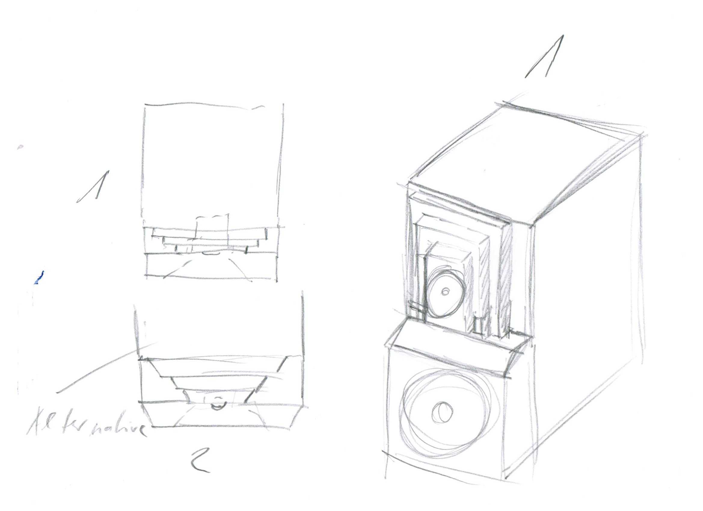

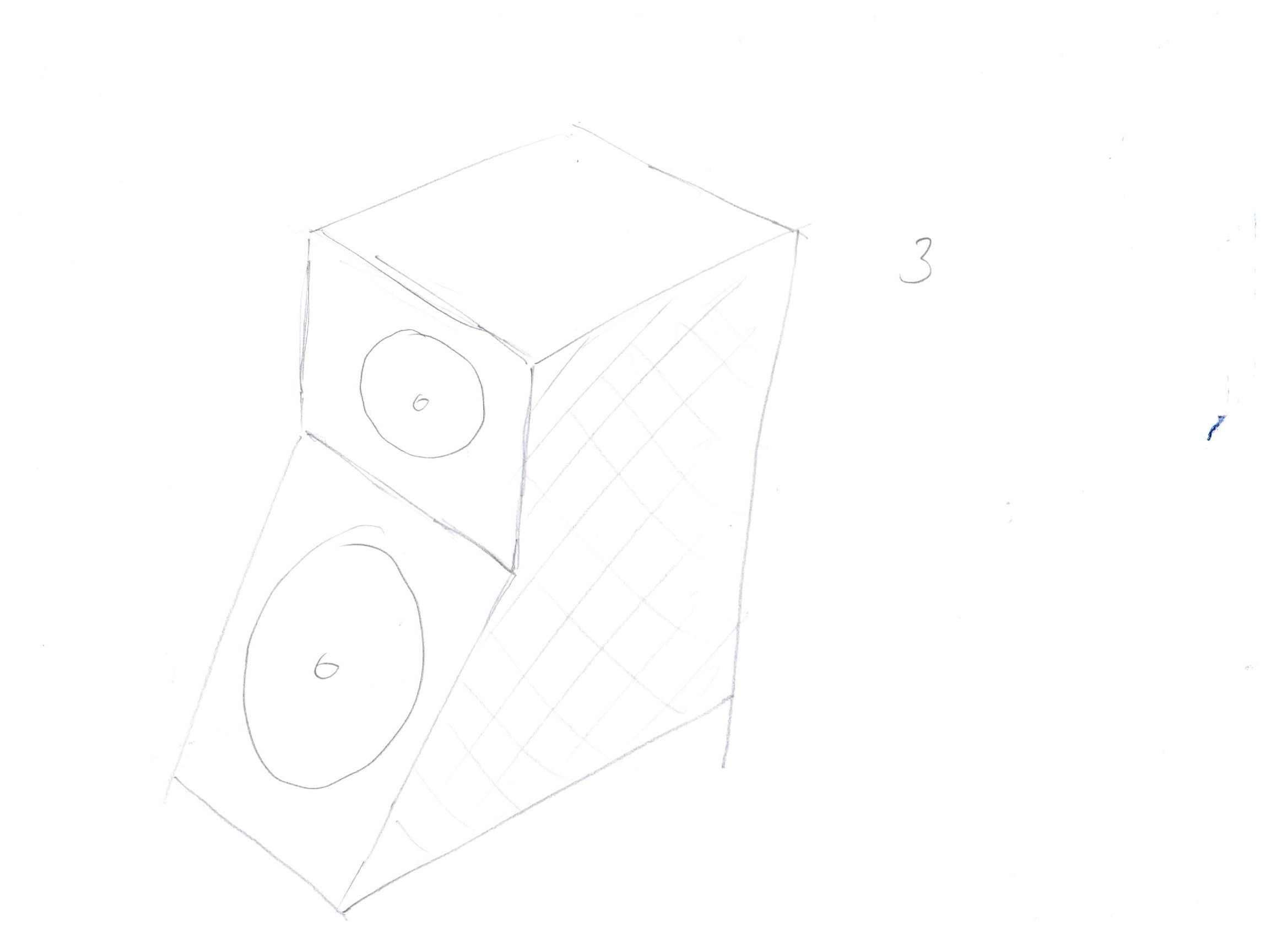

Here are some other ideas. Two of them are modular.

If using a flat baffle together with shallow sloped filter the way to go is a tweeter delay circuit or a tweeter waveguide or horn to get a “time coherent” loudspeaker. Another way to do it would be to time delay the tweeter actively.
Time delaying the tweeter mechanically also works fine, but could give other issues like diffraction. The enclosure design 4 and 5 could be problematic regarding diffraction and enclosure build complexity.
My suggestion of a “time delay circuit” was just a humble question if it was something you had consider as an option. Clearly you have decided to go with the “mechanical” way and that’s great and I do like the stepped baffle better than the slanted way. 🙂

This is an example of a very simple cross-over using a true LR2 cross-over, without any delay circuit or sloped/stepped baffle.
