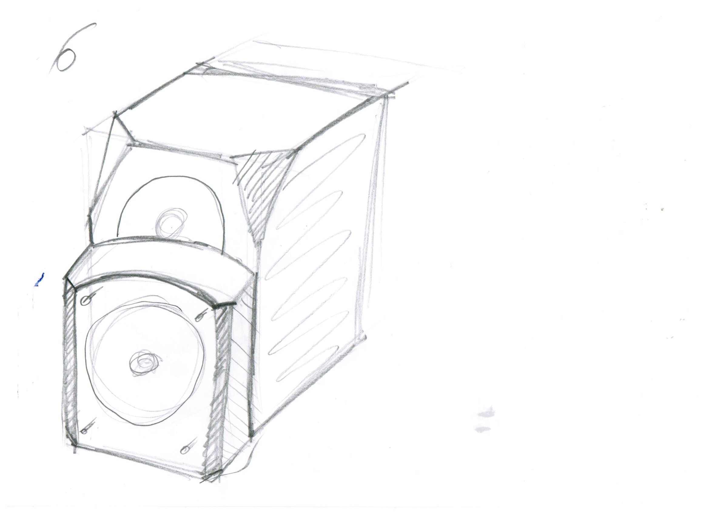

Here is another idea for a cabinet.
Yes, this one looks feasible, but I don't think you need the bevel on the tweeter baffle. Do the same round-over as on the mid-woofer.

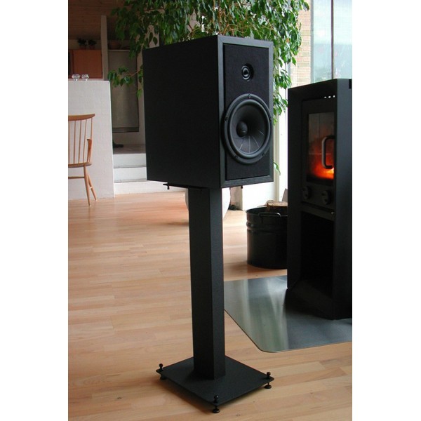

This is an example of an off-set that really works without major issues:
The QM60 | Guru Loudspeakers
They guy (Ingvar Öhman) who made this loudspeaker is one of the worlds best designers and I challenge anyone to discuss loudspeaker designs with him. He's simply a natural born genius! 🙂

Yes, i know this speakers and heard them on shows. He gave an interview that i found fascinating. I also like the no nonsense styling. The only problem i have is the sharp edge between the woofer and the tweeter. I made experiments with this and got in trouble. He uses a small waveguide though.
How thick is the mid-woofer baffle? My guess is that you need something between 25-30mm?
If so it's better to have the baffle straight at the top to get the center to center distance between the tweeter and mid-woofer as small as possible. If any diffraction causes an issue, use some foam at selected places (NHT style), to diffuse it.

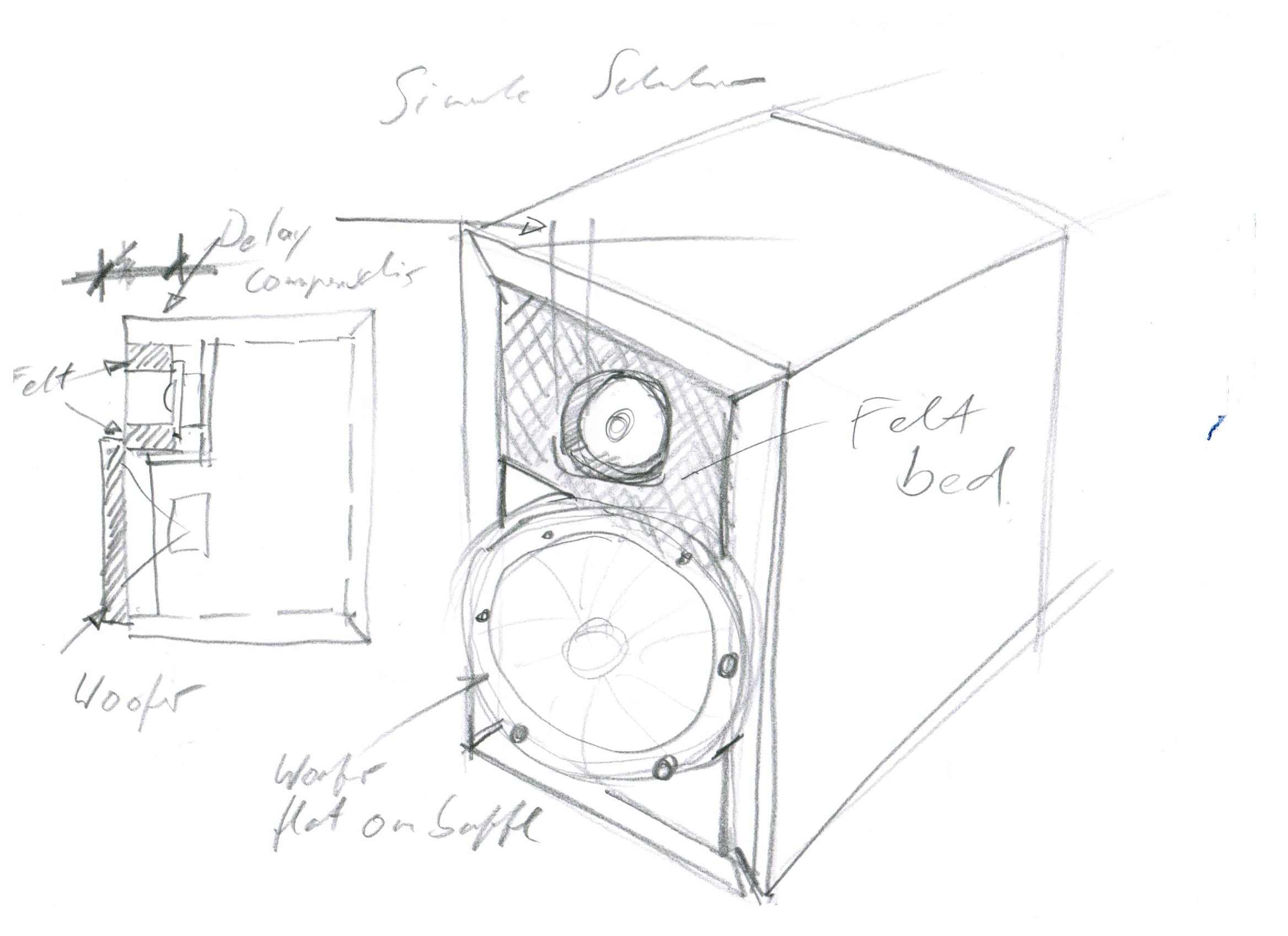

Here is another idea. sorry to say that i did not invent that ether.
It is a danish design.
On the other hand i am not a big fan of heavy felt damping. It can be an advantage on axis but you loose energy off axis.
I think i go for a Guru Clone. Nice word that is 🙂
If I was you I would go for the Guru clone. 😀
The loudspeaker in the picture would have some tweeter diffraction isues and doesn't have the right amount of time delay that you require.
I would also use an baffle with of at least 25cm, but that depends on how the mid-woofer measures. This would give an baffle diffraction centered at around 500Hz depending on baffle round-over.
Also I would design the loudspeaker to have the tweeter at ear height or below in order to reduce the baffle diffraction issues.
