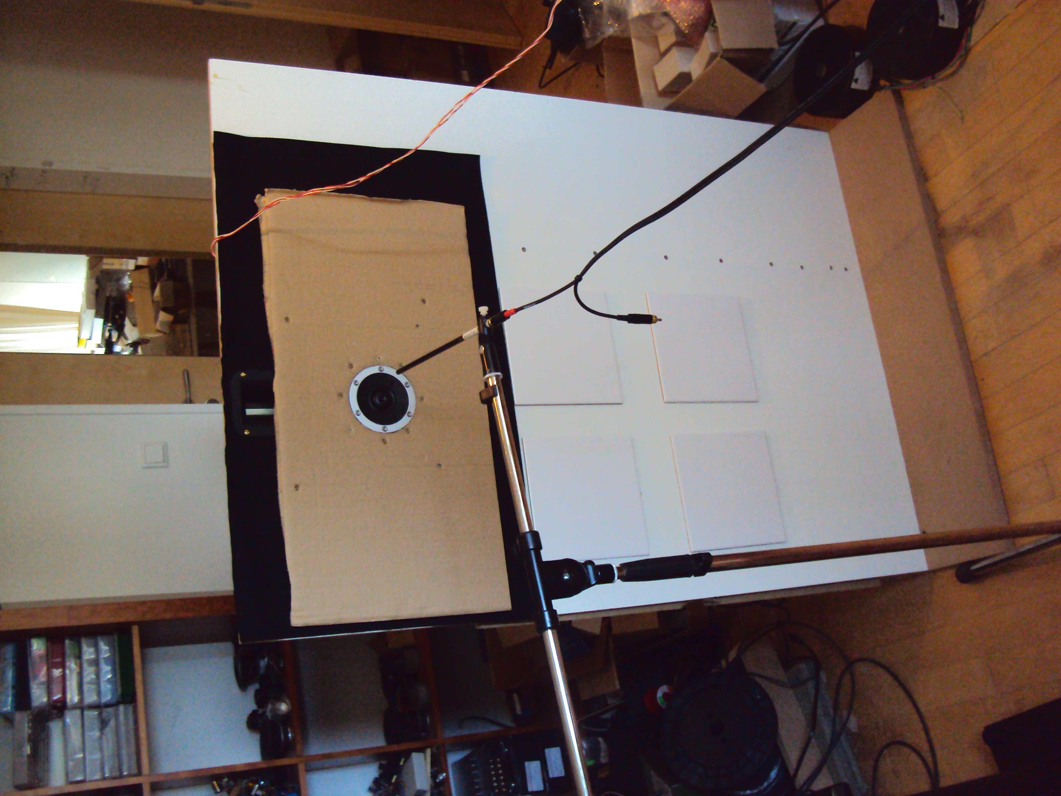

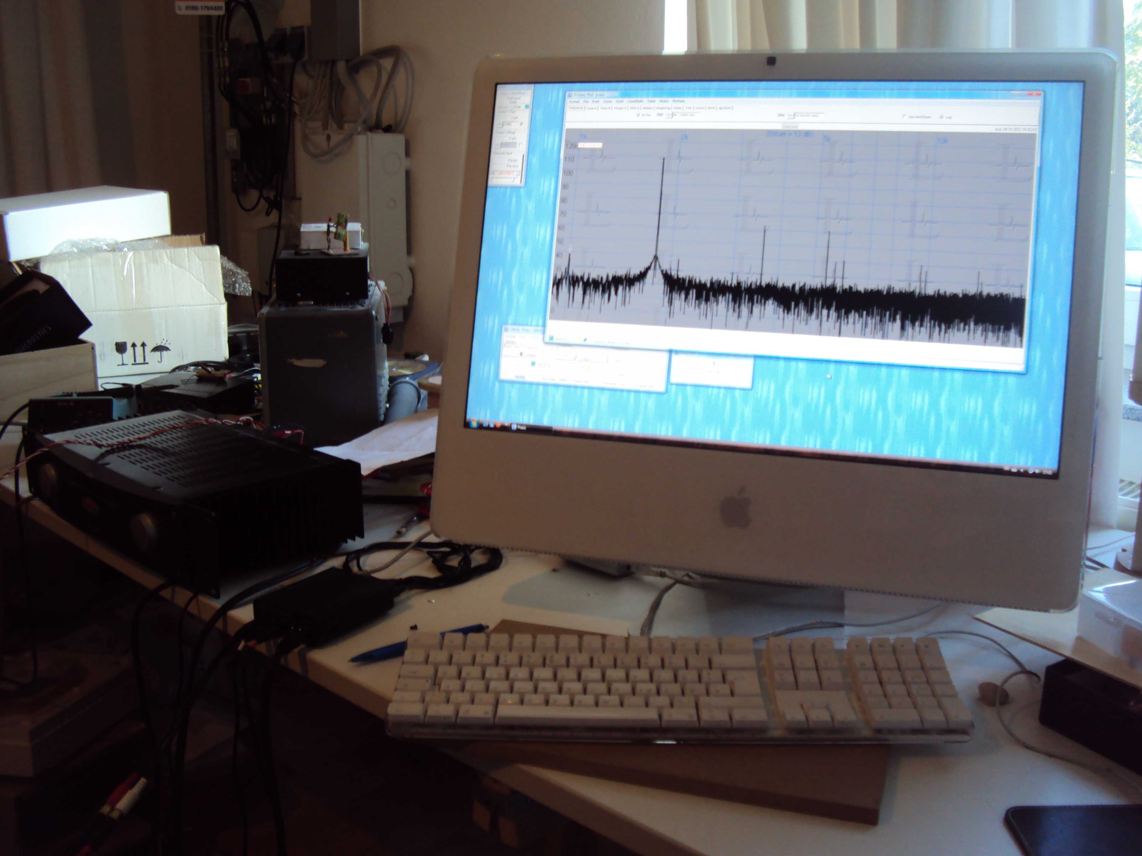

Today i measured the tweeter. That took longer then anticipated so i will measure the woofer tomorrow. i got a rather detailed analysis though.
Here some pictures from the setup.

Here are the frequency response measurements on the Satori tweeter on the 1.2m x 1.2m baffle. The bumps in the response under 3kHz are an artifact of the baffle.
It disappears in the near field response.
The on- and off-axis response was measured in 50cm and the near field response in 10cm.
The measurements where taken at 0°, 10°, 20°, 30° and 45°.

Here is a multi tone test. 31 frequencies spread in such a way that they do not inter modulate much with themselves. This test is also know as Spectral Contamination.
The first test is with the driving signal and the other shows the multitones notched out so that is a so called Belcher Test.
Here is a single tone spectrum, high volume, at 1.8kHz and 4kHz.
THD in both cases is around 0.55%.
Here is a test you may have not seen before. Without a better word for it i called it Gerhard Test. This is the distortion residuum with the multi tones notched out and transferred into the time domain by doing a back FFT.
You see that the residuum is at about plus-minus 2uPascal, a low value.
I have also recorded a WAV file where you can listen to this residuum.
I am not able to upload that here so if anybody has an idea how i can share it you are welcome.

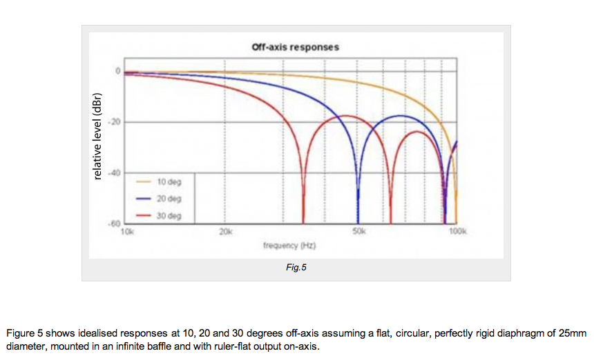

the tweeter membrane behaves like a surround, it rolls, and the suckout is due to the summation of the changing amplitude over the membrane. It's not like a piston, but clearly better as there's no antiphase. how does the curve look without the smoothing you have applied.??
Yes, i said "more or less" and "not so much". Sure it is not a rigid piston but not a conventional soft dome ether.
Here is a new paper :http://www.extra.research.philips.com/hera/people/aarts/RMA_papers/aar11pu5.pdf
Here is a picture of a 25mm round, rigid piston. Unfortunately it is not measured at 45° where the notch will be shifted down in frequency even more. The notch in the Satori is somewhat deeper in frequency so it is not perfect rigid. I could not find a simulation of a ring radiator so far.
