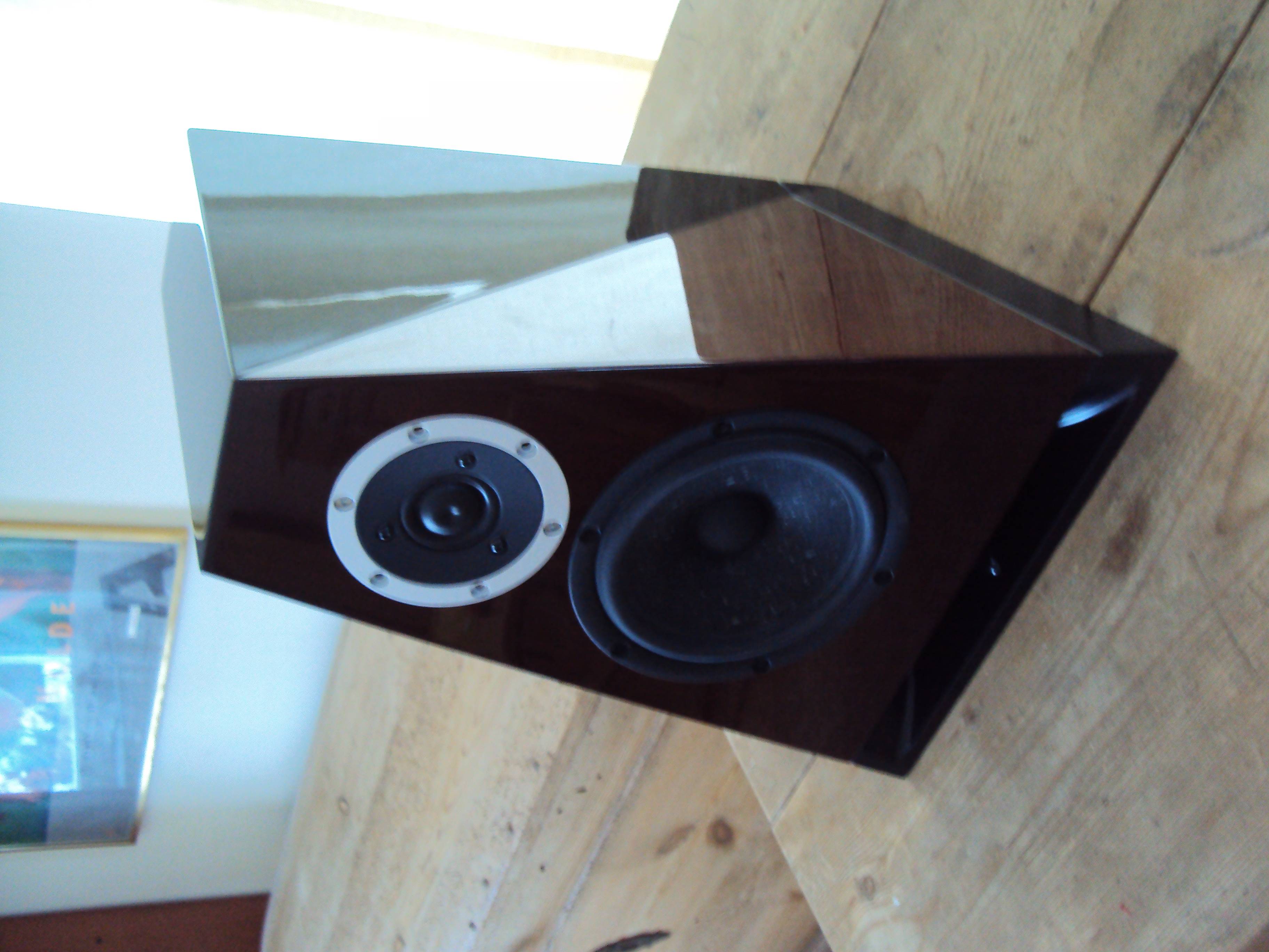

looks sharp even though Im not a fan of the high gloss piano look. And I must ask, why the white ring around the tweeter?

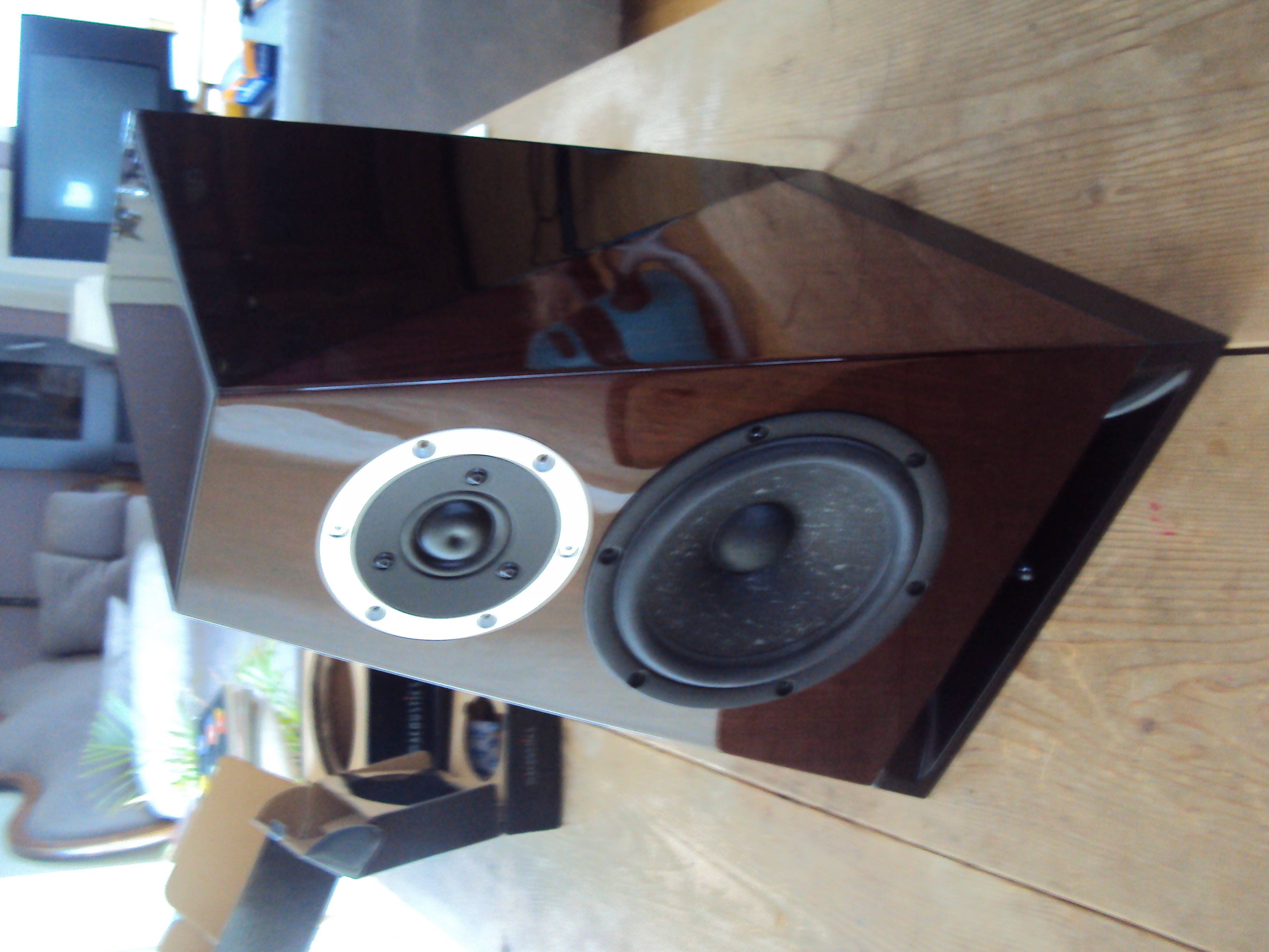

I have now put the drivers into the factory made cabinets and did some photos.
The cabinets are so shiny that they are quite hard to photograph, especially at night and with flash. I hope you enjoy them nevertheless. I decided to put in the 8 Ohm version of the Satori woofer because i think that will be used most of the time. So we will have two designs.
Very nice finish on the cabinets. I especially like the port solution and I would really like to see a near-field measurement on the port. 🙂
However, I don't think the appearance and the look of the drivers fully harmonize with the great finish of the enclosure. I also think that SB Acoustics could have done a better job to make the two Satori drivers aesthetically match each other better, but of course that hasn't anything to do with their performance. 😉

Yes, the silver ring draws some attention. Maybe i can talk SB into making a version with a black ring. The ring can also be sprayed black quite easy.
The cabinets look better during the day then on the photos i did at night with flash.
I did now some photos without flash.

The white ring does make the tweeter instantly identifiable though, which might have been what they were aiming for even though it does look out of place.
