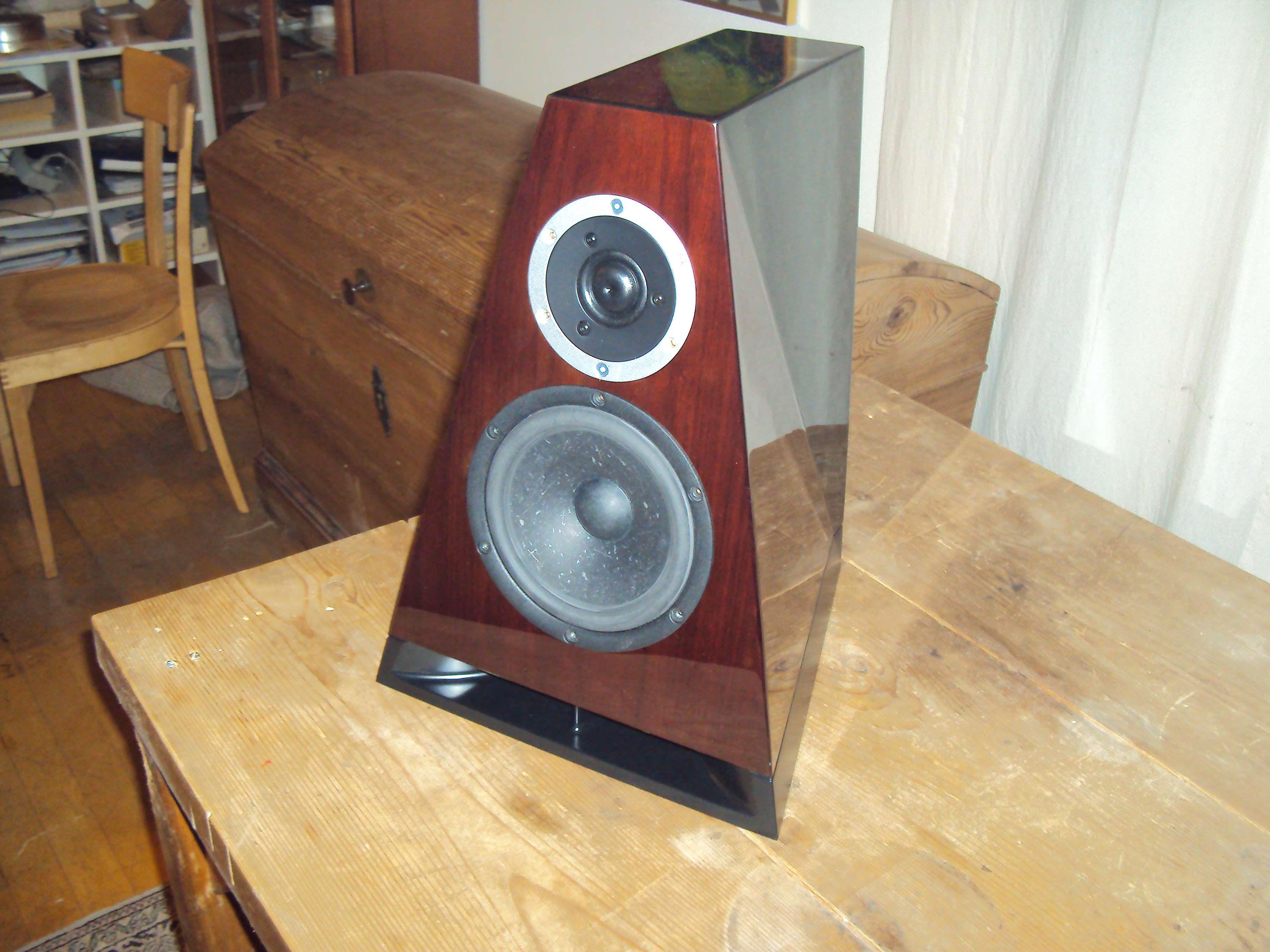

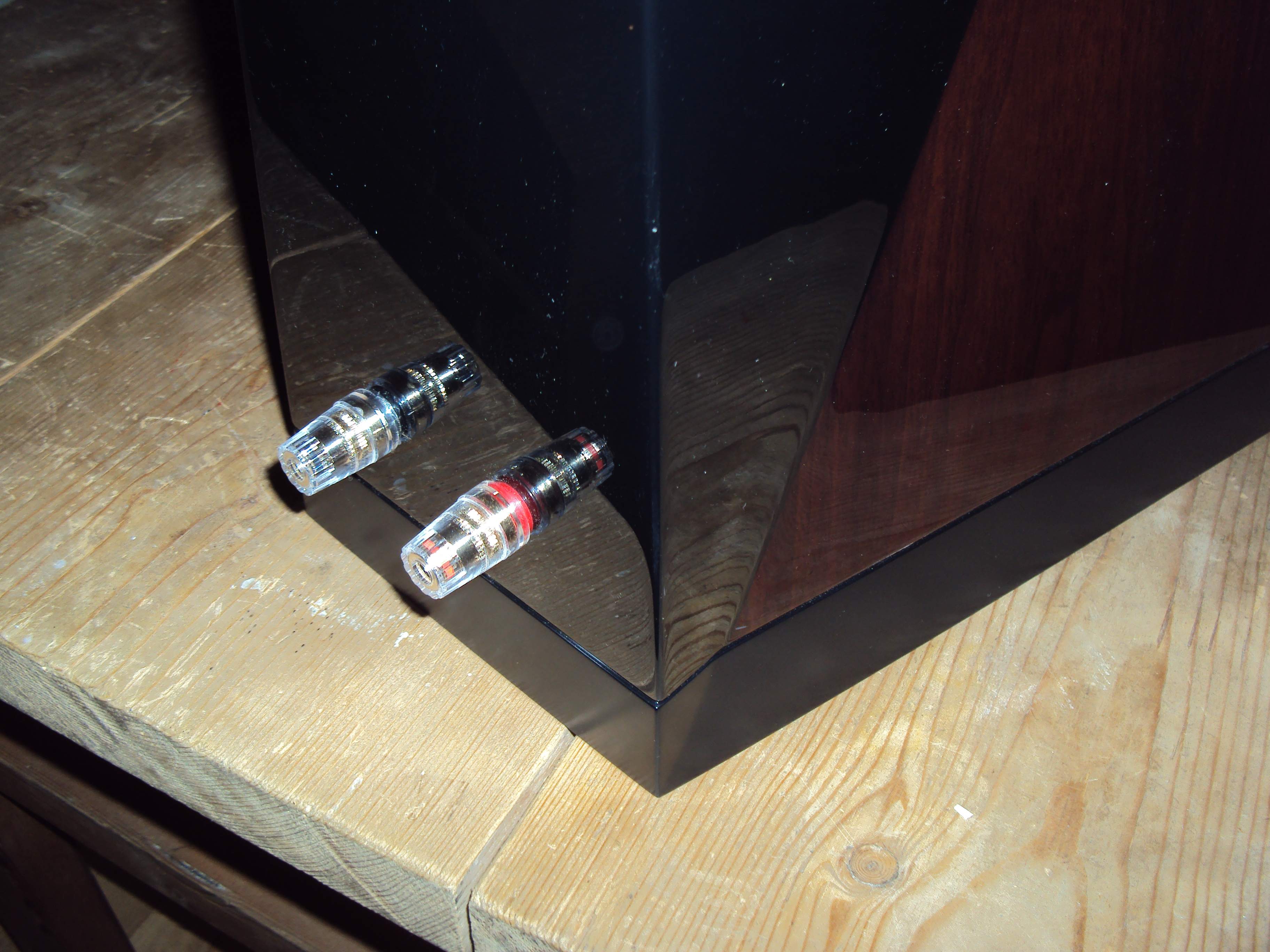

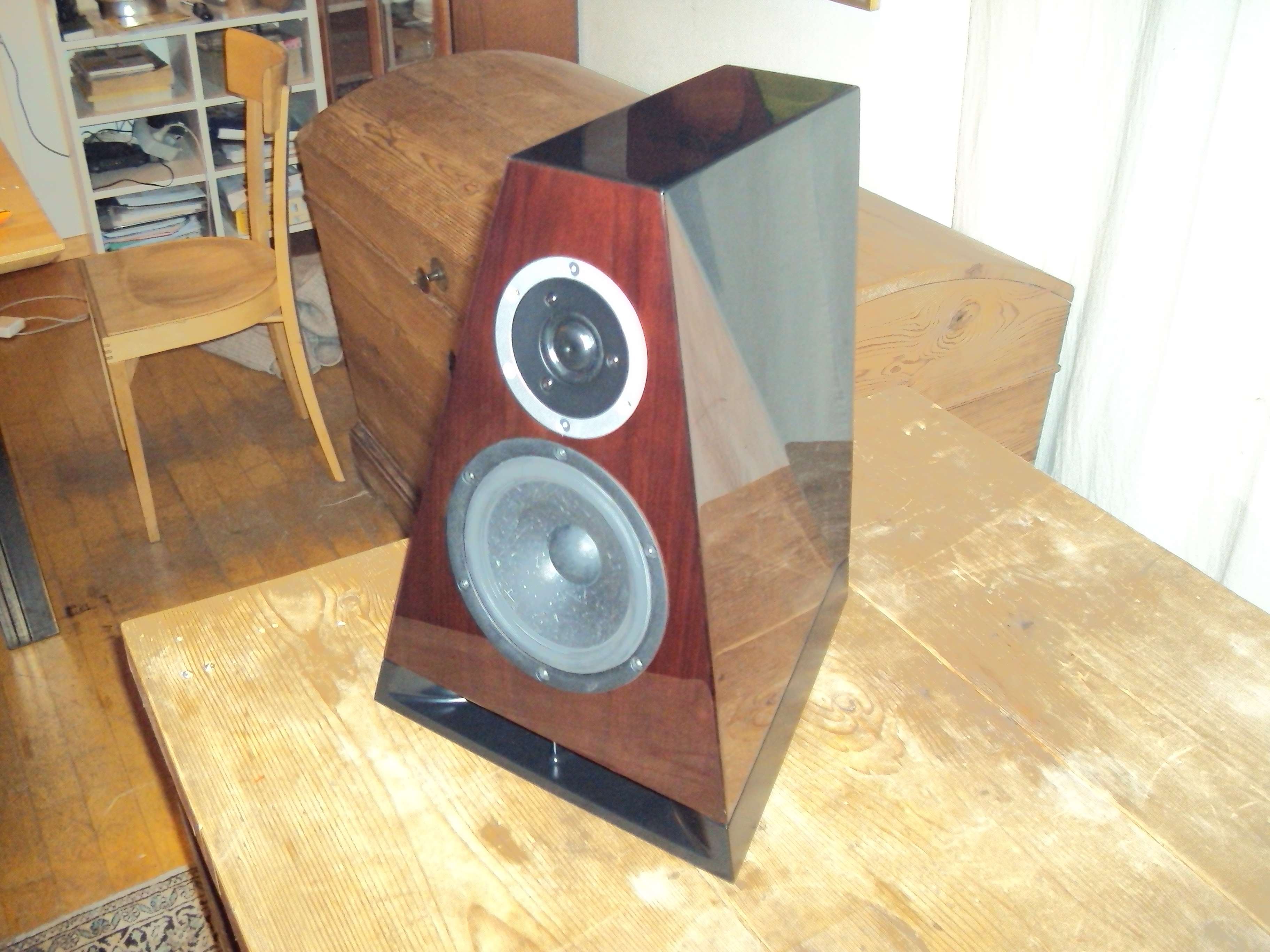

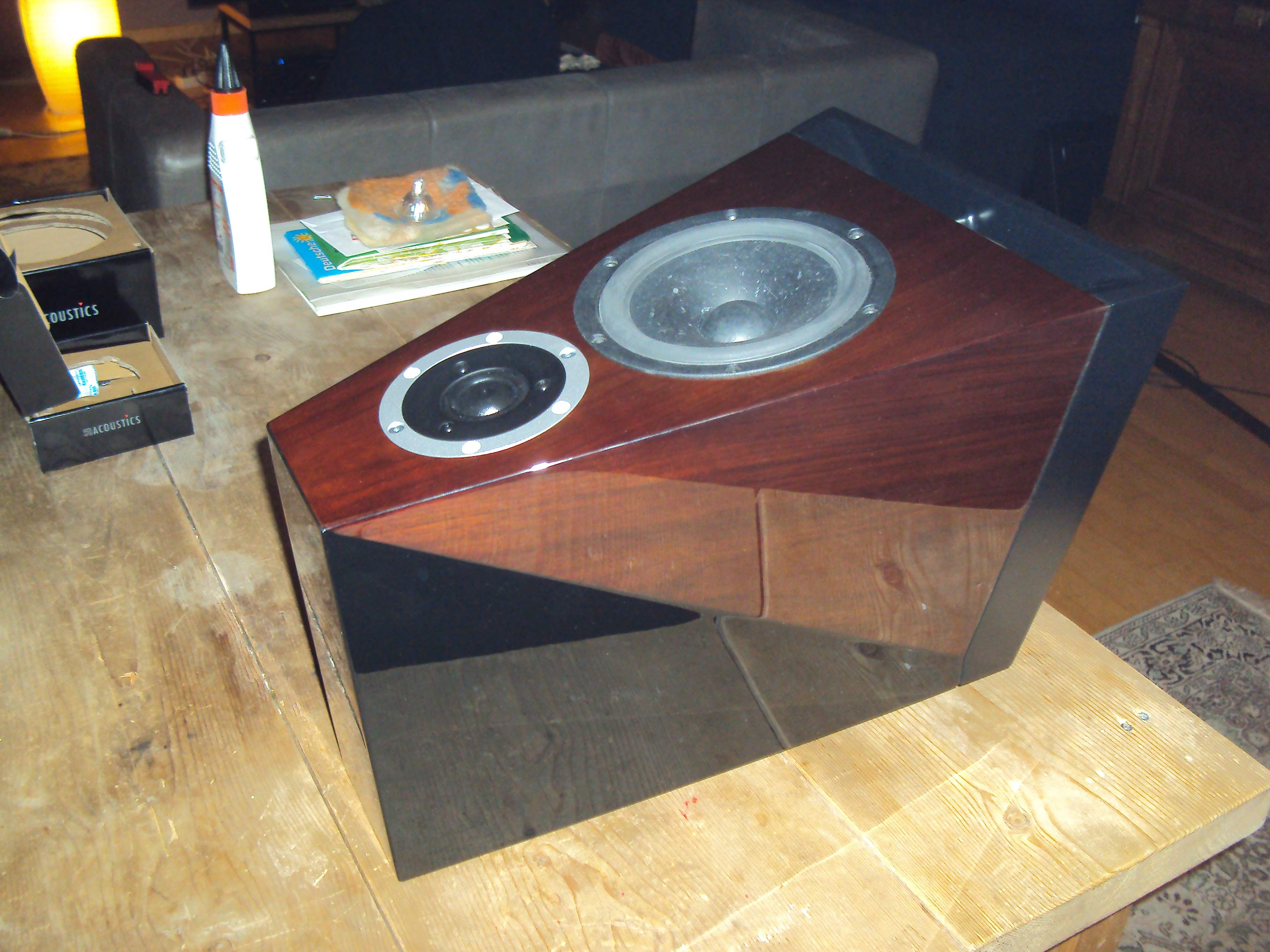

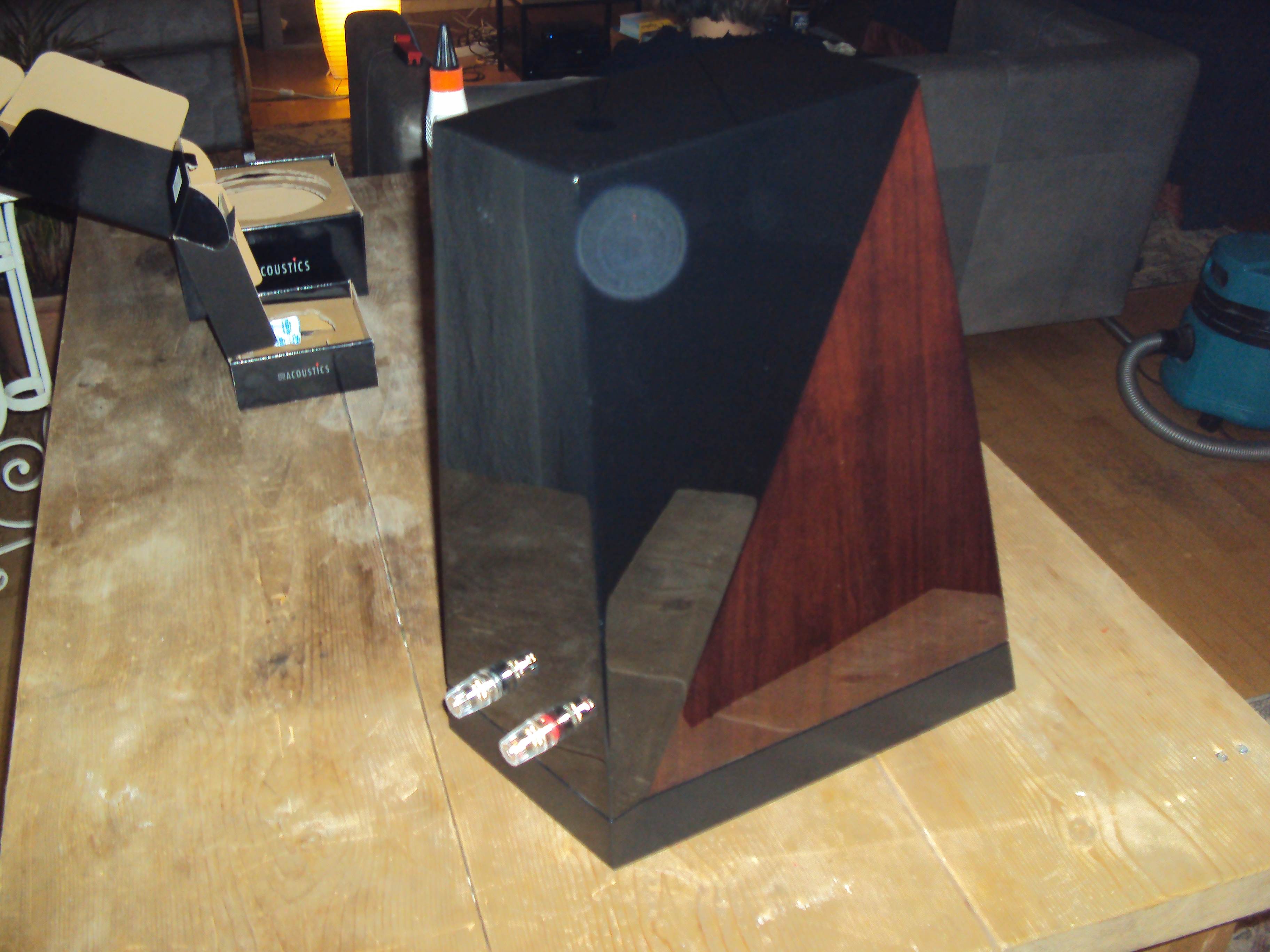

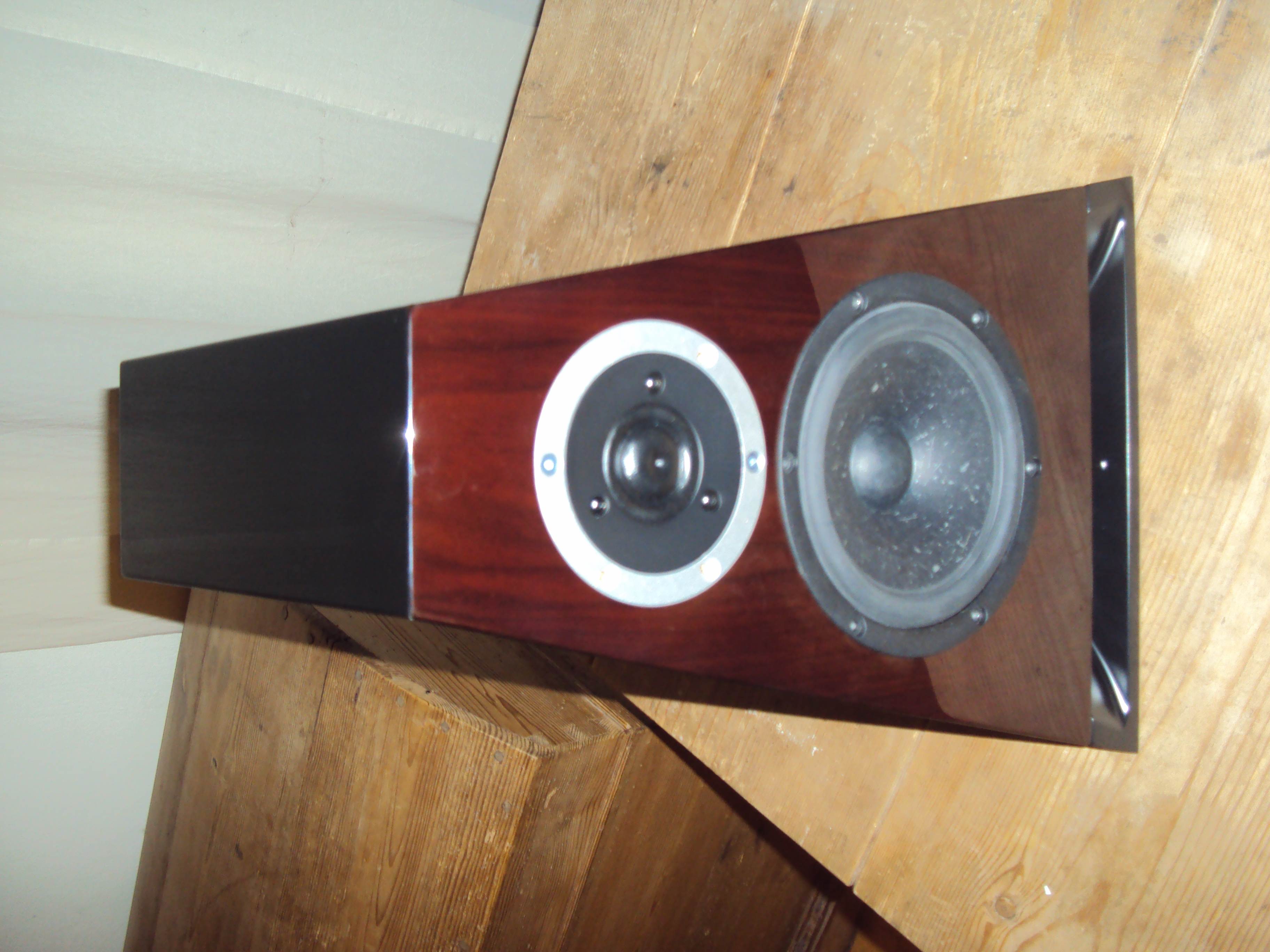

I have now put the drivers into the factory made cabinets and did some photos.
The cabinets are so shiny that they are quite hard to photograph, especially at night and with flash. I hope you enjoy them nevertheless. I decided to put in the 8 Ohm version of the Satori woofer because i think that will be used most of the time. So we will have two designs.

Joachim,
If the speakers sound as good as they look you will have a winner on your hands there. I really like the enclosures and I am more than picky myself. I particularly like both the contrast of colors and also the shape and the port flaring. Very nice work from someone on the loudspeaker side.
Joachim,
It looks like you still know how to make lemonade out of lemons....... Is the piano black finish paint or a laminate, and if it is what is the cabinet constructed from? I have pulled my hair out getting this type of black finish on mdf far to many times, and I am a painter when I need to be. I have painted many custom car finishes and know paint coatings very well. I imagine that the wood veneer is finished with a catalyzed two component clear coat and hand finished. Excellent work.
the finish is hand-polished piano finish... It's done by adding at 1.2 mm thick clear polyester coat over the black base color. The clear coat is then by hand polished down to 0,6-0.8 mm... same process they do on a Steinway grand piano.
