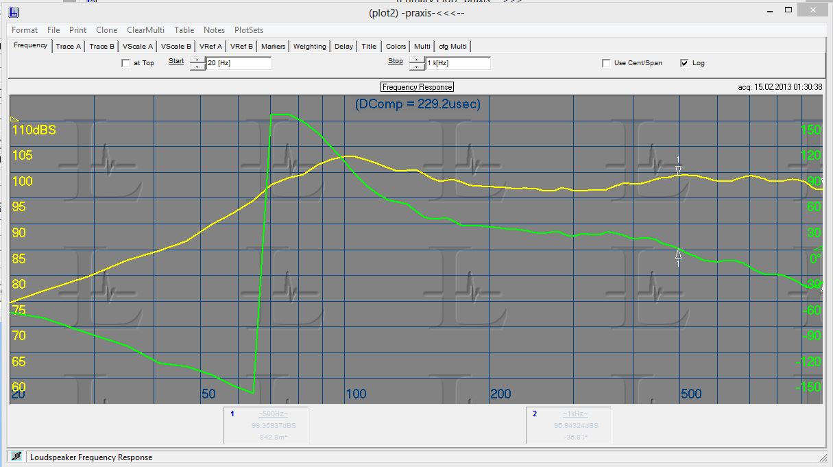

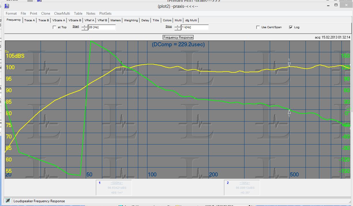

I have now measured the drivers in the cabinet.

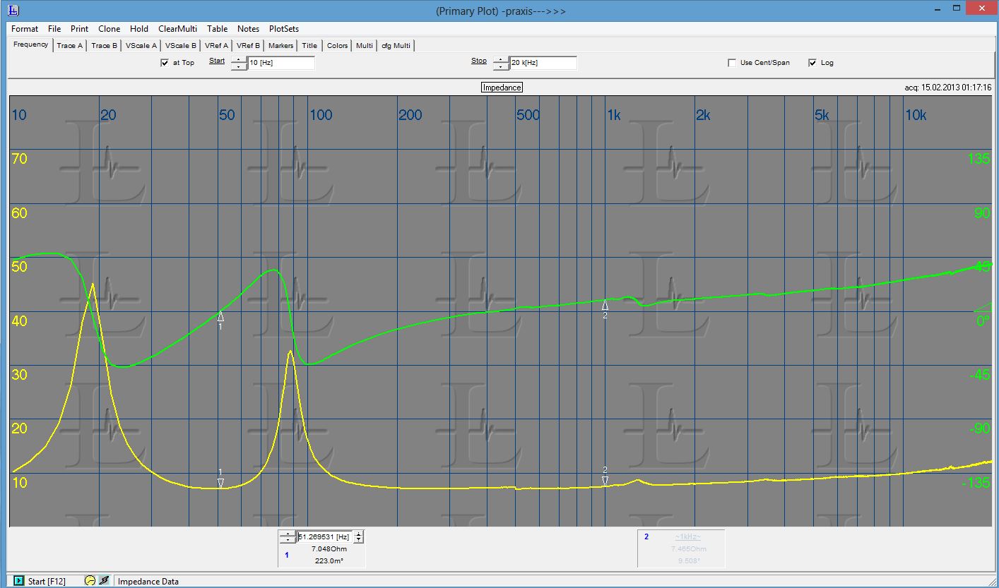

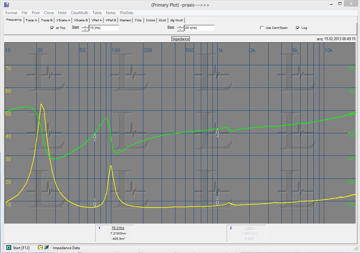

Here is the bass tuning. Both tubes open is a bit high but some will actually will like this when the speakers are in a bigger room, far away from walls. Stuffing one tube gives a flat result. I think this tuning option is good so i have no desire to change the cabinet design.

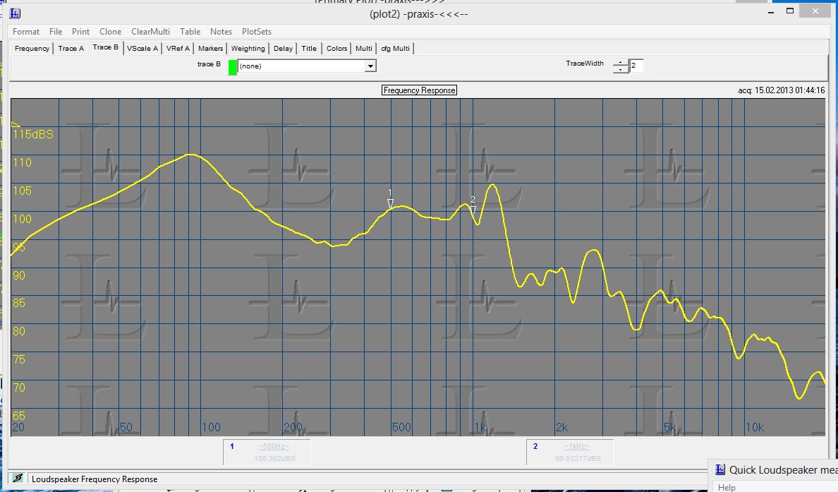

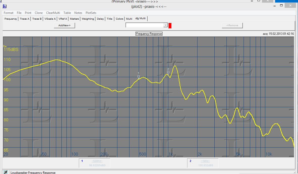

Some may be interested how the output of the reflex tunnels looks at higher frequencies.
Here you have one tube compared to both tubes open. There is some wide range output but it is not very peaky. I think a good result.

A port tuning of 51Hz seems rather high. How large is the enclosure?
For the 4Ohm Satori I will test and try out a 20 litre enclosure and a port tuning of 34-36Hz, which gives an almost text-book QB3 alignment.
I think the Satori has the potential to be a great bass performer and it seem to be a bit wasted performance, not to use it fully.
Of course, this is also a matter of taste and room setup and there is no right or wrong here. 😉

Yes, the cabinet is a bit small und the tuning high. In a bigger cabinet it will go deeper but also has to pump harder. We also wanted the cabinet to look nice and be compact.

It's easy to lower port resonance, just inlay some foam at the sides to narrow the port a bit...but 51 HZ is not that bad. better to have the speaker do what it does good, than to have it try to do something it cannot...!!
