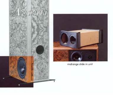

This is of cause a good way to do it, especially for DIY. I found also the " box in a box " construction works great. I pioneered that in the Audio Physic Avanti from 1989.
Here i had a very well damped and braced inner box that was slided in an outer box with foam rubber gaskets. Here " Air" worked better then sand.
