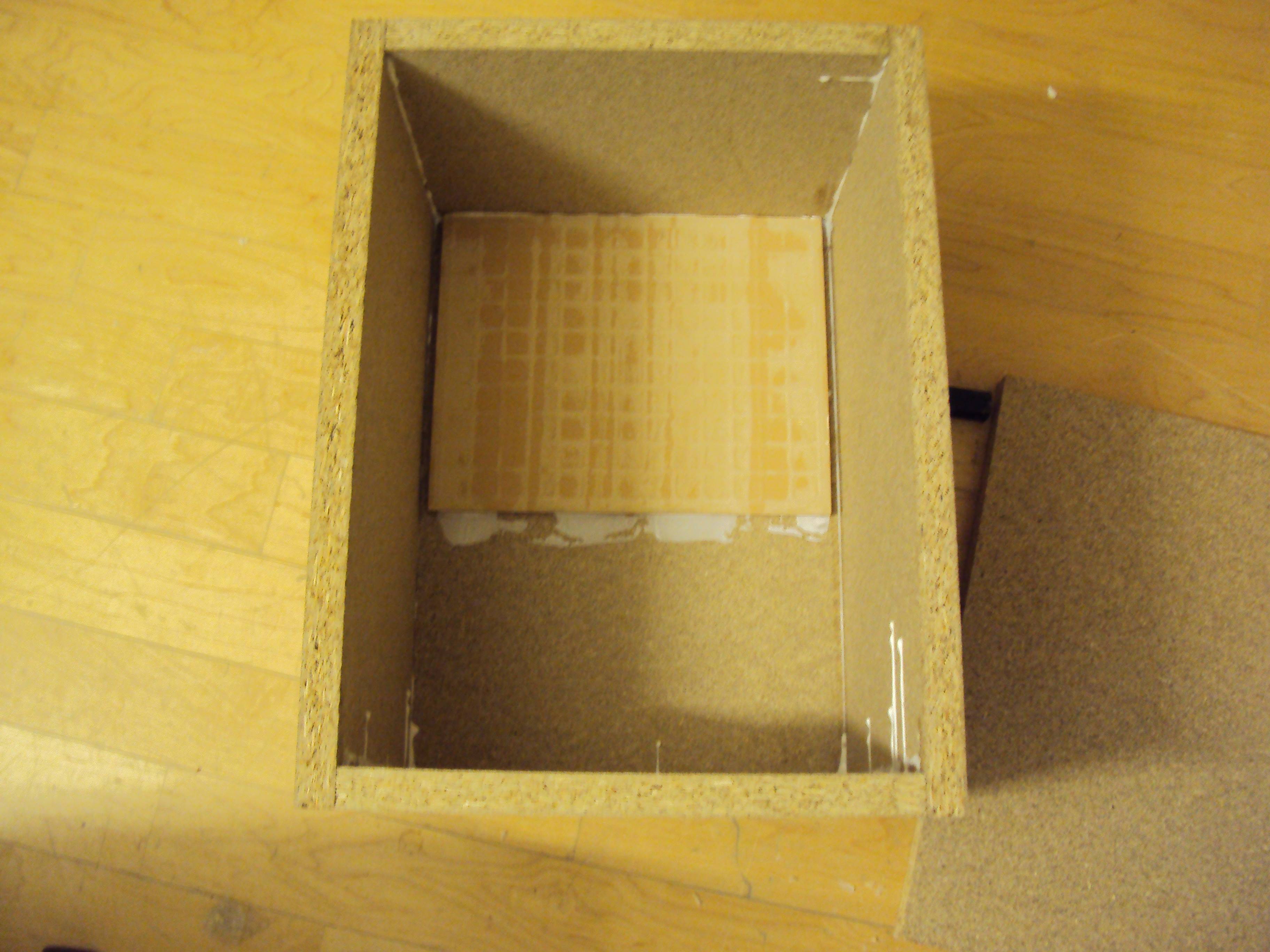

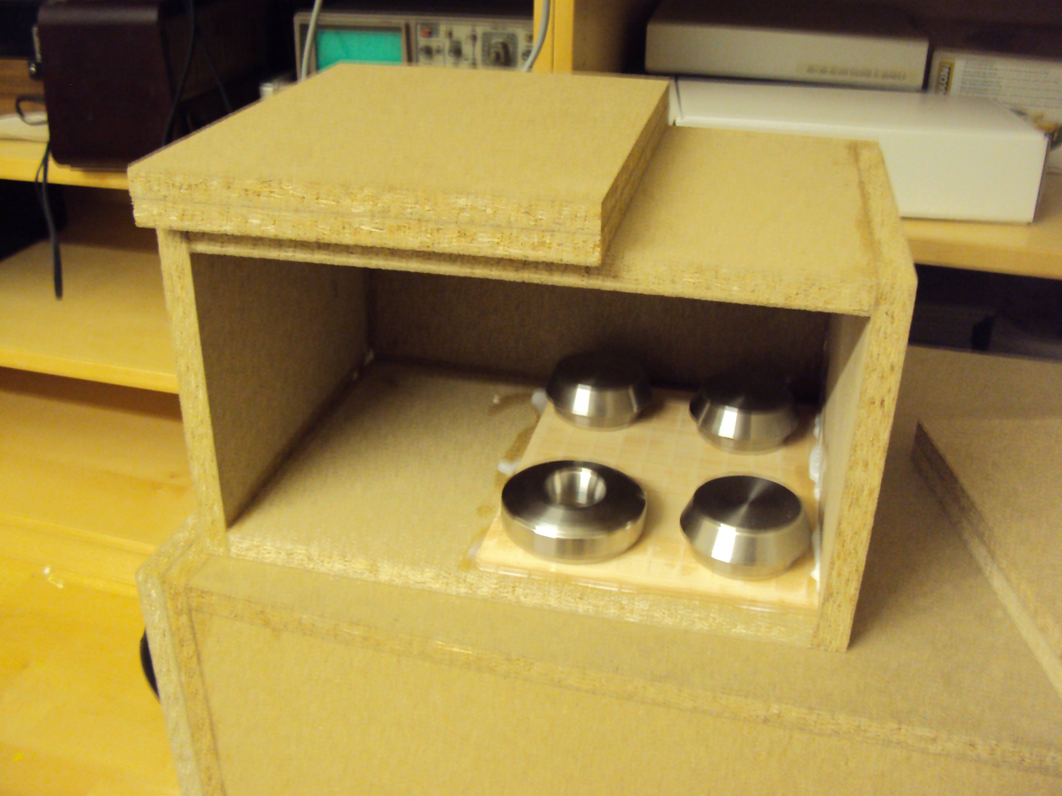

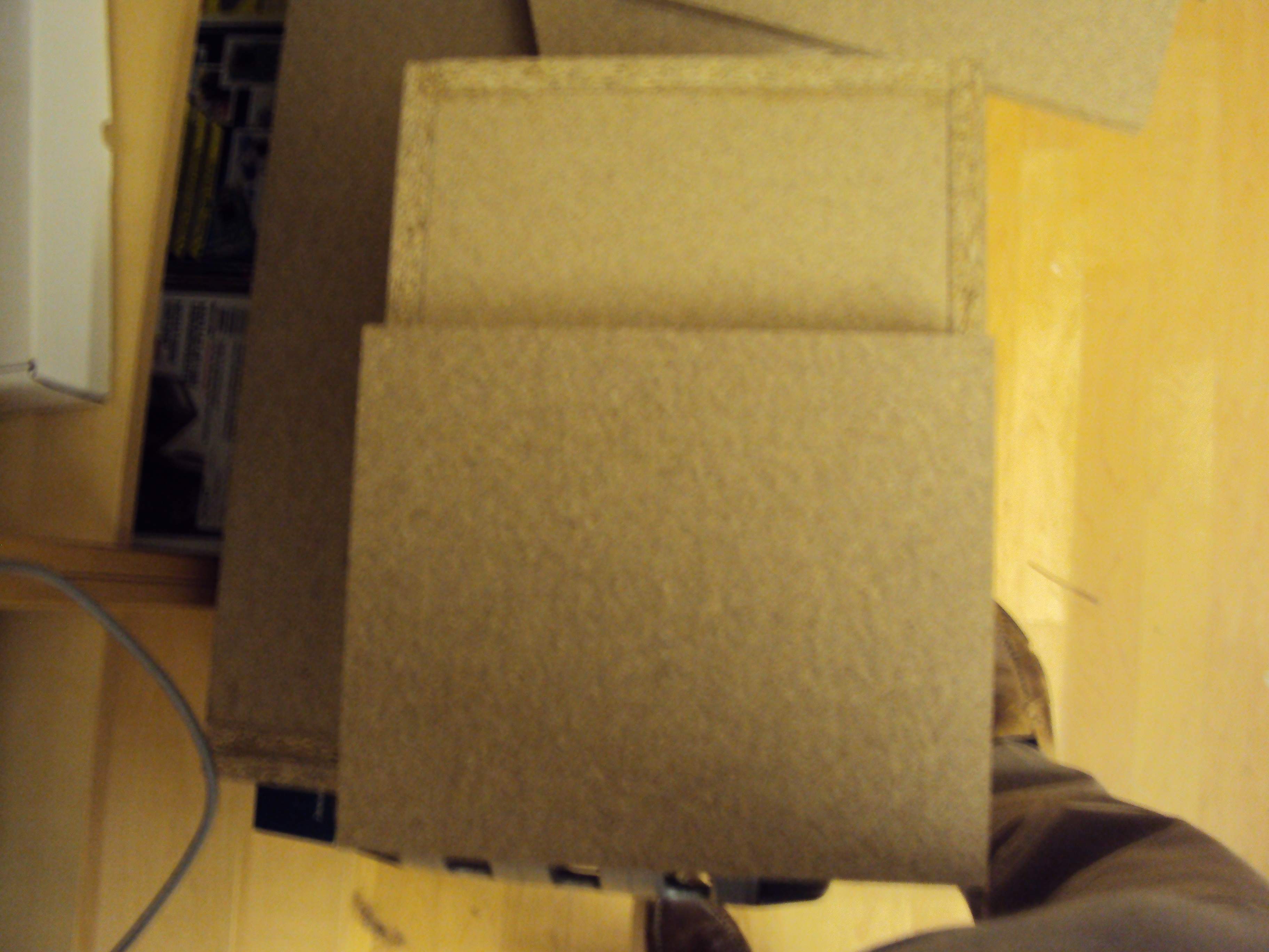

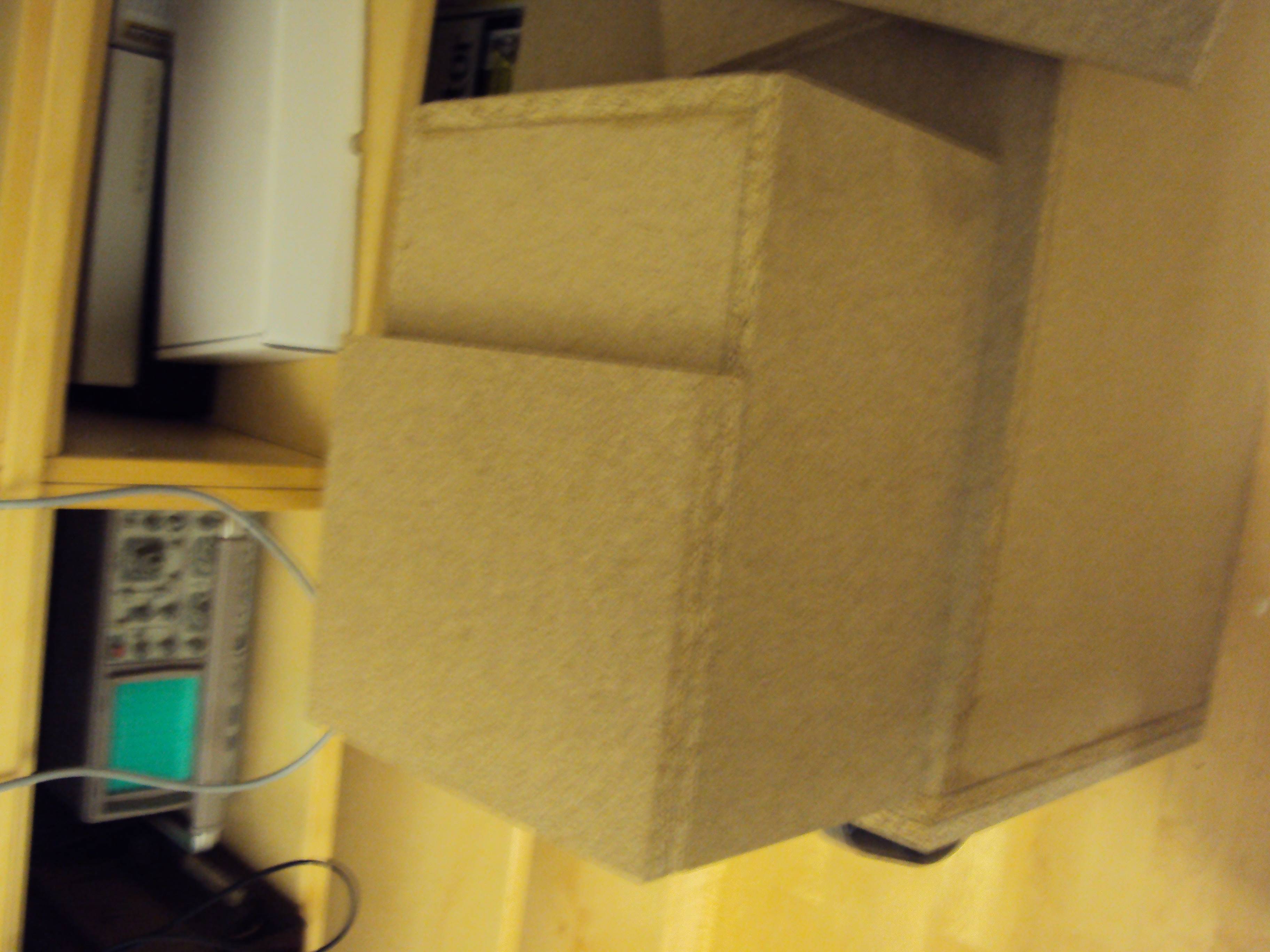

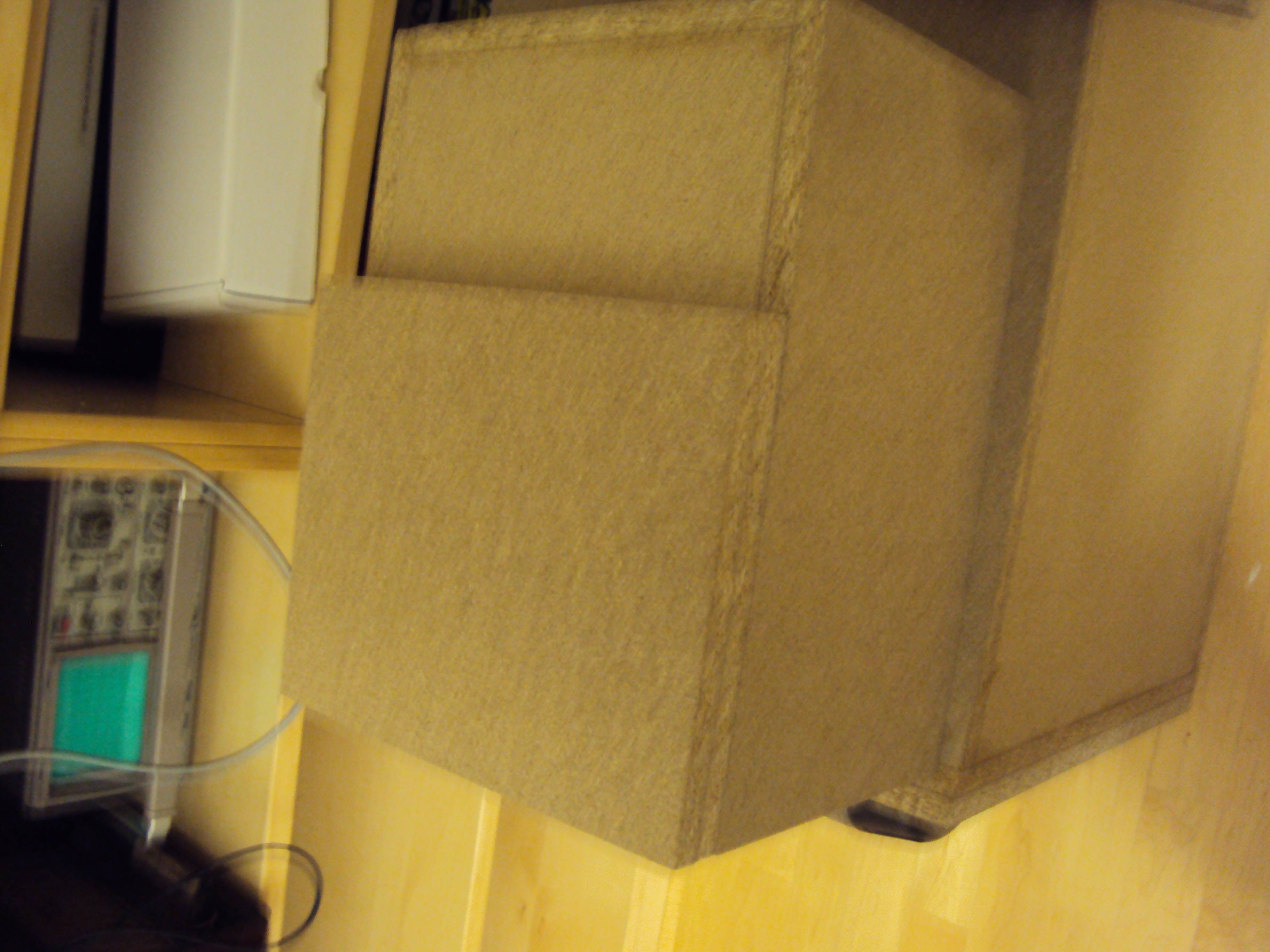

I am building the DIY version of the cabinets for the Satori Monitors. In the meantime the professionally made cabinets are build by SB. We still have not decided if we will offer this cabinets ready made or as a flat pack.
Anyway, here i show you how to build cabinets for the Satori Monitor with minimum effort.
We decided before on a Guru clone for the shape of the cabinet.
I am building it in 19mm chipboard. That is cheap and easy to work with. Some say that it also sounds better then MDF. I think it is not worse.
The dimensions are a bit unusual but not unattractive. They are 30cm wide, 40cm high and 22,5cm deep. There is also a 32mm thick baffle made from 2 x 16mm chipboard
to time align the drivers. I will round the edges and will look if the sharp edge from the woofer baffle to the tweeter has any bad effect. The wider then usual baffle has the advantage that the baffle step is not that pronounced so we win some efficiency in the fundamental tone area. The tweeter on the wider baffle will push the edge reflexion to lower frequencies. Would be ideal if i can place the crossover point in such a way that the edge reflexion suck out is in the region where the crossover already rolls off the tweeter. The front baffle is mechanically quite stable because of the extra baffle for time alignment. That way 2/3rd of the baffle is 51mm think. The side and top walls are not very deep, that also helps to make them stiffer then usual. The biggest unbraced wall is now the back wall so i decided to glue on a ceramic tile.
