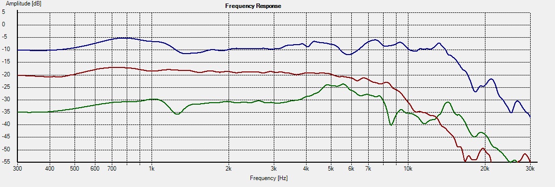

I'm a bit curious because, when I started some simple quick and dirty cross-over simulations based on these measurements I found out that the baffle step where a bit more complicated than usual to take care of, at least when I simulated LR2 filter with 3kHz x-over point and didn't want an excessive amount of components. If I lower the x-over point to about 2.4kHz it looks easier.
When I measured my Satori mid-woofer I used an 24.8cm wide baffle with (r=18mm) round-over for the baffle edges and get a broad hump (+5dB) centered at approximately 800Hz and f/2 at 570 and 1150Hz.
For comparison:
Measured @ Tweeter-axis, on-axis.
Blue = Satori MW16P-4 (24,8cm baffle, r=18mm round-over)
Red = ScanSpeak Revelator 15W/4531G00 (21,6cm baffle, r=12mm round-over)
Green = AudioTechnology 15H520613SDK (21,6cm baffle, r=12mm round-over)

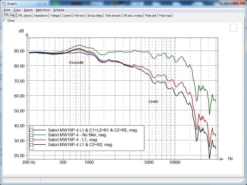

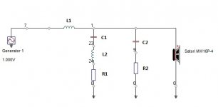

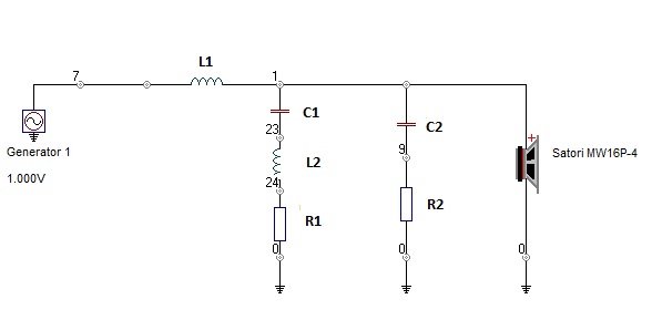

I haven’t yet finally decided which tweeter to use in combination with the Satori mid-woofer, but I’ve tested a couple of ScanSpeak tweeters on the same baffle, hence the experimental 2.4kHz x-over which seems viable with one of them using a stepped baffle and yes, all your advices is a nice good sum-up of things among others to consider in the chosen design.
Picture 2: Experimental 2.4kHz LR2 x-over
Picture 3: Mid-woofer 15deg off-axis, effect of LCR
Sorry Joachim it wasn’t my intention to hijack your thread, but I was a bit curious and thought it was interesting to compare the different baffle dimensions we used, yours 30cm wide baffle and Jeffs 22.9cm and my 24.8cm. 😉

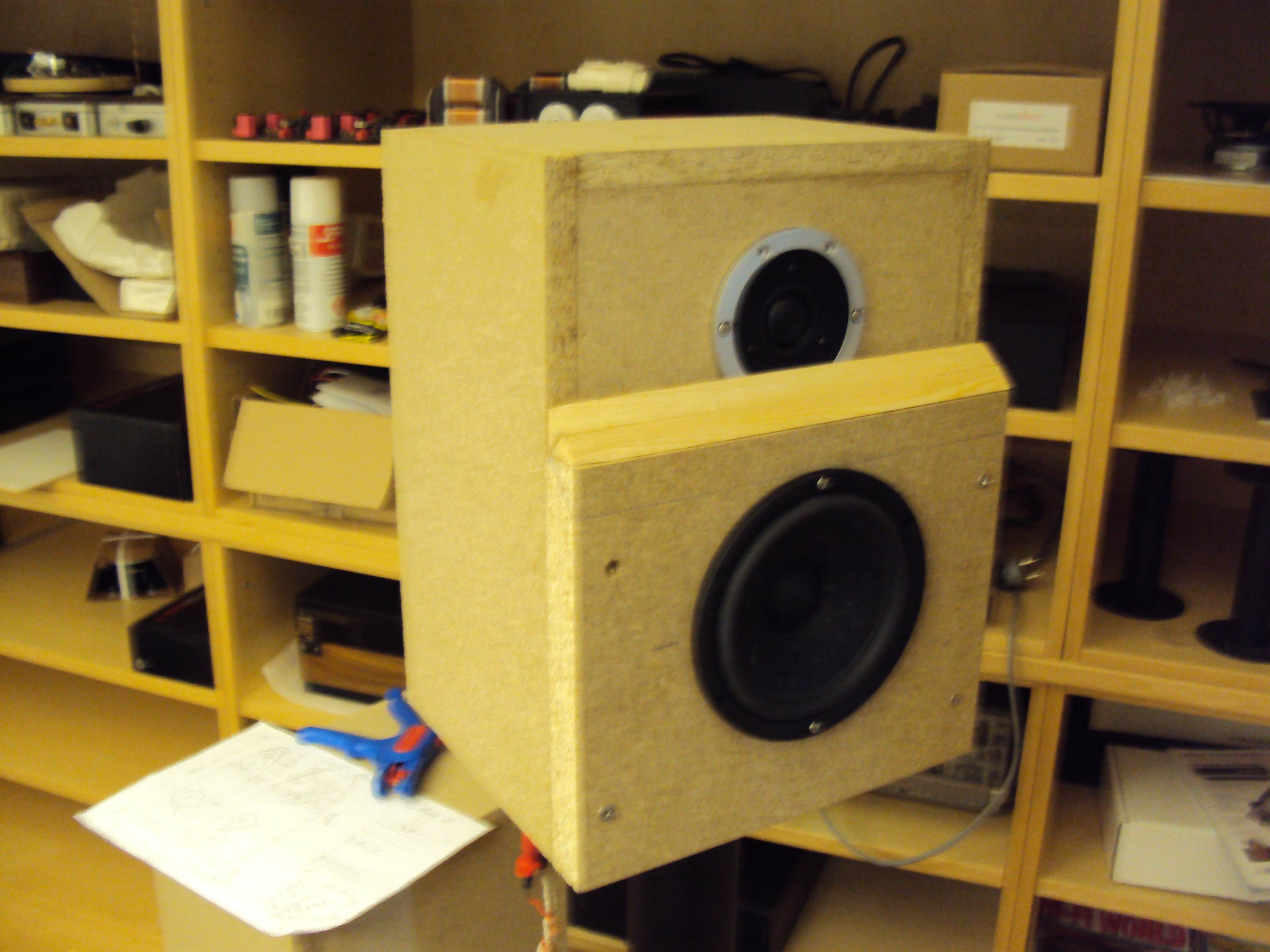

Here is a picture how the prototype box looks at the moment. I will round the edges and sink in the drivers. After this i will fine tune the crossover.
When the factory made cabinets come i will have to fine tune again.
While Jeff has made a phase linear version and Göran is working on an L/R4 i will stick to the L/R2. We have a lot of options then.
