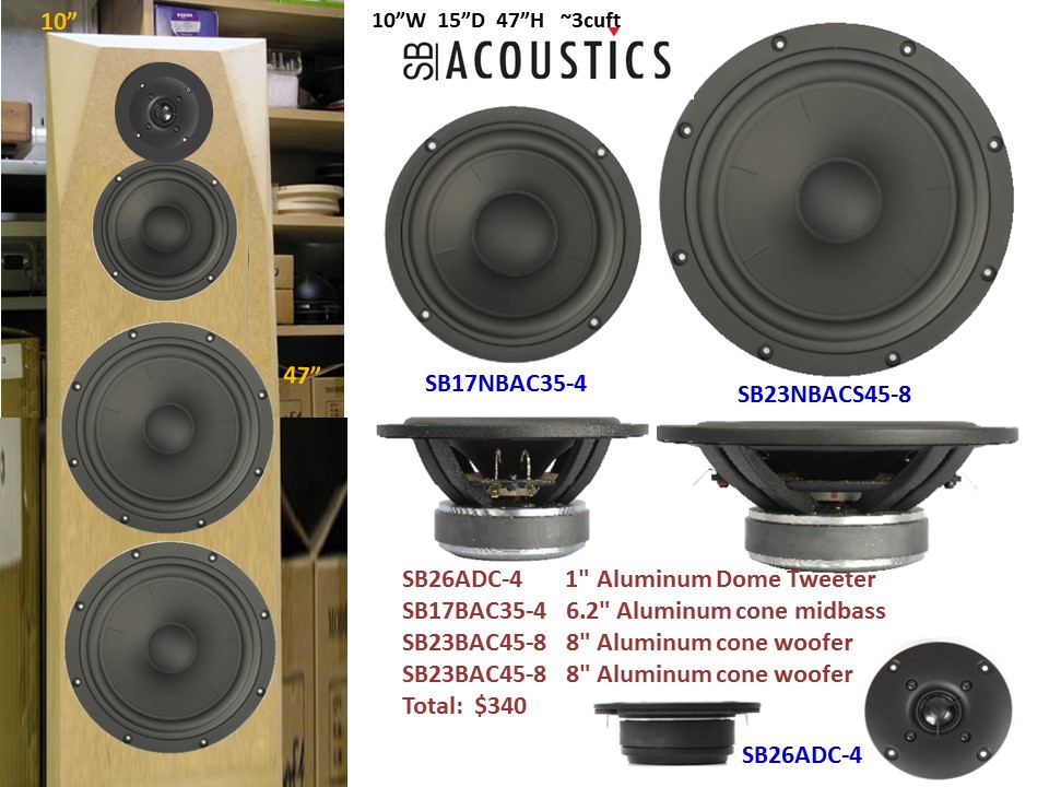

The cone material will have a large sonic effect. In the SB_line of drivers, there are a few posts which compare both the sonics and the measurements of cones constructed with: polyplastic like the MFC you are considering, paper, aluminum, and ceramic coated aluminum. In one word adjectives:
MFC plastic = smooth
Multi-fiber paper = natural
Ribbed aluminum = detailed
Ceramic coated Aluminum = detailed+
A pair of 8" SB23NBACS45-8 woofers can produce -F3 ~32Hz and save building plus itegrating a subwoofer. SB's ribbed aluminum cones have raised the first main cone breakup to ~4kHz. Can you fit a 3.5cuft cabinet to build stereo 3-way TM-WW, 1-6-(8-8)

I agree with all of this however the subwoofers are already built and singing! I do have the dilemma of whether I want MFC CAC OR NBAC line. I am not interested in paper. I already have a great set of paper drivers so I am wanting something different. I can fit a large dual 8" cabinet which would be fun although not entirely necessary. The biggest thing keeping me from that is that the 8" of these series don't quite measure as good (and also the 8" MFC is more of a subwoofer.)

I agree, sealed bass drivers will have superior transients compared to ported designs.
1.6cuft sealed 8" SB23NBACS45-8 -F3 ~45Hz.
3.2cuft sealed cabinet for two.
