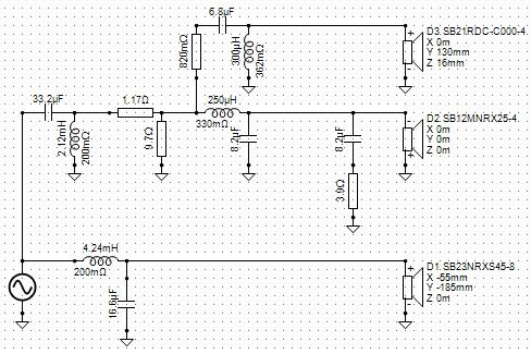

Hi EmuMannen, I intereseted this Project Speakers, which final Crossover on 3 picture scheme XO ?
I ended up using a fully passive XO (the active and semi-active versions is slightly better but fully passive is more flexible for me amp rolling my vintage amps). I recommend extending bass down to 30 Hz with a LT or similar filter (even with a fully passive XO). Attached is the schema for the passive XO:

in : The 3-Way Retro Part 5 link, I found of DSP tools, what for that? actually its pasive speakers or active speakers? Have you picture rear side of speakers?
I have built them as active, semi-active and passive (it is all described in different blog posts). I ended up with the fully passive version but you can build them semi-active or fully active if you want. They look the same from the back in any configuration since the active versions was driven from external amps (including any active XO).

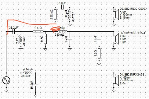

If I want to built a full passive version of the speaker, is this xo scheme suitable/ideal?
Can the new version of the sb acoustic speaker with the norex code be used on the xo, or does the design have to be adjusted again

I am not sure it does and “a more classic” is a matter of definition. I started out with the active and semi-active version of the speaker. The first XO board had to take care of the mid and high element. I therefor splitter the incoming signal at the lowest XO point with an active filter. I then added a separate board for the low element, just replaced the active filter with a passive block, when I made the fully passive version. I kept these branches and XO blocks separate to be able to switch between semi-active and fully passive and I wanted to modify the already made boards as little as possible. I hope it explains why the schematics ended up the way they did.
