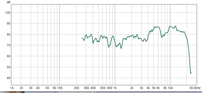

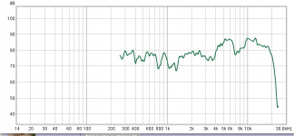

The MR16 I have, 4 Ohm, gray cone

The 13PFC I just received. These are the round frame, 8 Ohm version. They sound REALLY good for anything in this price range; one could be fooled into thinking they cost 2, 3 maybe even 4 times more! The cone "looks" like the Papyrus but has way fewer flecks or specks than the MR16 cone. Perhaps it is a less expensive paper with similar properties to Papyrus? No way do they sound as good as a Satori...BUT, I'm thinking for the money; there may not be a better sounding 5 inch mid-bass!??

I tried the 13PFC fullrange on day one to get an idea of where I might like to try X/O. Right now, I have a calculated 1st order HP of -3 dB at about 135 Hz. I am basing this on 7 Ohms according to the impedance curve. It takes away the lower bass octaves so the excursion isn't as bad. I have a small inductor on the high end for LP; this just takes off the very top end just enough to smooth out the peaking seen on the OEM FR plot. I think you could cross this little guy almost anywhere depending on your max SPL and power requirements; even running full range; it does quite well considering what we are working with here.
13PFC breaking in nicely; if you want an inexpensive 5 inch mid-bass; this just might be the best choice out there. The resolution and detail are improving quite a bit actually, much to my surprise; this thing sounds much more expensive than it's budget price for sure! It's never going to equal a Satori but we wouldn't really expect to; it has equal or better resolution and detail to my ears anyway than the 6 inch CAC I had and sold.

Back to Satori; does anyone have the MR13 Papyrus mids in use in a current design? What I have compared is that the MR16 has a flatter overall FR than the MR13. I would be curious what X/O frequency and slopes people are using with the MR13P and what tweeters they have tried as a match.
The more I read on the new TexTreme MW16 comments; the more inclined I am to now wait for a TexTreme mid (MR13TX) instead of trying the MW13 first. It seems some say the increase in performance going from Papyrus to TexTreme is not a huge leap at all like many of us had hoped for. It is still early on though so we will see as more have tried and tested and evaluated them...
