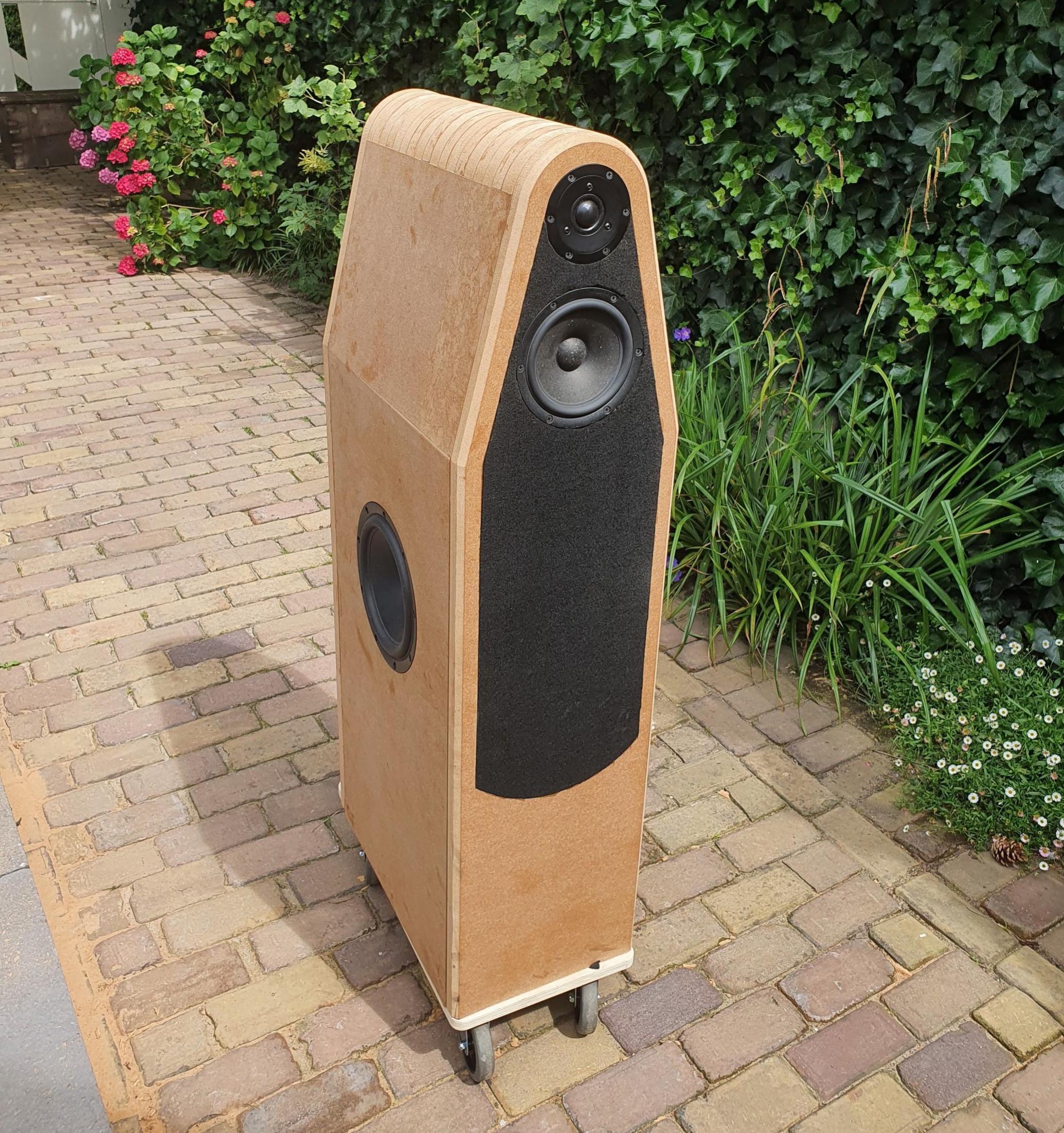

I agree. I also use the MR16P togehter with two WO24P's and used to have the TW29DN. Lovely drivers. Talking about the MR16P, I love it's midrange. Rich and the vocals are so good. So real and such body. Some staff of my local high end dealer actually prefer the vocals of my speakers over that of the €115k Kroma Elektra's. The bass from the woofers, sitting in a sealed cabinet, is also extremely good.
Last week I upgraded the tweeter to the BliesMa T34B-4. Another league in detail retrieval, distortion and spaciousness. Though I was already very impressed with the TW29DN, one of the very best soft domes on the market.
