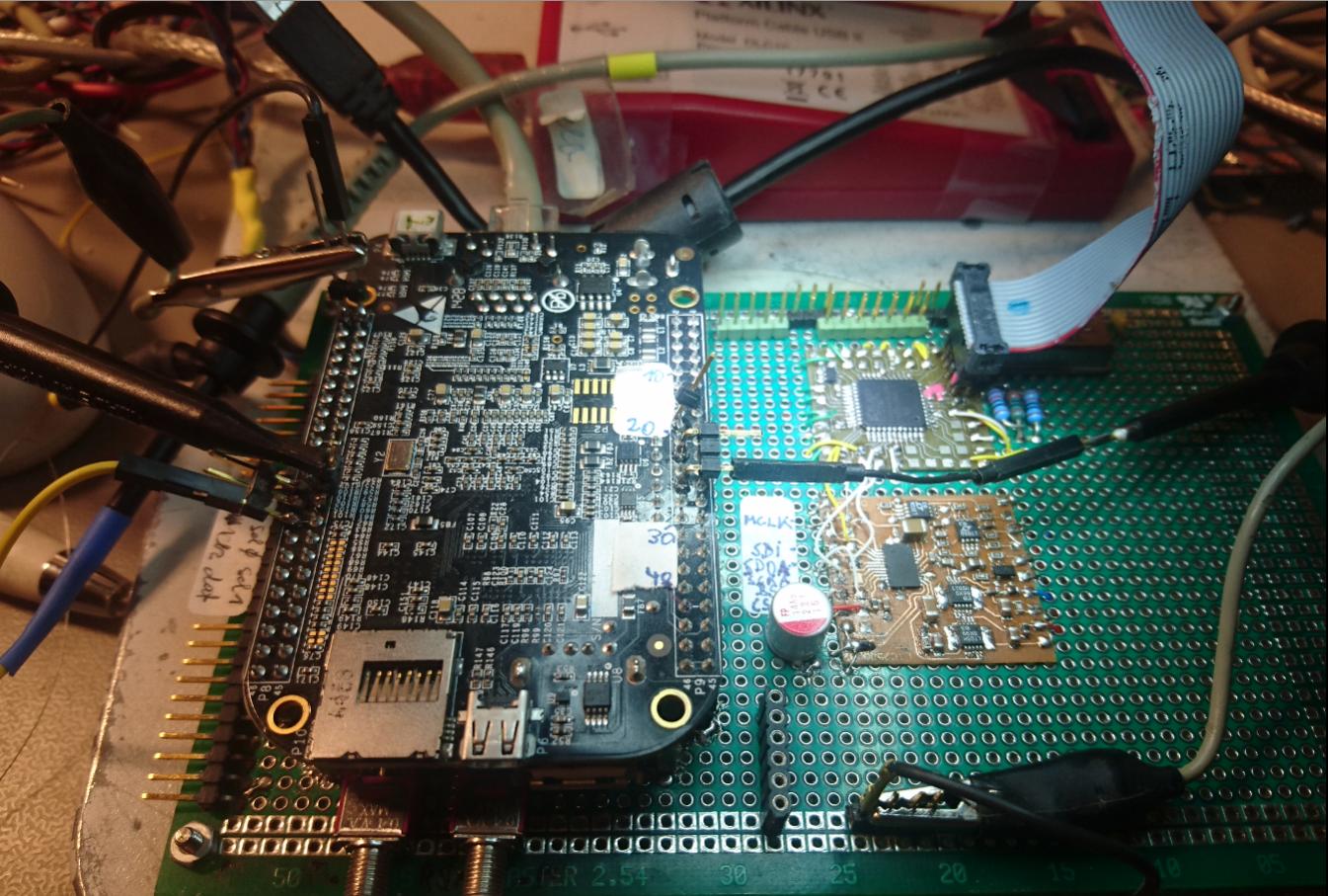

I'm just doing a similar ADC. Originally it was intended to be just a quickie
because my 89441A analyzer has such a bad 1/f noise.
Since I use BeagleBone Blacks for other things, the idea was to use its
48MBit/sec SPI interface to read out the ADC. I settled on the LTc2500-32.
The 2500 needs a 100 MHz SPI clock at full sample rate, so that gave the
oscillator frequency the 1 MHz sample rate was derived from. When a
conversion is started, the LTC2500 wants to be left alone for 650 nsec
for best analog performance, so the 32 bits have to be saved in 350 nsec
before the next conversion starts.
Since I'm interested in 1/f, I was willing to accept the limitations of the BBB's
48 MHz SPI. I lost a lot of time on that and could not get the SPI interface to
work under the BBB's Debian Linux.
I noted that the Xilinx Coolrunner CPLD that generates the sample clock had
just enough resources (64 flipflops total) to implement a 32 bit SPI receiver.
The BBB has a 1 GHz ARM CPU with hardware floating point and two additional
200 MHz RISC I/O processors called PRUs. The PRUs need 5 nsec/instruction
and don't use pipelining, so execution is highly time predictable, you can set
port bits with 5 nsec resolution. The I/O processors have nothing to do with the
Linux system if you want that, but there is a C compiler etc on the BBB that can
translate the PRU programs and load & start them. The 2 PRUs and the master
ARM CPU can talk together via a shared RAM.
Since the BBB tries to be everybody's darling, use of I/O pins is quite complicated;
a lot of the work is to sort out how to get rid of the graphics display and its drivers
that are installed by default. I found out that PRU1 can access an 8 bit field on
the P8/P9 plugs and some more single bits. So I decided to read in the SPI data
in 4 bytes for each sample.
Timing is fast enough that I could read out 3 ADCs at full speed, so I could
compute the 3-cornered hat. ( Cross correlation 1-2, 2-3, 3-1 so you can
attribute signal & noise to the 3 inputs.)
The PRU receives a data-ready signal from the CPLD and then fetches the
4 bytes and merges them to 32 bit samples again. The samples are deposited into
a 2*1Ksample ping-pong buffer. When 1Ksample is complete, the ARM fetches
it while the PRU fills the other buffer.
That also fixes easily the transition from the hardware buffer to the ARM's virtual
memory land where RAM is plenty. The ARM could then compute FFTs in its
NEON floating point unit, do averaging etc. It could also run a web server to
display the results, much like the STEMLAB in the Red Pitaya.
I already could install the fftw library. (fastest FFT in the west)
I decided for the first step to imitate the 89441A's remote control interface and
simply pass the data on via LAN. I can simply open port 5025 on 192.168.178.111
on my laptop and read/write GPIB/IEEE488/SCPI-like commands.
The ARM runs a server for that and it was not very hard to do. The network i/f
under Debian is maybe 3 pages of C, once one has understood the principle.
All software work can be done on the Linux system, the compilers, editors etc
are all included in the Debian distribution. You can simply ssh into it from your
laptop and have shell access.

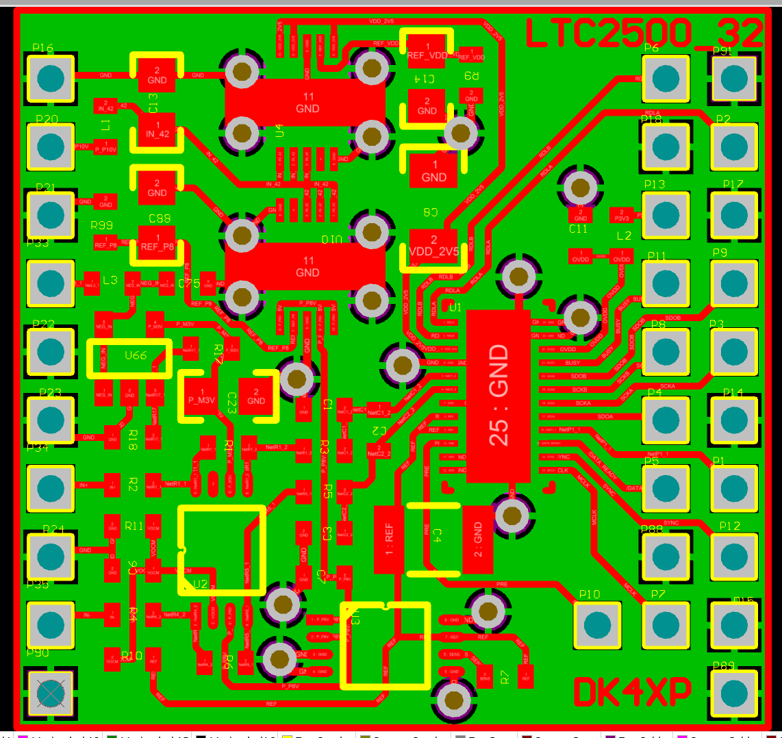

Hardware-wise there is not too much to it. There is a stamp-sized board that
is the home for the CPLD and another stamp for the LTC2500-32. The second
stamp has also 2 LT3042 for the analog voltages, a LT6655 reference and the
differential ADC driver as proposed in the 2500 data sheet. The is also a -3V
regulator for the ADC driver. I have not yet made up my mind what comes
in front of the ADC driver. I'm into measuring stuff and not into audio recording.
regards, Gerhard
regards, Gerhard
