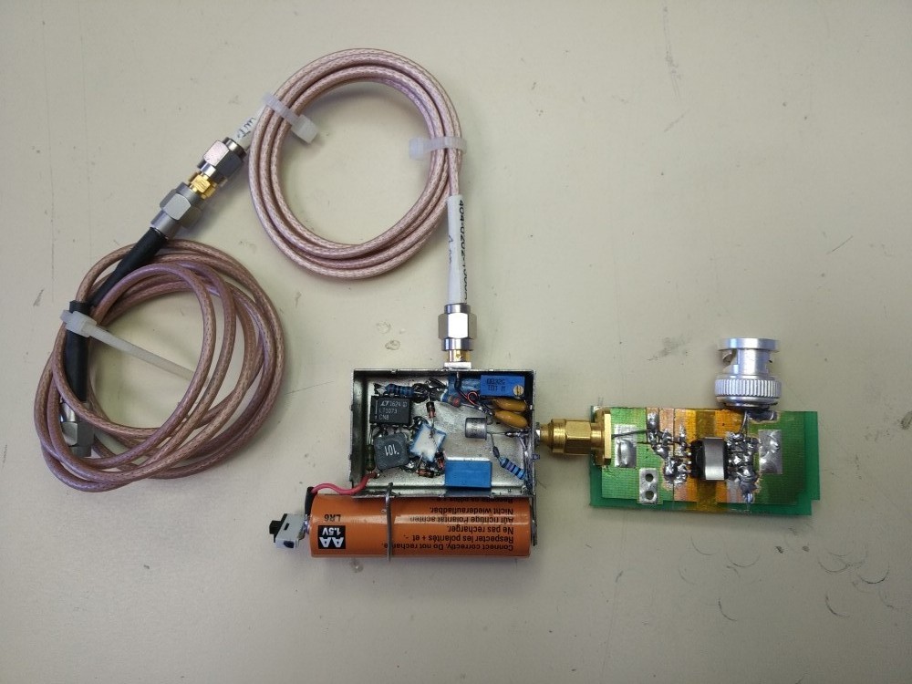

Hello,
I have received some transformers and i made some pulse response tests
using a DIY pulse generator with less than 100pS rise time and 20ns duration.
A picture of the pulse generator and the DUT test board.

For all tests, signal level is set to about 500mVpp at transformer input
with impedance adapted to 75 Ohms on each side (I made this choice to be same
as SPDIF audio link, but that could be 100 or 50 Ohms).

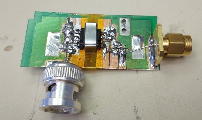

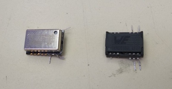

One picture of the two wurth LAN transformer and the SC947-02 mounted
on DUT PCB.

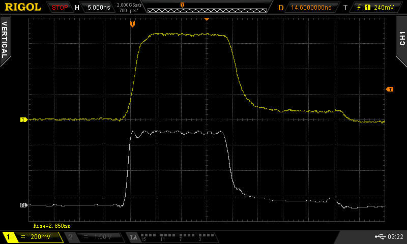

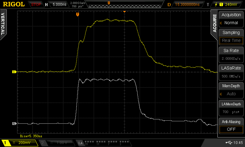

Now the pulse test results (gray trace is generator alone as reference) :
SC947-02
Wurth 749020100A
Wurth 749010310
These first results speak by themselves...
The last wurth LAN transformer work very well and output pulse rise time
look same as input and waveform is very clean.
We must note that this transformer is much cheaper than the SC947-02.

Würth 749010310 is the best.
Before you can "crown" one the best you need to fully define the application and then the requirements for the transformer.
SPDIF needs extended response, low return loss and good isolation. Moving a clock may work best with a narrow band tuned transformer. Without details on the application you can focus on the wrong aspects.
